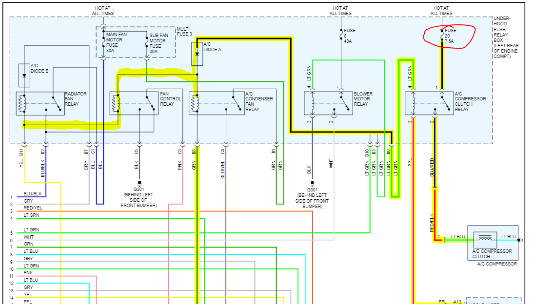

Have you checked fuse 20 in the under-hood fuse box? If not, confirm there is power to and from it.
Next, at the relay, one of the connector pins (either 30 or 87) should have power at all times. Check that. On the opposite side of the relay, pins 85 and 86, one will only have power with the engine running and the AC requested. Check that.
Let me know what you find. See pic below.
See pic below.
May 29, 2023 at 1:05 PM

If you are able to jump the secondary side of the relay and the compressor engages, the problem is on the primary side. Are you getting power and a ground reference there?

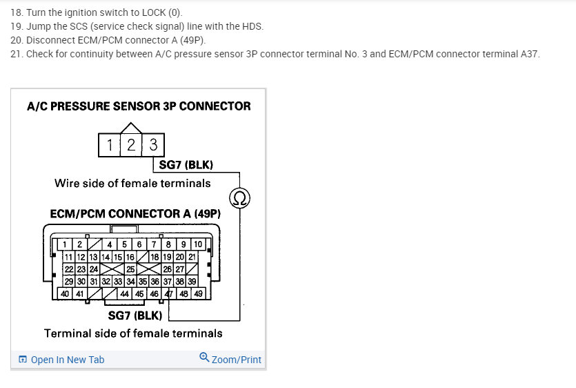

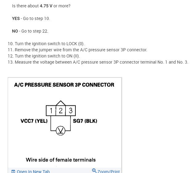

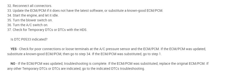

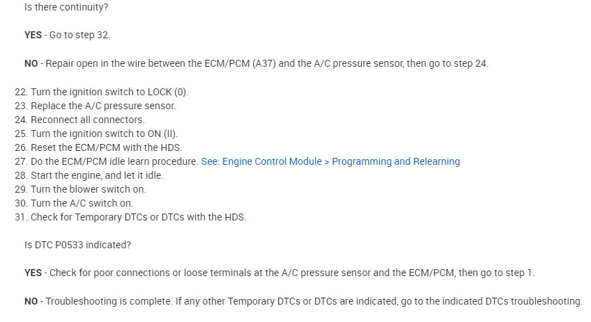

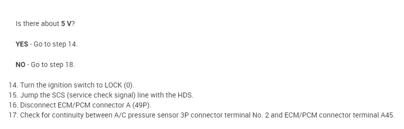

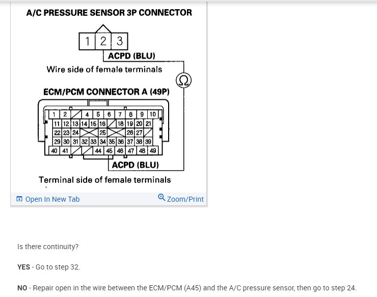

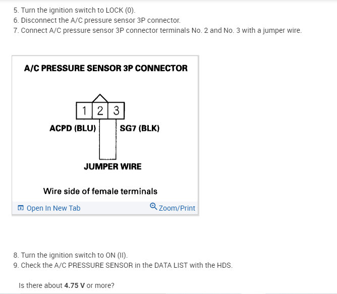

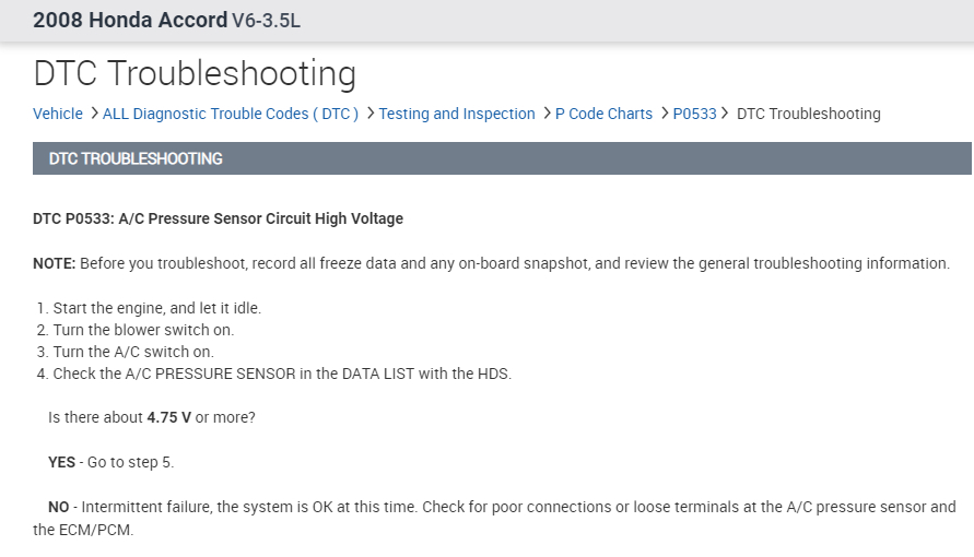

Okay, so, A/C system is new but can't get past po533. I think problem in on primary side but don't know what else to check.
Jun 2, 2023 at 8:32 PM
  • 110,240 POSTS
I agree, but the P0533 may be preventing the relay from actuating. I attached the diagnostics below specific to the code. Take a look through them and let me know if you are comfortable performing them.
