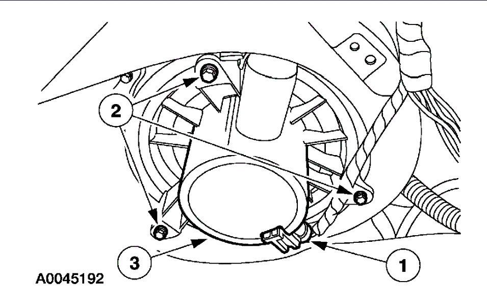

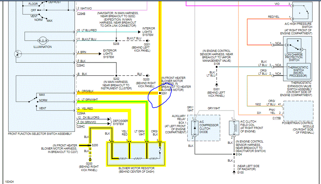

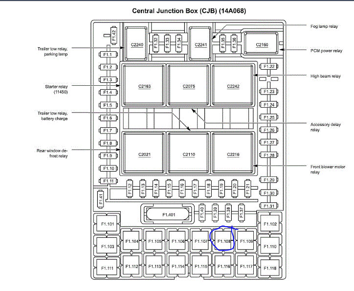

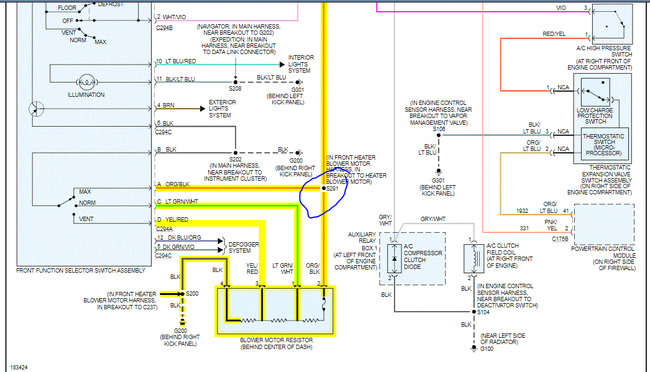

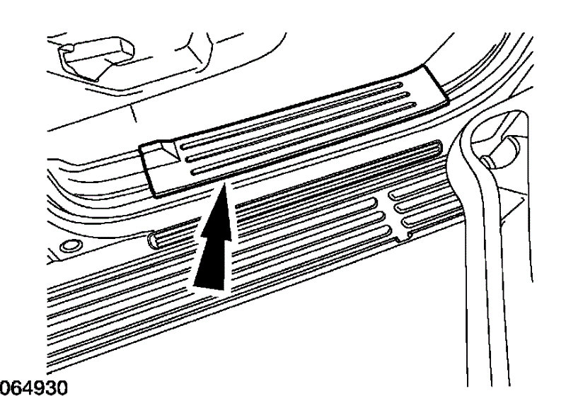

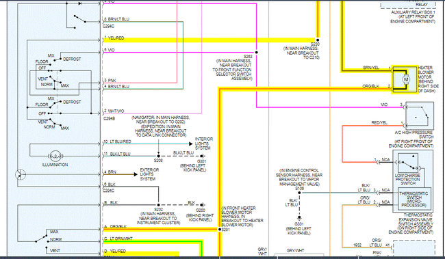

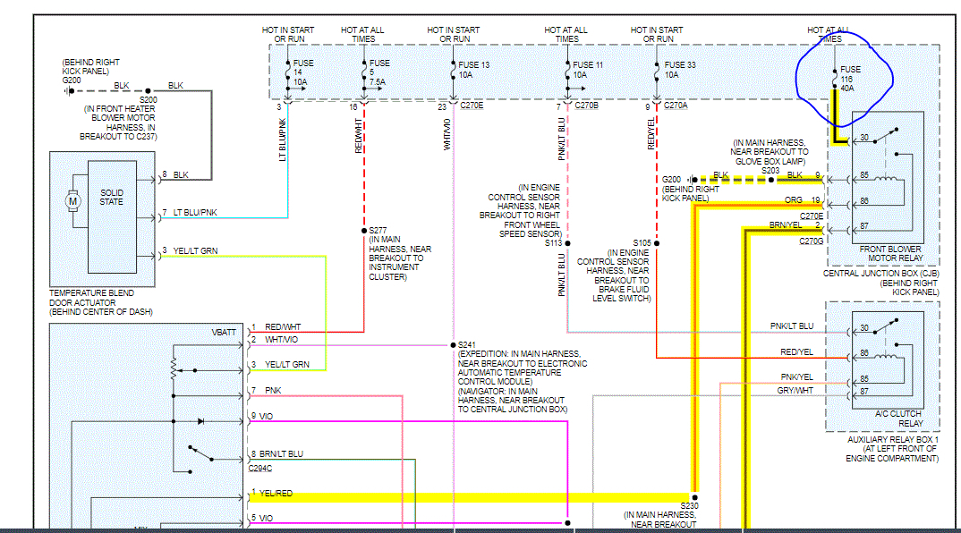

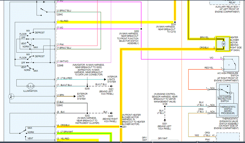

I attached the location for you of the blower motor. We will need to do some voltage checks to determine the failure.
Do you have a test light or voltmeter to do some checks? It could be the motor or the resistor.

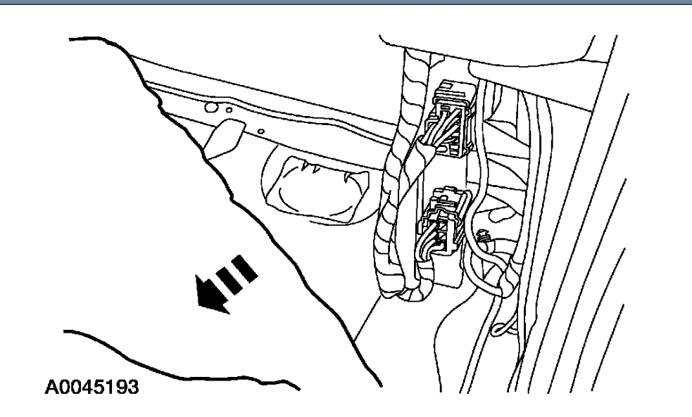

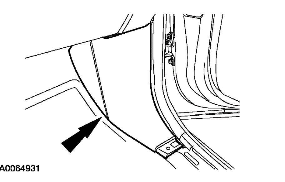

3. Remove the RH scuff plate.
4. Remove the RH lower A-pillar trim panel.
All vehicles
5. Position the carpet aside.
6. Remove the blower motor.
1 Disconnect the electrical connector and position the wire harness aside.
2 Remove the screws.
3 Remove the blower motor.

it may be the blower motor that is not working, but, the lines that are on top of engine and seen once hood is open are freezing with the start of the vehicle and the control center/panel is also not working at all.
Aug 3, 2020 at 5:05 AM
Okay, the lines are icing up from the blower motor not working. If there is no air flow across the evaporator, the lines will freeze.
Let me know when you want to do some voltage checks.
