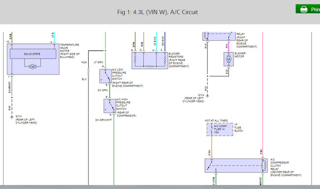

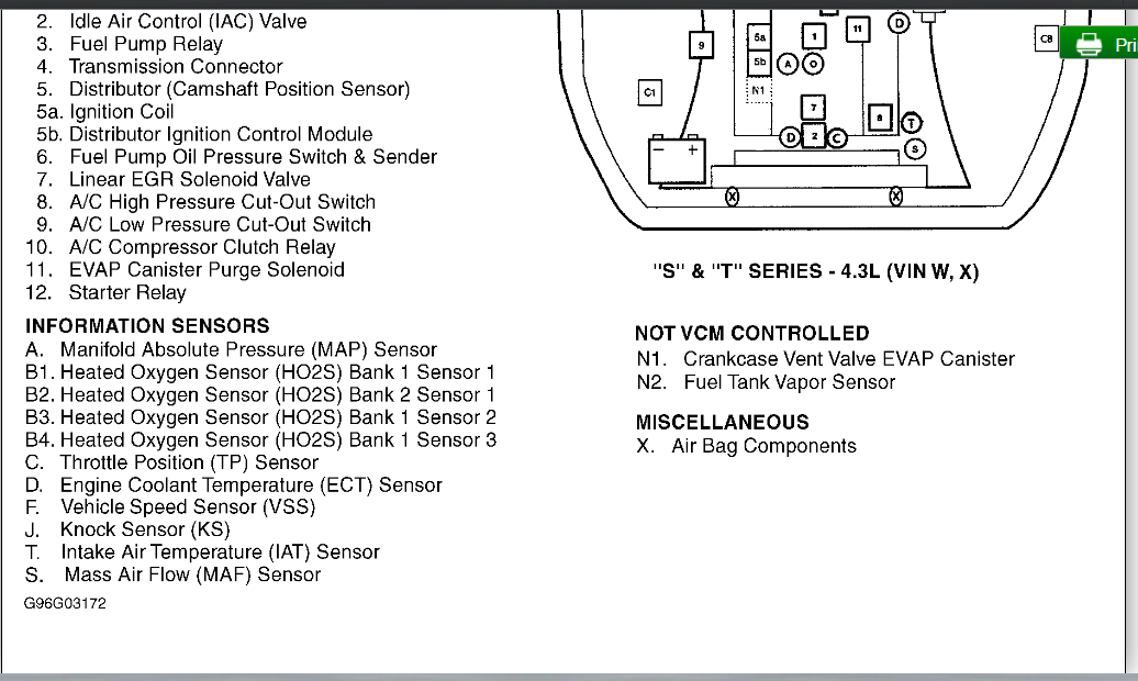

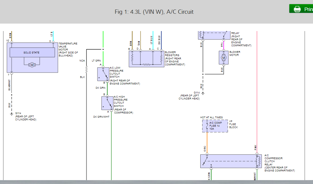

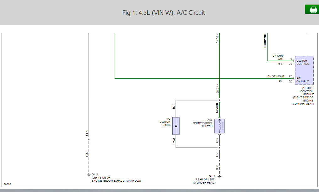

where is the relay for the A/C? there is a line of four on the cowl under the hood. I have been told, it is the one on the passenger side. true?
Apr 9, 2019 at 5:10 AM
SCGRANTURISMO
  • 4,897 POSTS
I have included a diagram for you of requested information in the diagrams down below. Please don't hesitate to ask should you have any other automotive questions. That is what we are here for.

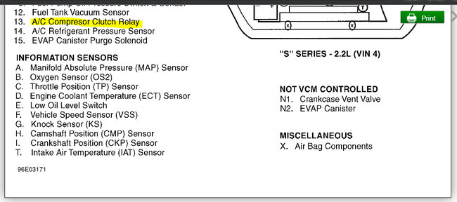

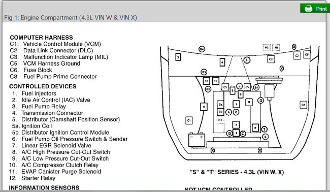

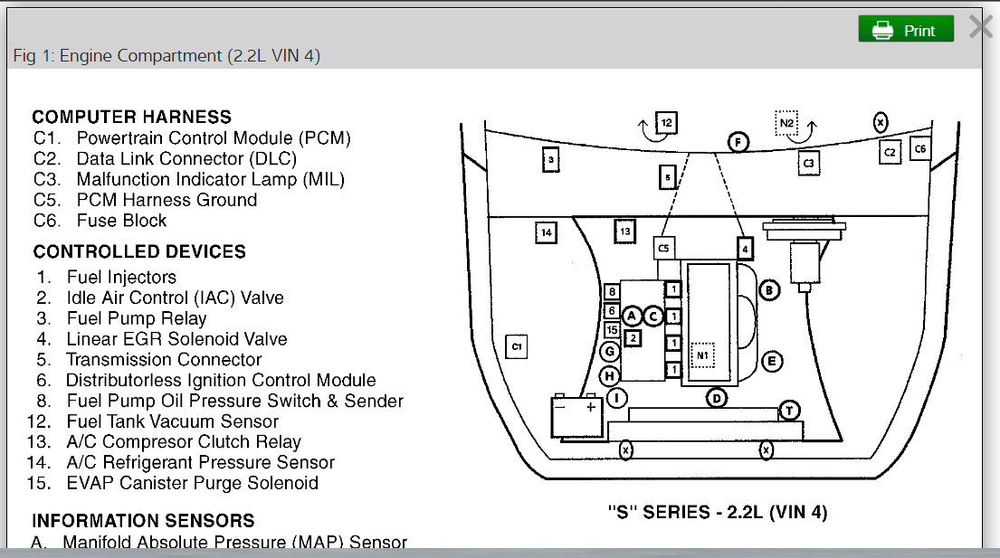

there are four relays in a row on the cowl. not shown in the diagram.they are right next to each other. can't find in the book.
Apr 9, 2019 at 1:28 PM
SCGRANTURISMO
  • 4,897 POSTS
Hello again,
What size engine is your vehicle? Is it 2WD or 4WD? Is it an Automatic or a Standard Transmission?
Thanks,
Alex
2CarPros
Apr 9, 2019 at 2:27 PM
DOCODOCO
  • 5 POSTS
v6 2wd automatic transmission.
Apr 9, 2019 at 2:35 PM
SCGRANTURISMO
  • 4,897 POSTS

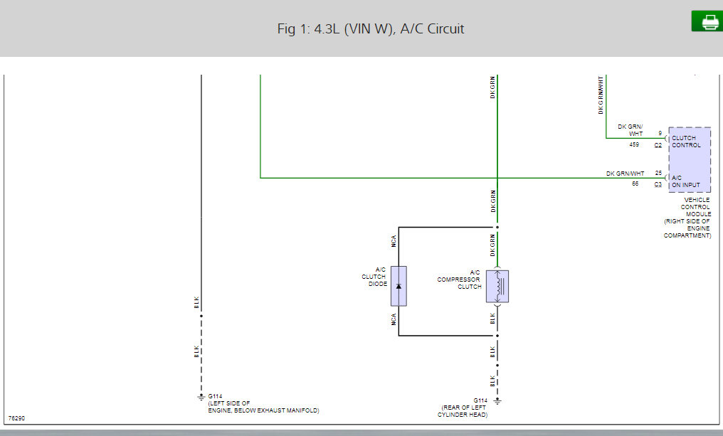

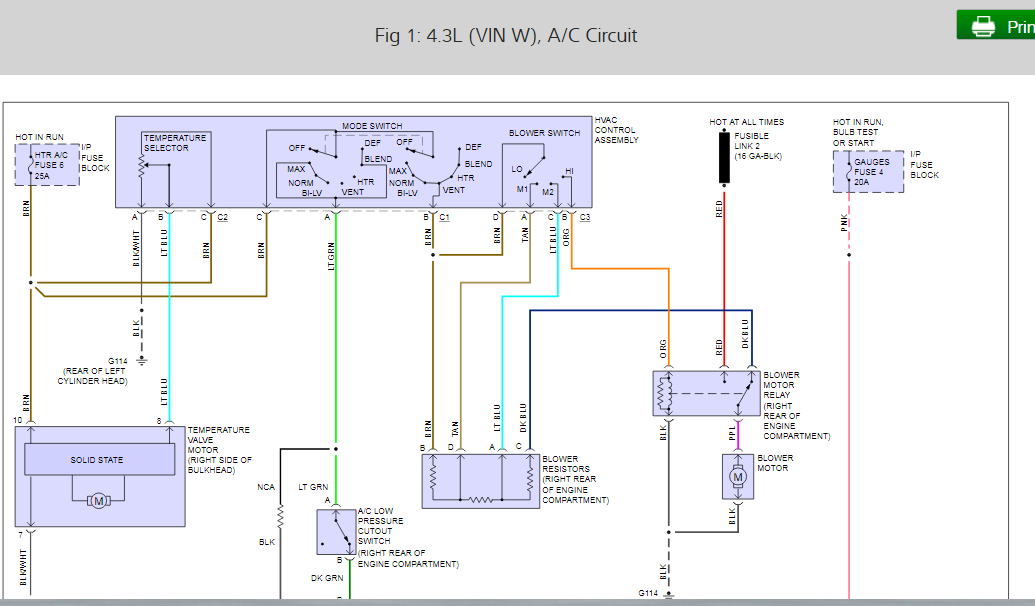

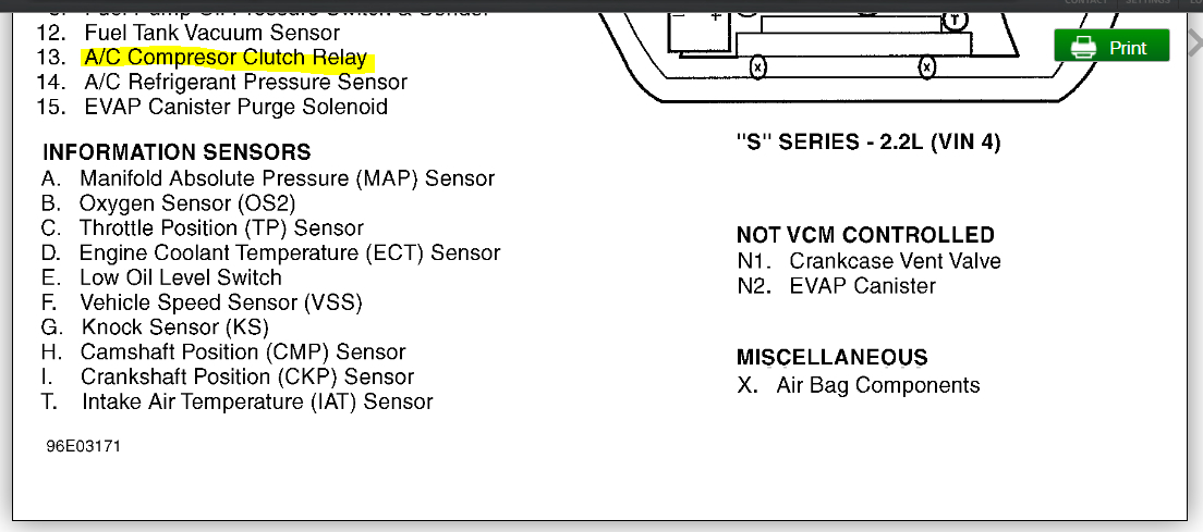

Hello again,
Here is the information that you requested in the diagrams down below. Please get back to us and let us know how everything turns out please. And, if you have any other vehicle related questions, please, do not hesitate to ask. That's what we are here for.
