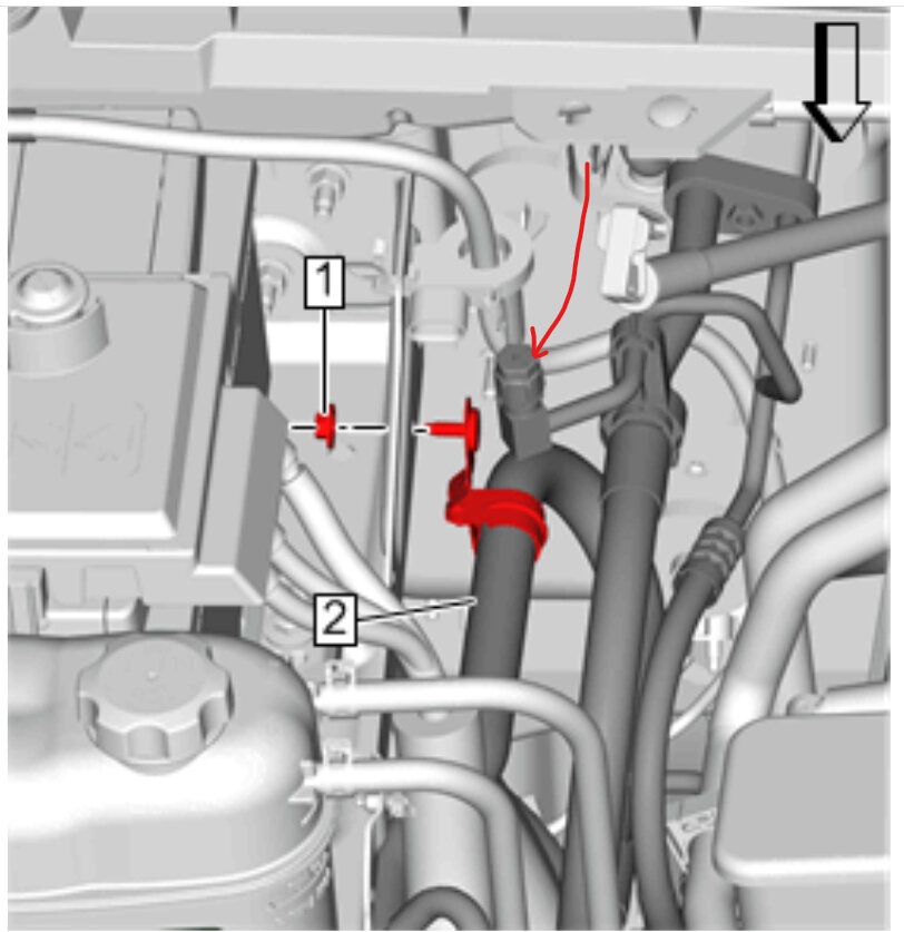

Can't find the low side on my vehicle listed above to charge my A/C.

I can help you, here is a video that will show you how to find the low side charge port:
https://www.youtube.com/watch?v=ON2dYcmXIAw
Here is the location of the port in the images below which is near the firewall on the passenger's side of the car. Check out the images (below). Let us know if you need anything else.
