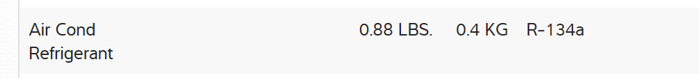

I just did a complete AC overhaul. How much Freon do I add?

.88 lbs of R134A. See picture make sure that there is oil in system as well if completely overhauled 3.5 oz of pag 46 for compressor and .7 for condenser.
