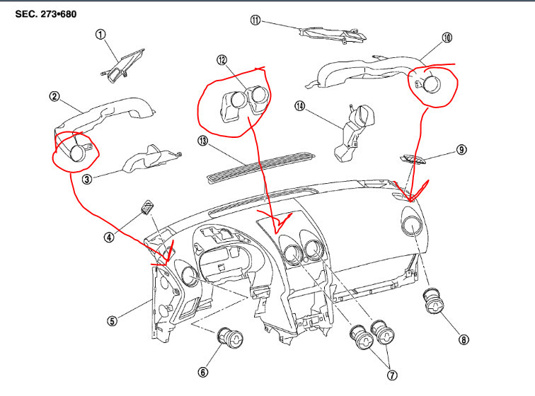

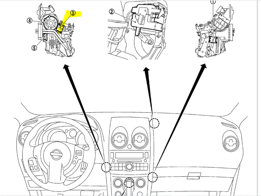

I replaced the blower motor and the blow motor resistor, and my air conditioning started working, but my middle vents don’t blow air whatsoever and it blows air on floor of the passenger side no matter what mode it is in. The side vents work fine and the one on the driver's side.

It sounds like something happened to the mode door actuator or the ductwork. When you replaced the motor, did everything go back together properly?

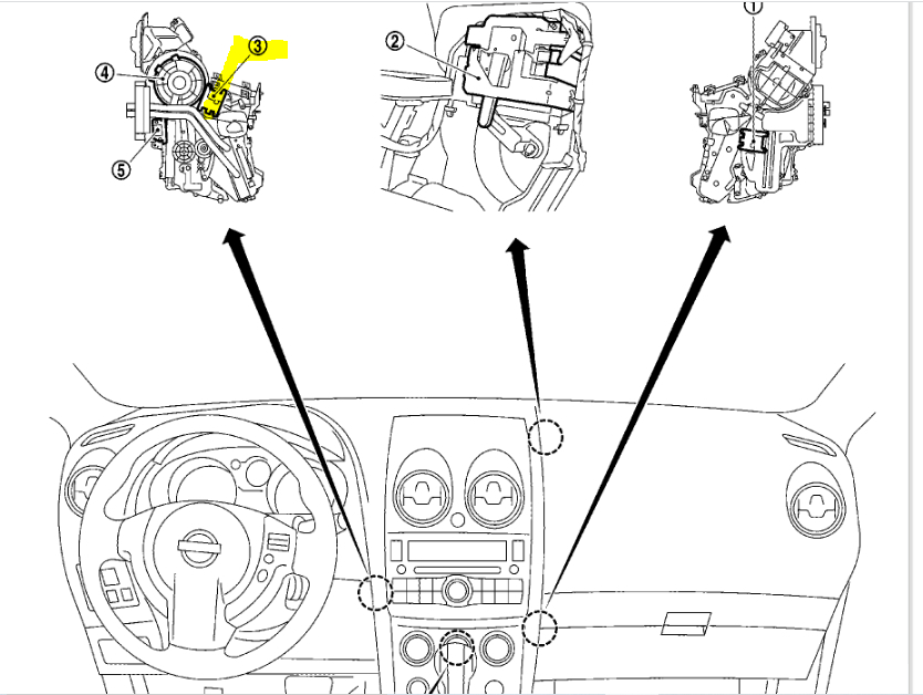

If you look below, I attached a pic of the mode door actuator and location. Did you take anything apart in that area?
Also, I included an exploded view of the duct work and circled the ones for the vents. Check to make sure nothing has come apart.
Let me know what you find.
