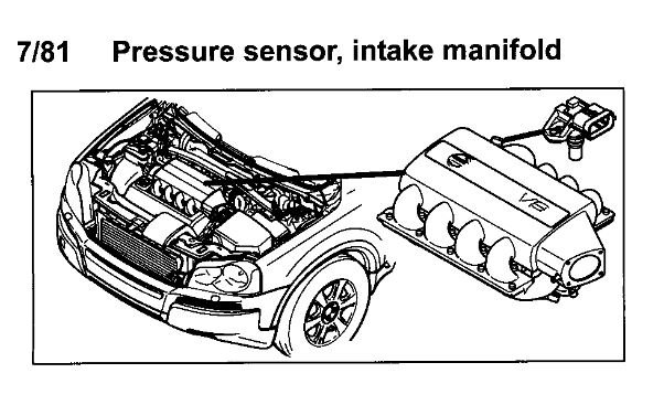

Cannot find location of MAP sensor (not MAF).
Sep 2, 2018 at 9:08 AM
AL514
  • 5,587 POSTS
Hello, thanks for using 2CarPros.com. Here is a diagram of the MAP location, hope this helps.

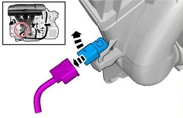

Check engine light always on, five codes for MAP sensor. The only sensor I see that resembles my replacement is down just slightly left of middle of engine in a tight space. I can unplug it but cannot remove it as I am afraid I will break it. It has no screws holding it and neither does my replacement part. Possibly a clip holding it in?
Sep 3, 2018 at 7:04 AM (Merged)
  • 110,194 POSTS

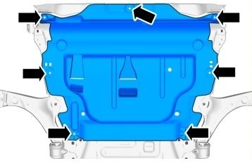

The component is not held in with a bolt. Rather, you need to turn it 1/4 turn to remove it. I have attached two pictures for you to follow for the procedure. Believe it or not, there are no written directions, only the pictures.
