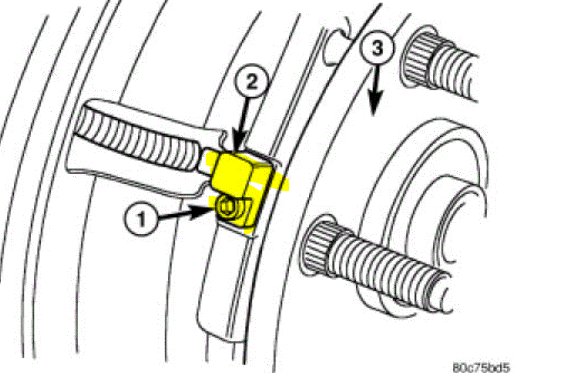

ABS and Traction light.
Jan 28, 2022 at 7:53 AM
  • 110,241 POSTS
First, make sure the brake fluid is full. If it's low, it can cause this to happen.
The most common cause of these lights being on is a faulty wheel speed sensor. We have two things that can be done to determine where the issue is coming from. The first is to use a scan tool that can read the can-bus system. CAN stands for controller area network. Basically, all the modules are tied together via a few wires. This type of scan tool can retrieve codes regardless of the module storing them.
Here is a link showing how it's done:
Another thing you can do is check each of the wheel speed sensors for a signal. All this requires is a voltmeter or multimeter.
Here is a link that explains how it's done:
https://www.2carpros.com/articles/abs-wheel-speed-sensor-test

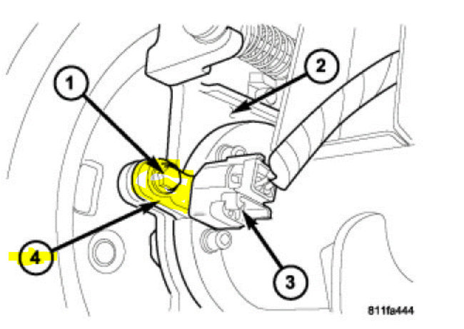

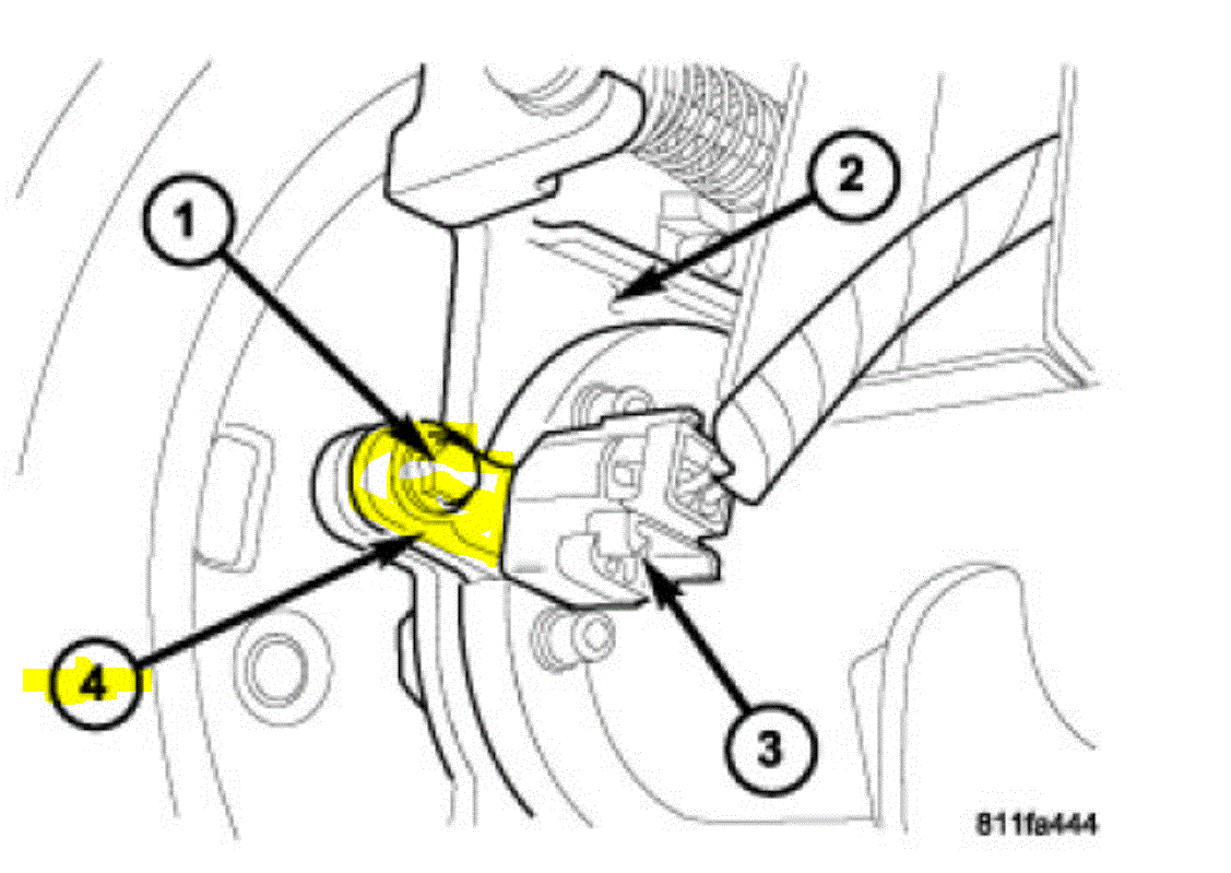

Your vehicle has a sensor at each wheel. I attached two pics showing their locations below.
Pic 1 shows the front and pic 2 is the rear.
