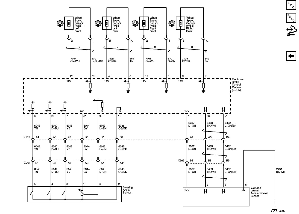

Do you have to replace the wheel bearing hub and the wheel speed sensor together?
2011 CHEVROLET AVALANCHE
115,500 MILES • 5.2L • 4WD • AUTOMATIC
MJ56
MEMBER
1 POST
Or can you just replace the wheel speed sensor?
Nov 19, 2022 at 9:44 PM
STEVE W.
Experienced Mechanic
15,381 POSTS
If the hub is in good shape and not making noise you can replace just the speed sensor, however if you live in an area where they salt the roads you may have a very difficult time removing the sensor without breaking it. Also, GM had an issue for a while with the harness between the ABS sensor and the brake control module failing which mimics a bad sensor.
