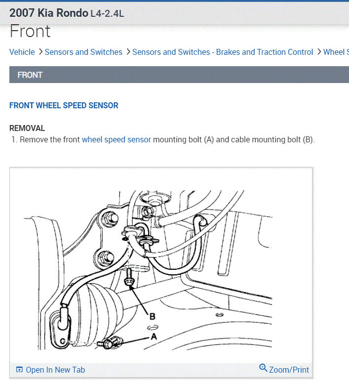

where does the right front ABS sensor wire connect?
2007 KIA RONDO
79,000 MILES • 4.2L • 4 CYL • 2WD • AUTOMATIC
BERNIE 241
  • 5 POSTS
ABS wheel sensor.
Dec 4, 2021 at 12:03 PM
SQM
  • 6,383 POSTS

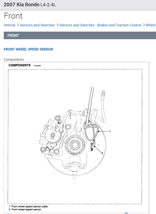

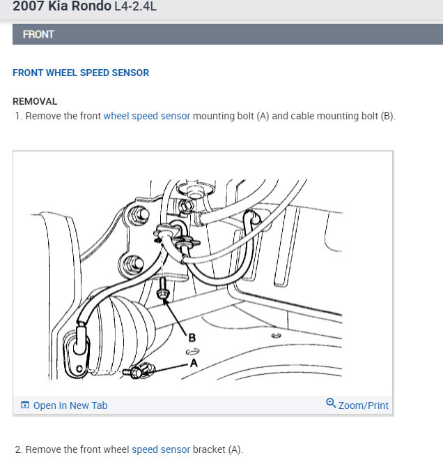

The ABS sensor plugs into the hub behind the rotor.
It is mounted by one bolt.
https://www.2carpros.com/articles/how-to-replace-an-abs-wheel-speed-sensor
I have attached diagrams below.

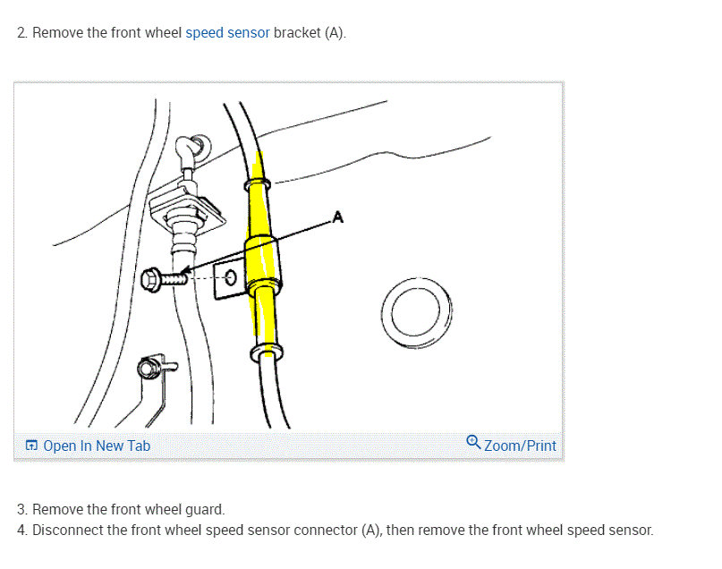

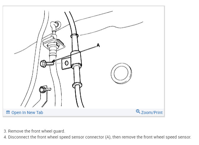

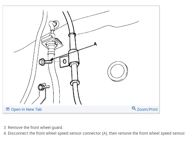

Dec 6, 2021 at 7:36 AM
  • 110,194 POSTS
I don't know if you found the connector yet, but it is behind the inner fender/splash guard.
I attached directions below and highlighted the connection.
Let us know if this helps.
