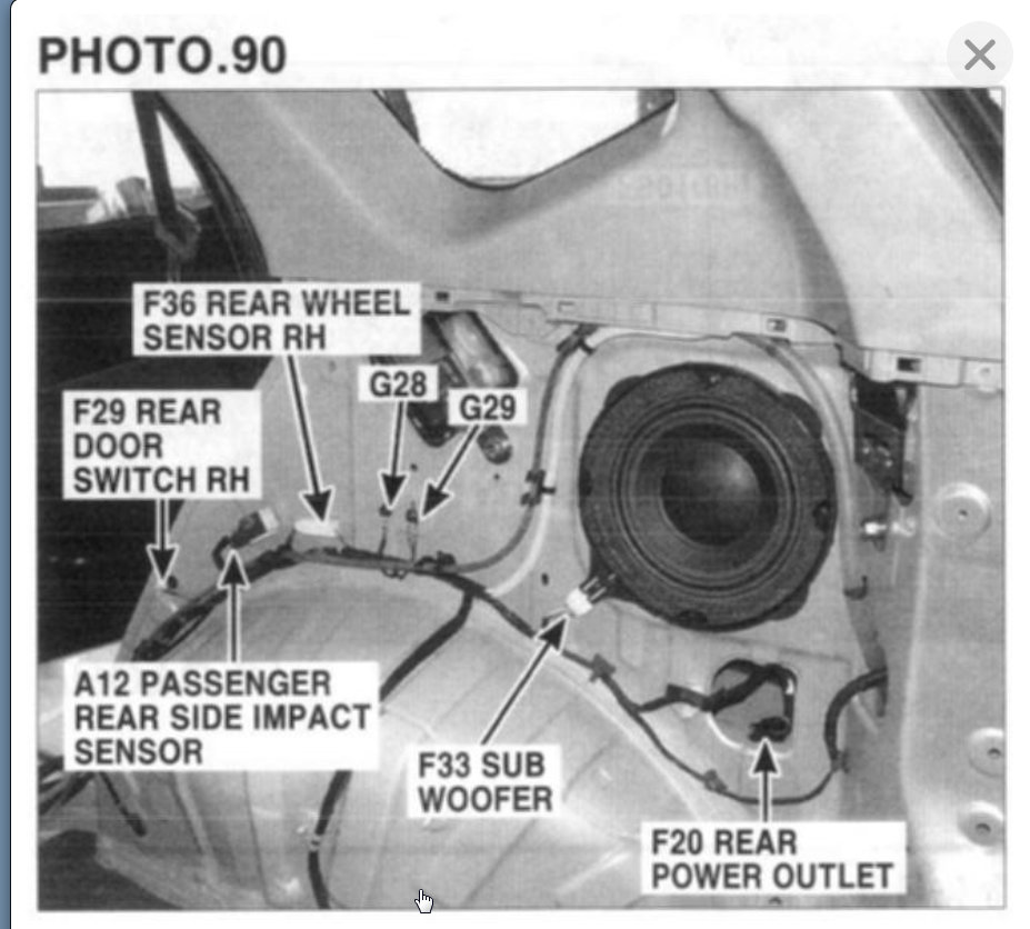

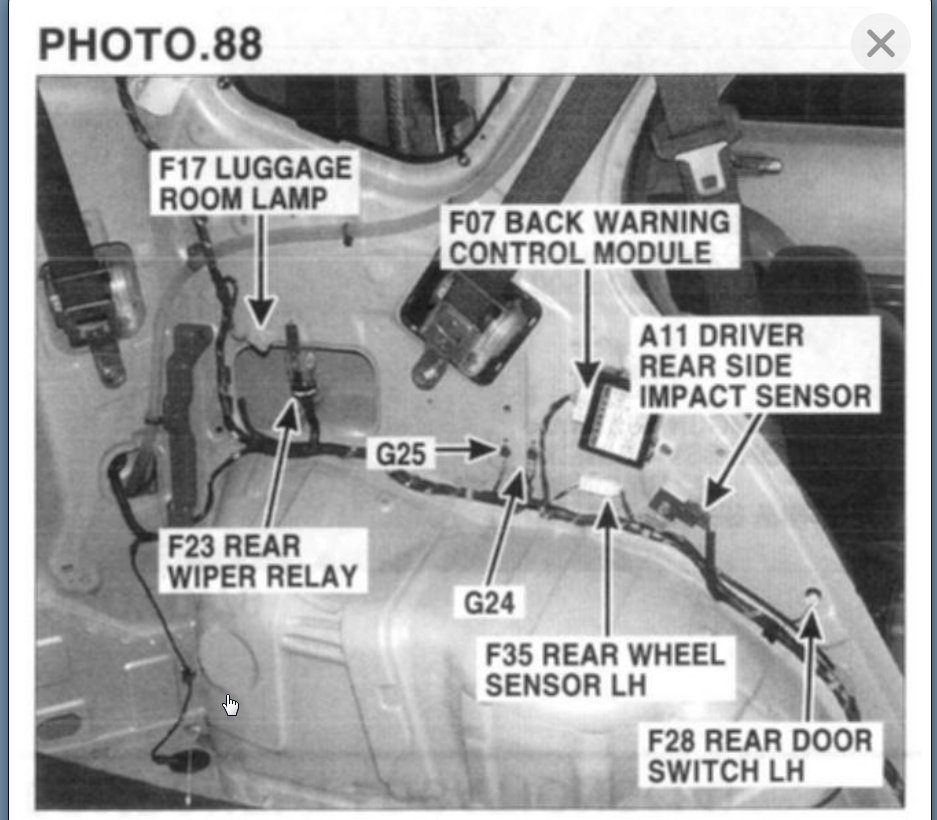

where does the right rear sensor wiring connect?
Jan 12, 2021 at 7:24 AM

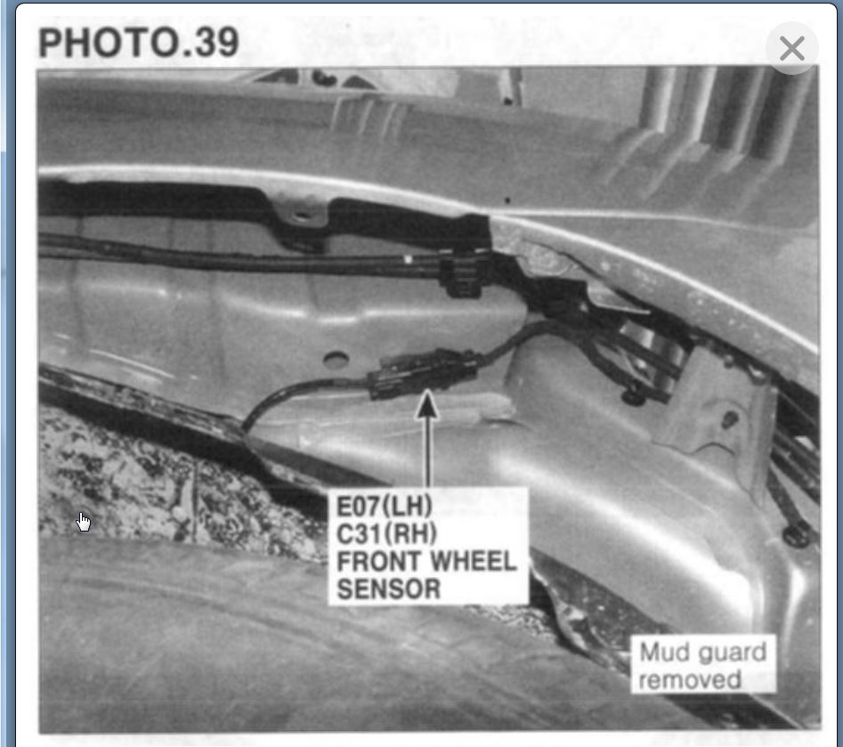

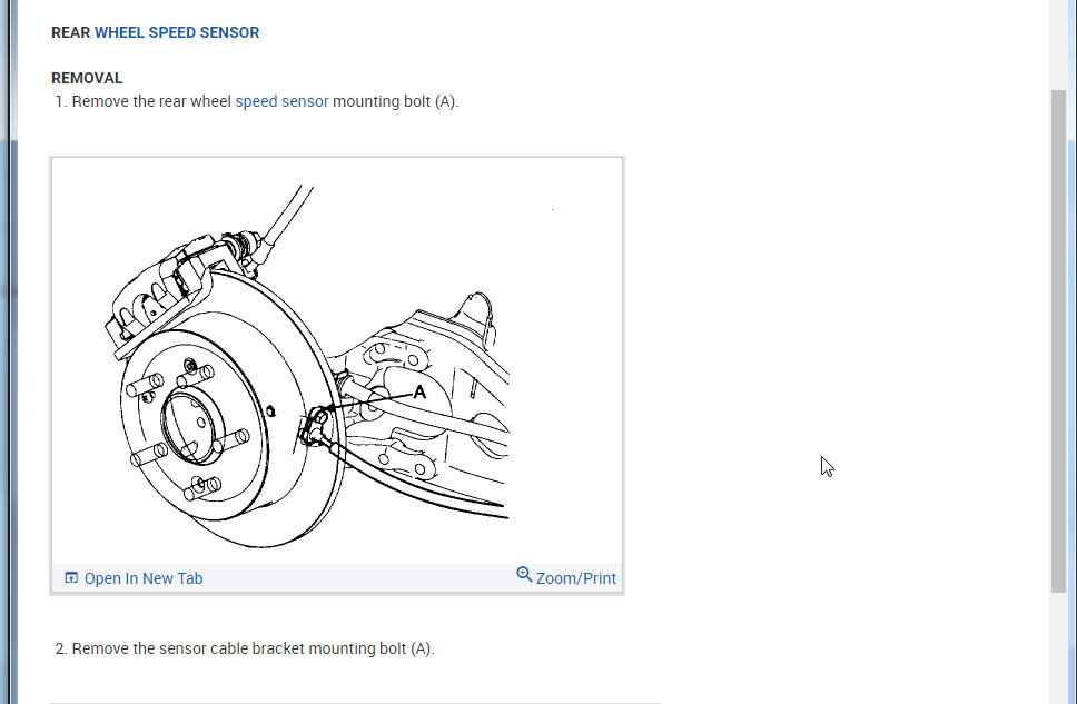

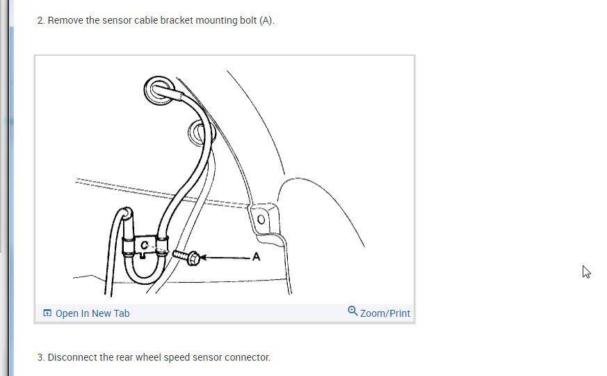

I am attaching the info on this sensor and all the location views for each sensor in case you need that as well.
Also, here is a video that others that visit this page my benefit from on how to test these sensors:
https://youtu.be/jG18XmUJoNU
Please review this material and let me know if you have other questions. Thanks
