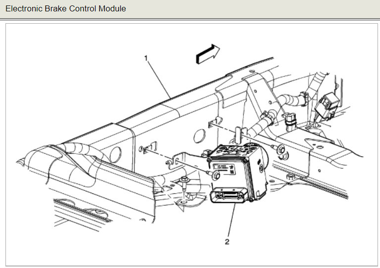

My ABS/VSES have been troubling me a lot these days. while driving above eighty kmph the stability light starts blinking and there is no power loss, upon reduce speed below sixty kmph it will stop blinking. there is no code showing up upon scanning.
Sometimes when i drive like a maniac the service stability and stability light will come on and stay until i shut down my car. This issue was scanned with code C0287 and on next start it will not come up.
please help me with this and sorry for my poor English.

Symptom indicates a possible fault with the ABS module.It could be wiring or the module itself is at fault.
Unplug the ABS control module wire connector and check for looseness and contamination to the pins. Clean and reconnect to retest. Check for bad or poor grounds.

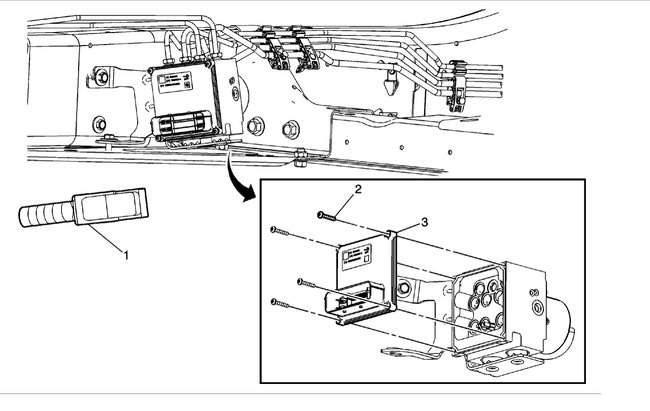

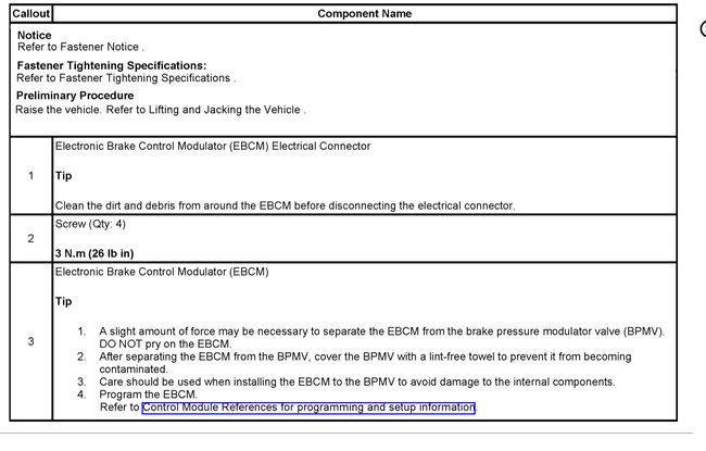

  • 55,721 POSTS
To me it sounds like the the ABS module has gone out. Here is a guide to show you what you are in for when changing the unit out.
https://www.2carpros.com/articles/how-to-replace-a-abs-controller
Here is how it will be on your car (below)
