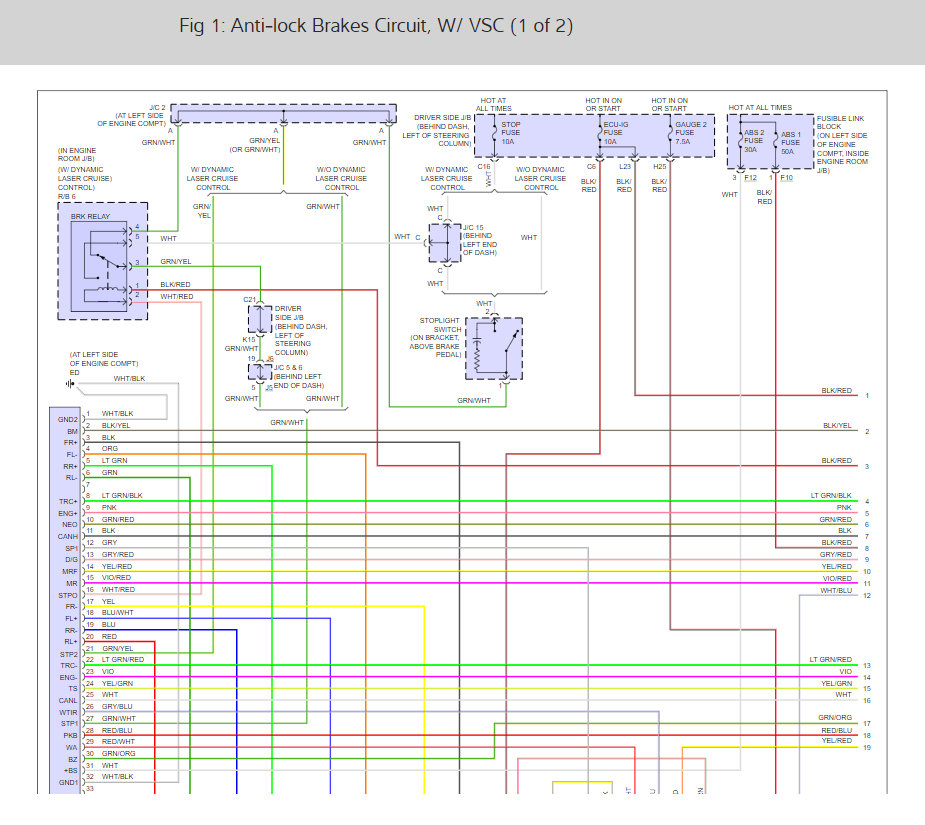

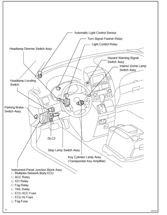

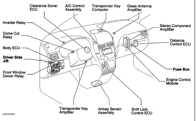

Can I ask if the brake lights are working? The codes are pointing to the brake light switch being out. here is the location so you can check it out. Check out the diagrams (below). Please let us know what you find.
Feb 4, 2019 at 2:25 AM
EGOPHER
  • 5 POSTS
Hi Ken,
The rear brake lights are not working.
The white reverse light and rear turn signal indicators do work.
Feb 5, 2019 at 9:09 AM
  • 55,588 POSTS

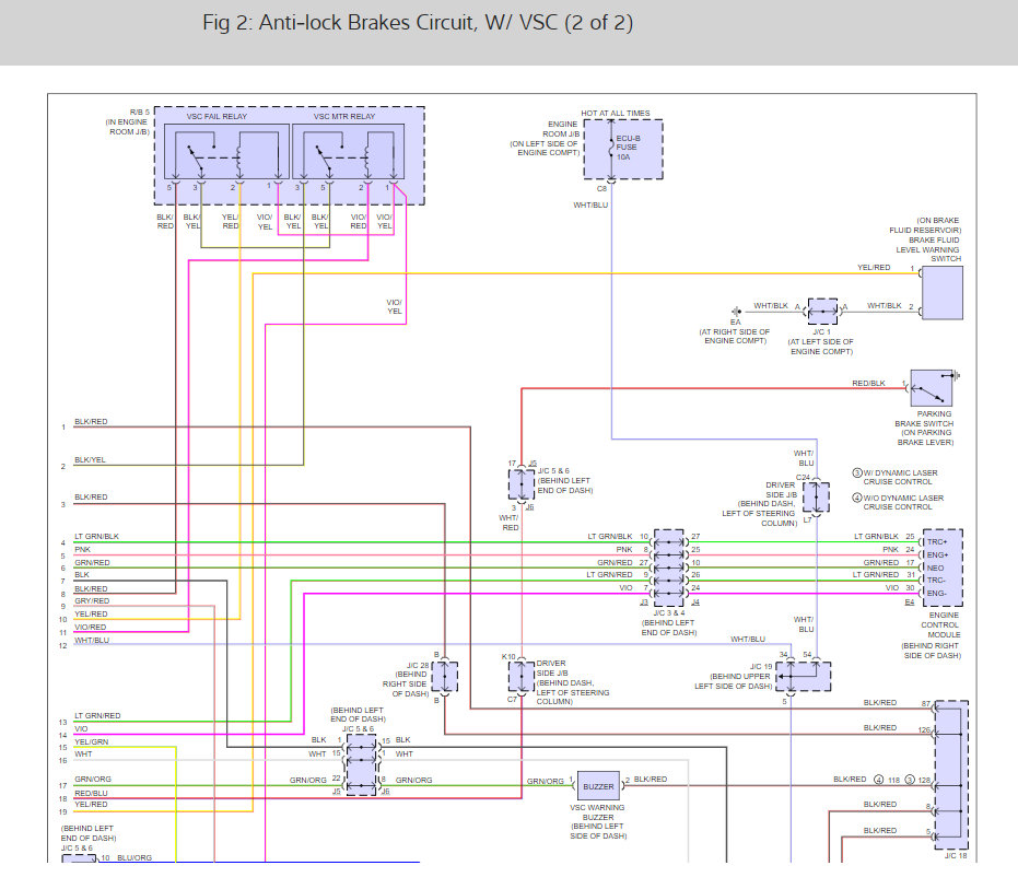

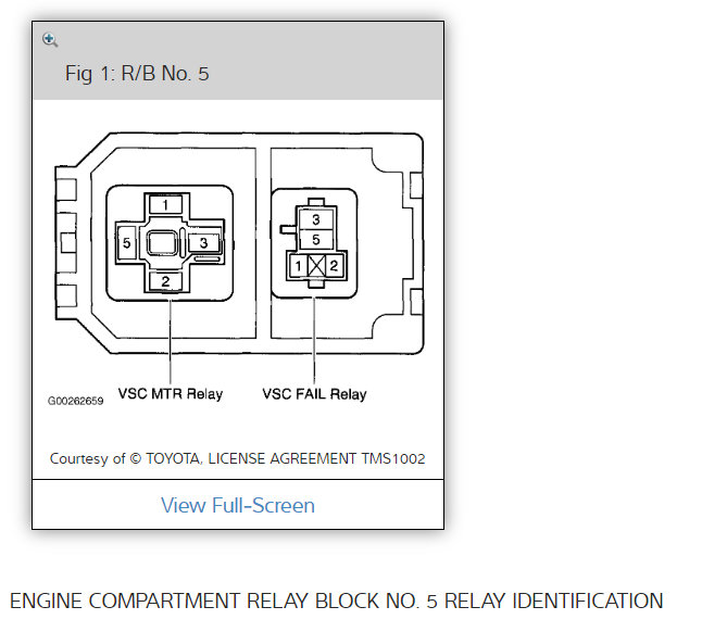

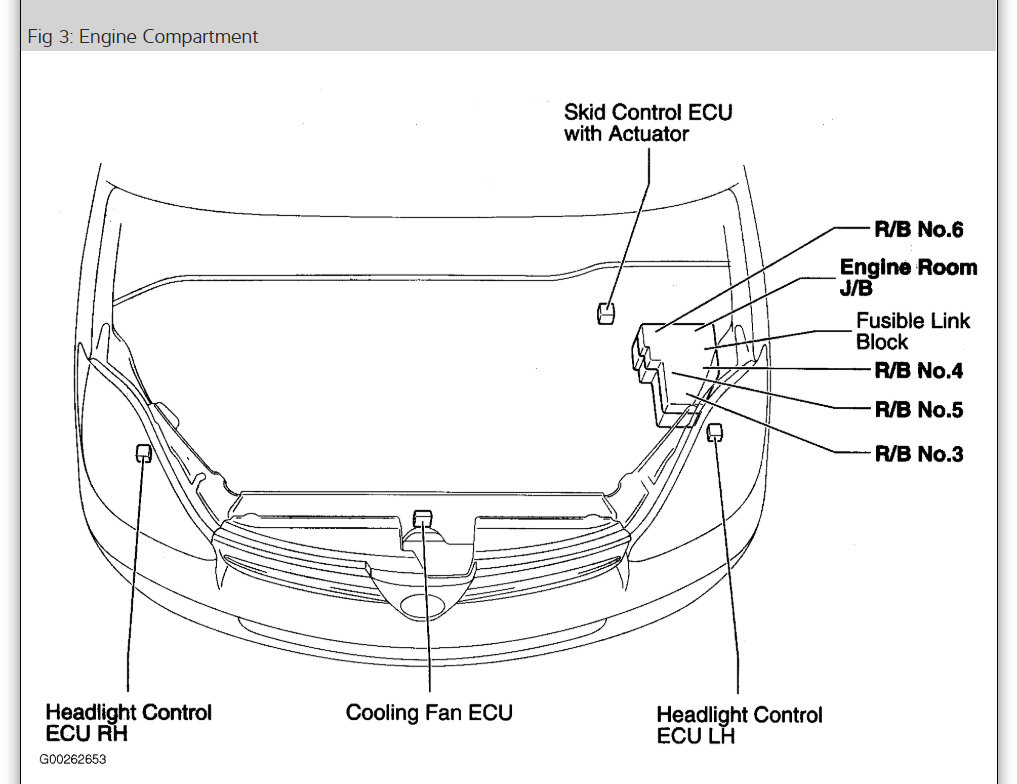

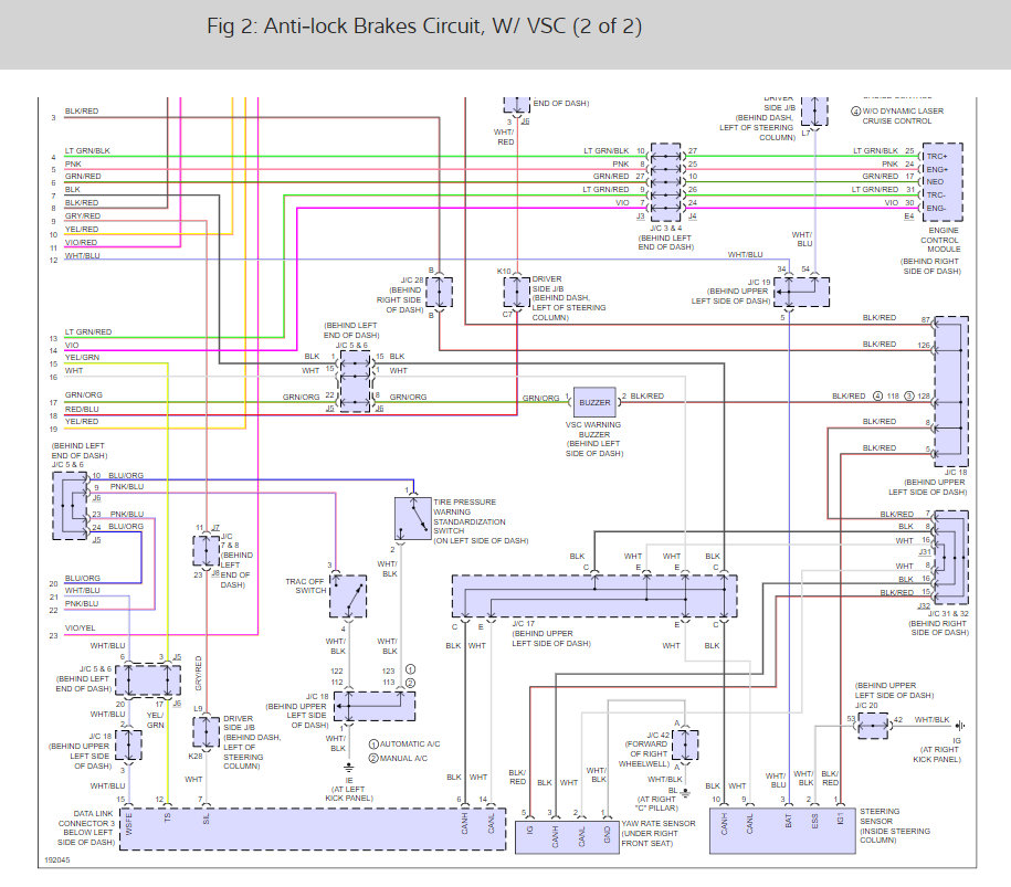

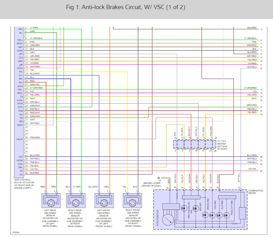

Good work, there are to relays that need to be checked (VSC fail, VSC motor). here is a guide to help you check them and the relay locations along with the ABS wiring diagrams so you can see how the system works:
Feb 6, 2019 at 4:06 AM
