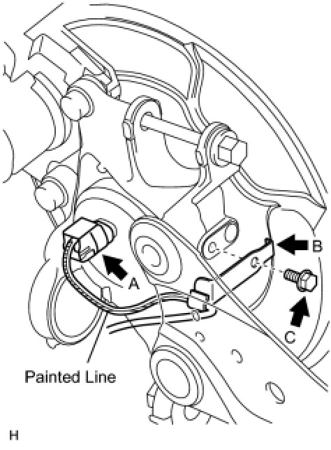

Bought this vehicle three weeks ago. My ABS light is on, tire pressure gauge is on,(checked psi, tires holding consistent pressure) and my traction control light is on and will not turn off when clicking the button. I have tried to reset my battery and still nothing works. Does anybody have any idea on what I should do next? I have read a couple things that it may be a speed sensor or even just a wheel sensor. Thank you in advance.

First, it isn't uncommon for the tire pressure monitors to fail. They each have a separate battery that usually lasts about 5 years. However, make sure the pressure is at what is listed inside the driver's door on the tire information label. The only way to confirm that is with a TPMS scanner which can tell you if there is a signal from the sensor.
Next, I feel somewhat confident the ABS and Traction control lights which are both on have something to do with a bad wheel speed sensor. The ABS and TC are tied together. If one fails, the other will. With that in mind, I suggest testing the wheel speed sensors. Here is a link that shows how it is done. Other than this type of test, you will need a live data scanner that can read ABS codes:

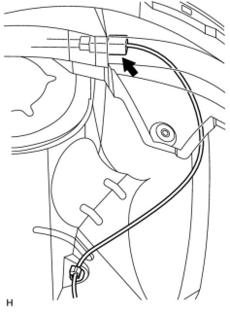

4. REMOVE FRONT SPEED SENSOR LH
(a)Disconnect the sensor connector.
picture 1

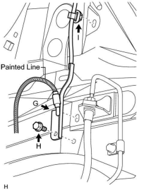

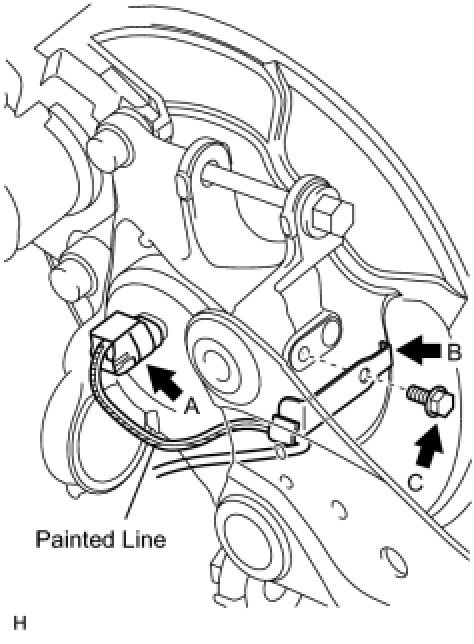

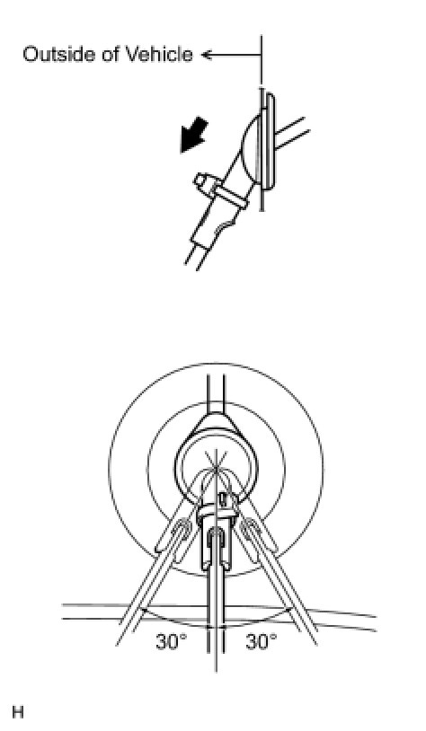

(b)Remove the sensor clip (labeled A), bolt (labeled B) and sensor clamp (labeled C).
picture 2

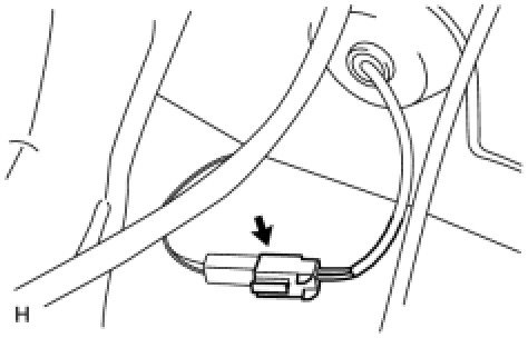

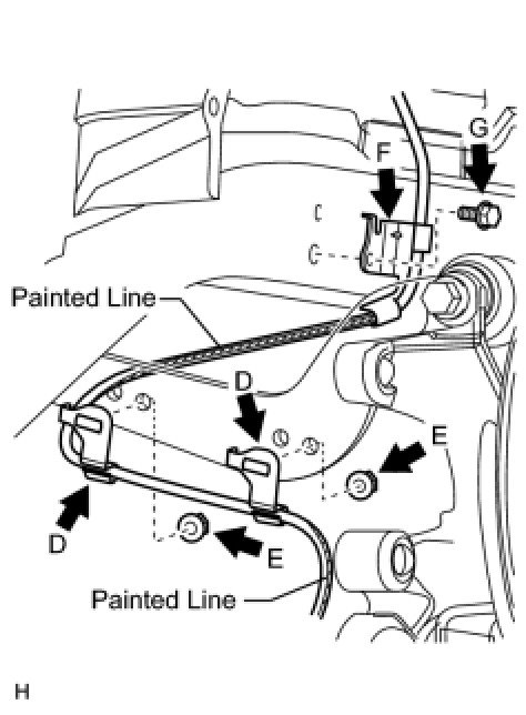

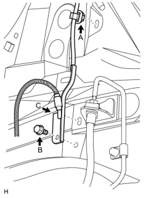

(c)Remove the sensor clip (labeled D), bolt (labeled E) and sensor clamp (labeled F).
picture 3

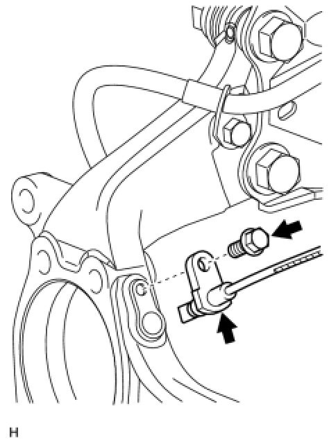

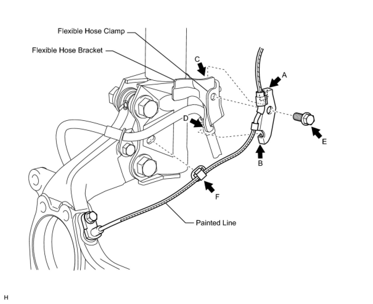

(d)Remove the bolt and sensor body from the knuckle.
picture 4

(1)Set the sensor clamp (labeled G) on the side member, and then install the bolt (labeled H).
Torque : 8.5 Nm (87 kgf-cm, 75 in-lbf)

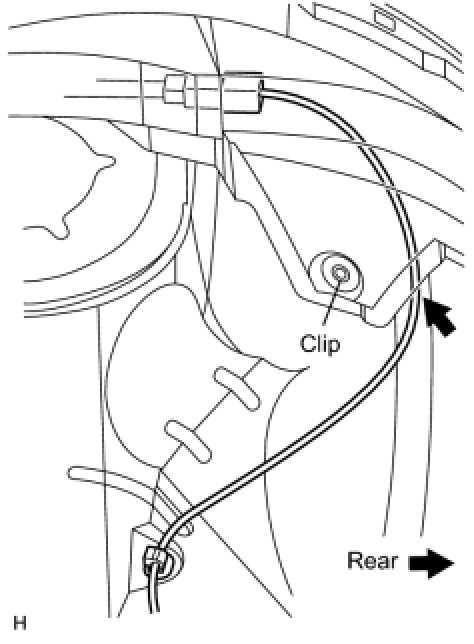

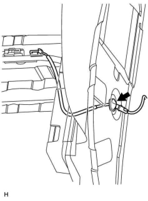

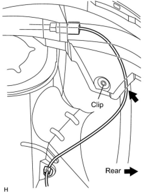

(2)Insert the sensor clip (labeled I) into the hole on the apron.
(d)Connect the sensor connector.
picture 8
2. INSTALL FRONT FENDER LINER LH
picture 9
HINT
Install the fender liner so that the sensor wire harness passes beyond the fender liner installation clip towards the rear side of the vehicle.

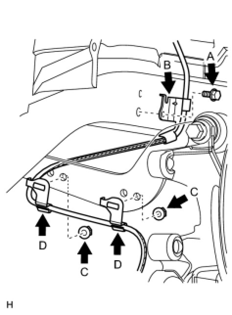

picture 11

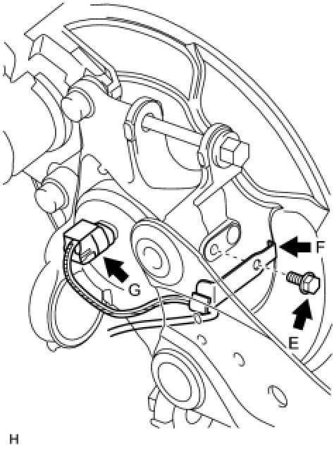

(c)Remove the bolt (labeled A) and sensor clamp (labeled B) from the side member.
picture 12
(d)Remove the 2 nuts (labeled C) and 2 sensor clamps (labeled D) from the upper arm.
(e)Remove the bolt (labeled E) and sensor clamp (labeled F) from the carrier.
picture 13
(f)Disconnect the skid control sensor wire connector (labeled G) from the skid control sensor.

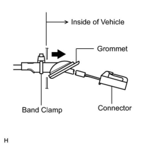

(e)Insert the connector and grommet into the inside of the vehicle through the hole in the wheel house.
picture 16
NOTICE:
Make sure the grommet band clamp remains on the outside of the vehicle.
(f)Hold the grommet and pull it toward the outside of the vehicle. Then fix the grommet in place so that it is not tilted.
picture 17
