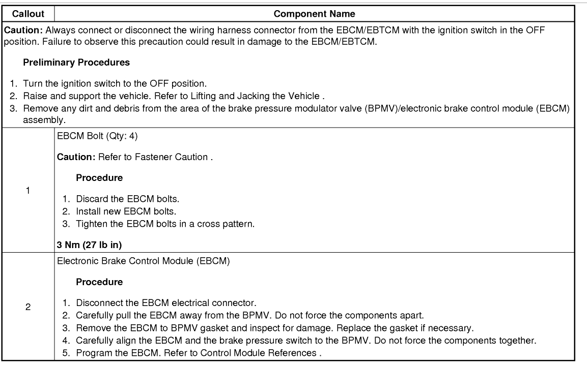

ABS, traction control off , service stabilitrak, e-brake light all on. Started intermittent would come on (chime) and go back out. this lasted about two days. I knew my front brakes were getting down so I replaced front brakes, checked wheel hubs and wires (all looked good) when I was done the intermittent stopped and lights are on full time now. Checked codes, 121 loss of communication with ABS control module. Checked fuses and ground. Now I am unsure of what to try?

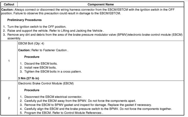

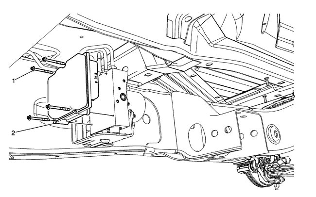

It sounds like you have an ABS controller that is going bad.
Here is a guide that will show you how to get the problem fixed:
https://www.2carpros.com/articles/how-to-replace-a-abs-controller

Haven't repaired yet but more codes now. U0073. Speedometer is bouncing around and transmission shifting funny sometimes?

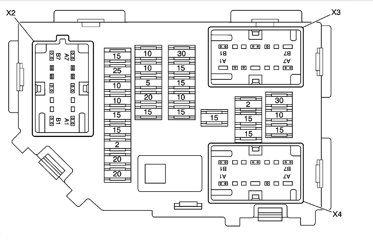

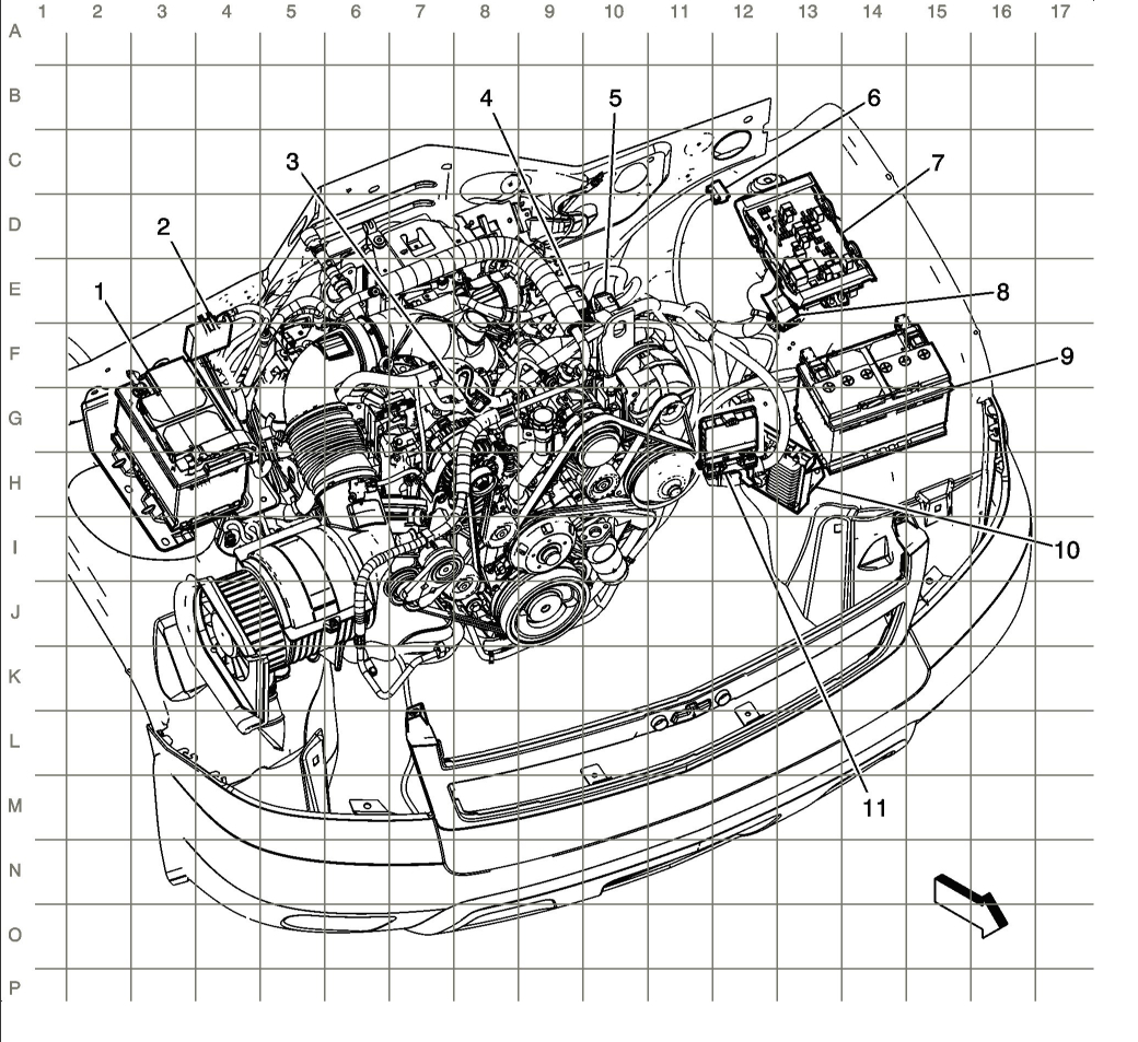

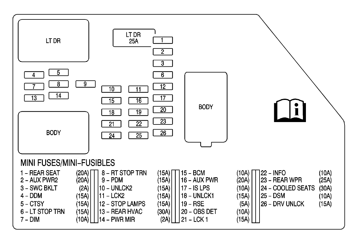

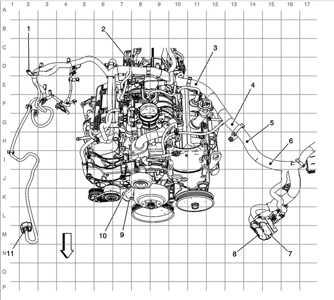

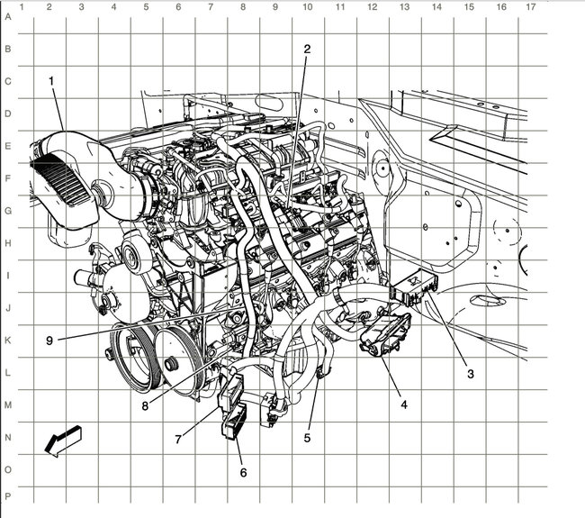

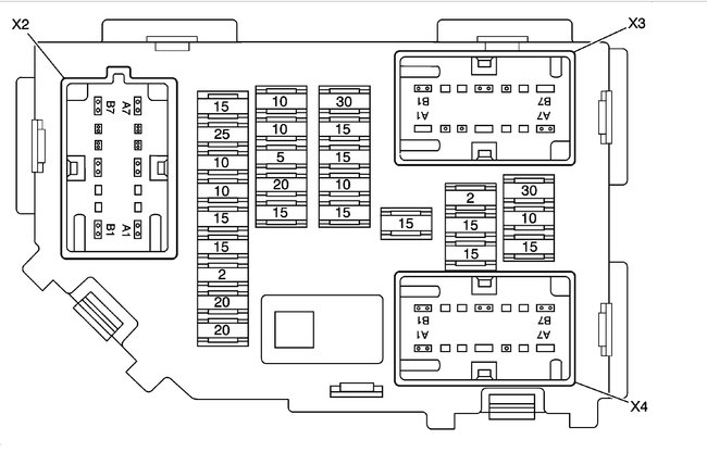

Opps, that is a bad sign. I am thinking the ABS controller is out. I would try a used one so you can plug and play. But first check all fuses here is a guide.
Here is its location (below)
1 - Air Intake Duct
2 - X111
3 - Fuse Block - Underhood X2
4 - X109
5 - X110 (NQF/NQG/NQH)
6 - Engine Control Module (ECM) X2
7 - Engine Control Module (ECM) X1
8 - G102
9 - J105
1 - Battery - Right
2 - Fuse Holder
3 - X127
4 - X108
5 - X107
6 - X123 (PTO)
7 - Fuse Block - Underhood
8 - X109
9 - Battery - Left
10 - Engine Control Module (ECM)
11 - Transmission Control Module (TCM)
1 - Mega Fuse Ring Terminal
2 - X175 (M30)
3 - J128
4 - J105
5 - J106
6 - J130 (M30 with NQG/NQH)
8 - Engine Control Module (ECM) X2
9 - G103
10 - X112
11 - Mass Air Flow (MAF)/Intake Air Temperature (IAT) Sensor Connector
