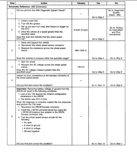

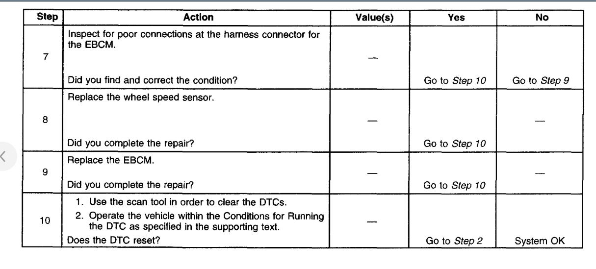

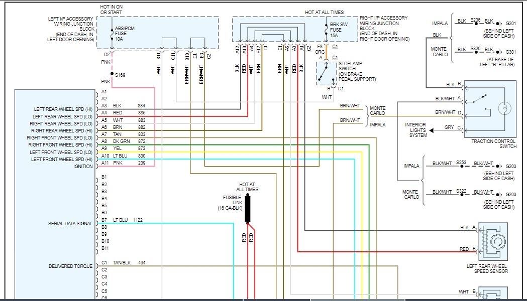

Do you have a scan tool to read live data from the sensors while driving? That will tell you which wheel or wheels are not sending any signals.
https://www.2carpros.com/articles/abs-wheel-speed-sensor-test
https://www.2carpros.com/articles/how-to-replace-an-abs-wheel-speed-sensor

Test Description
The numbers below refer to the step numbers on the diagnostic table.
4. Measures the resistance of the wheel speed sensor in order to determine if the sensor has a valid resistance value.
5. Ensures that the wheel speed sensor is generating a valid AC voltage output.

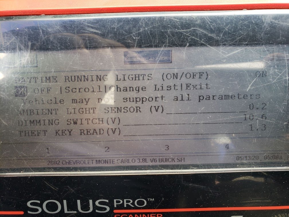

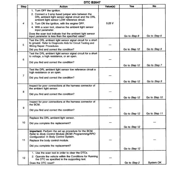

I borrowed a friends Solus Pro since my Innova 3100j won't read body codes.
It brings up a "B2647 Ambient Light Sensor Circuit Low".
I went to the friends junkyard and pulled 3 sensors and none of them will fix the issue. I can buy a new sensor but surely all 3 of these aren't bad also?
I attached the data view, it started at 0.2 and went as high as 0.5 on my drive home.
Any help would be appreciated.
Pete
May 13, 2020 at 9:07 PM

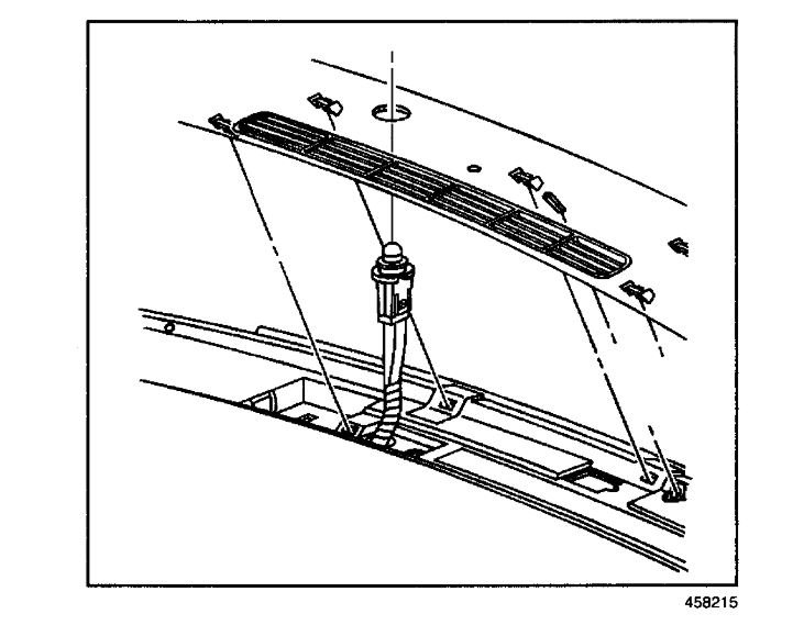

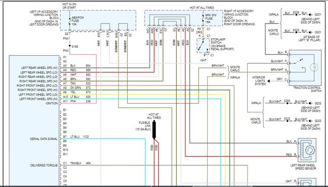

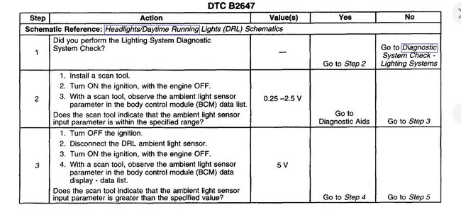

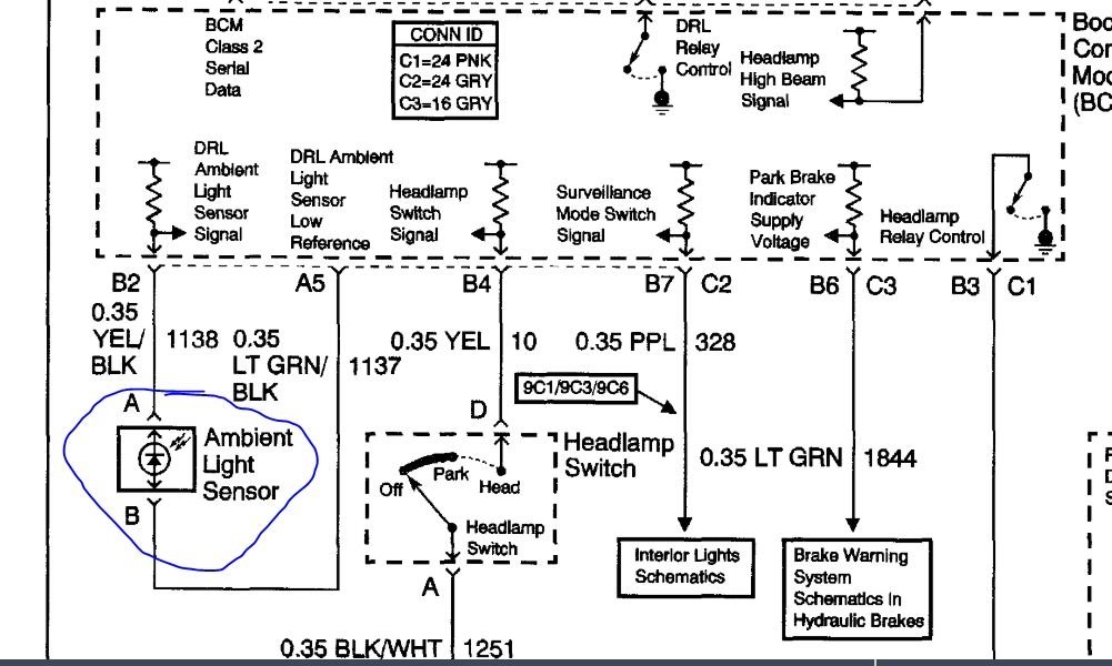

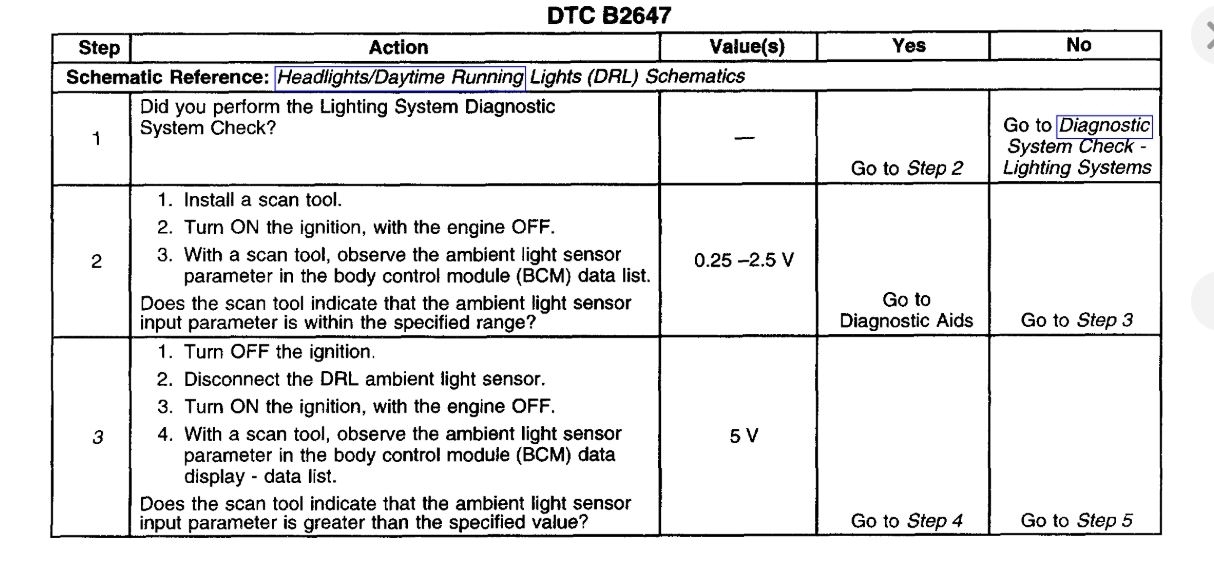

Okay, I attached the circuit description and flow chart below. This looks like a wiring issue with the wires to the sensor.
The sensor should have 5 volts like any other sensor in the car. I attached a diagram for you of the sensor which shows the pin number at the BCM that sends the 5 volt signal.
CIRCUIT DESCRIPTION
The body control module (BCM) uses the DRL ambient light sensor to control the automatic headlamp system. The DRL ambient light sensor is connected directly to the BCM through the DRL ambient light sensor signal circuit and the DRL ambient light sensor low reference circuit.
CONDITIONS FOR RUNNING THE DTC
The DRL feature or the automatic headlamp control feature must be enabled.
CONDITIONS FOR SETTING THE DTC
The BCM detects a short to ground in the DRL ambient light sensor signal circuit.
The condition above must be present for more than 0.3 seconds.
ACTION TAKEN WHEN THE DTC SETS
The BCM stores DTC B2647 in memory.
The SERVICE VEHICLE SOON telltale illuminates
The headlamps, park lamps, tail lamps and marker lamps will illuminate to night intensity.
CONDITIONS FOR CLEARING THE DTC
The BCM no longer detects a short to ground in the DRL ambient light sensor signal circuit.
A history DTC B2647 will clear after 100 consecutive ignition cycles if the condition for the malfunction is no longer present.
DIAGNOSTIC AIDS
If the DTC B2647 is a history DTC, the fault may be intermittent. Refer to Testing for Intermittent and Poor Connections in Diagnostic Aids.
The following conditions may cause an intermittent malfunction to occur:
An intermittent short to ground in the DRL ambient light sensor signal circuit.
The DRL ambient light sensor is intermittently shorted to ground internally.
The BCM is intermittently shorted to ground internally.

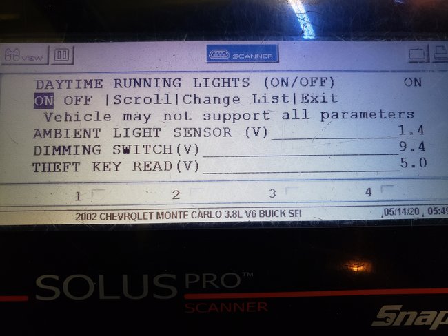

Roy, I appreciate the help. I probed the wires at the plug and get the same reading so I think the wire is good to the sensor. When I did the step where I unplugged the sensor, I attached that reading. I'm getting to the extent of my abilities but it's looking like maybe it's the BCM. Pete
May 14, 2020 at 12:27 PM
The fact you have low voltage to the sensor tells me either the wiring or the BCM.
What was the voltage at B5 at the body control module?
May 14, 2020 at 12:48 PM
FGR8FRK
  • 51 POSTS
.4 light green/black. I was supposed to leave it plugged in correct?
May 14, 2020 at 12:50 PM
Correct. if there is not 5 volts at that plug or terminal, the BCM is the issue.
May 14, 2020 at 1:15 PM

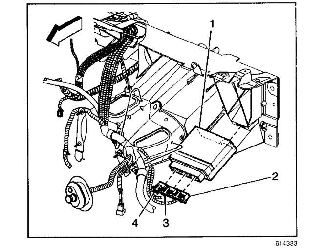

FGR8FRK
  • 51 POSTS
Okay, thanks. Please 1 more question. Removed the BCM and it's not marked with a part number other than on the side it has a sticker that has a number "13233032013270 remfg" so it's been replaced before I'm guessing. So GM Parts Direct list 19244861 as a direct replacement. I've seen some on ebay and I have access to my buddies junkyard which he has a couple of these MC's and some Impalas, from what I'm seeing they are compatible with a different part number. Will this be plug and play or will it have to be programmed, and will I be able to do it myself? Again I really appreciate your help.
Pete
May 14, 2020 at 2:21 PM
They need to be programmed and I will warn you that a used BCM has about a 10% chance of taking the programming. The dealer will not even consider doing it.
The part number must be exactly the same.
