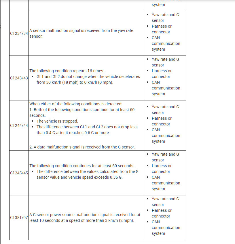

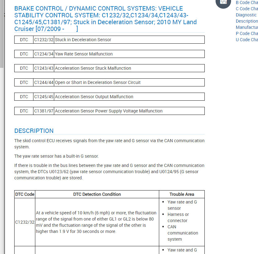

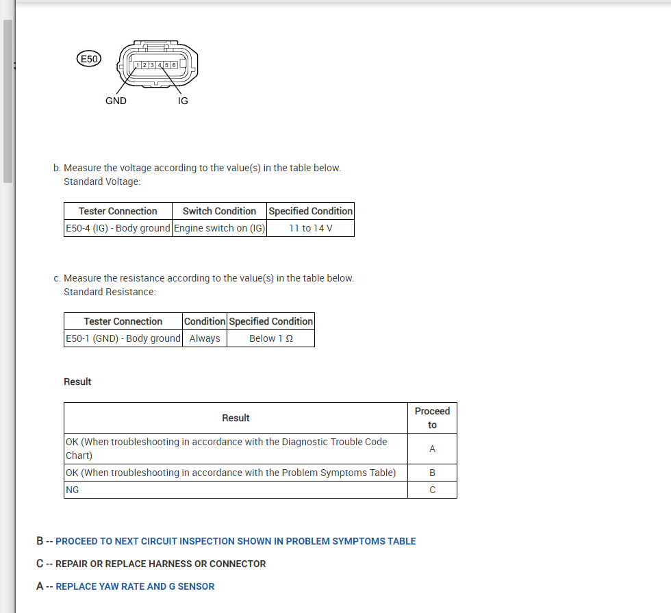

abs track light on dtc c1244? how do I fix it?
Jan 6, 2020 at 7:03 AM

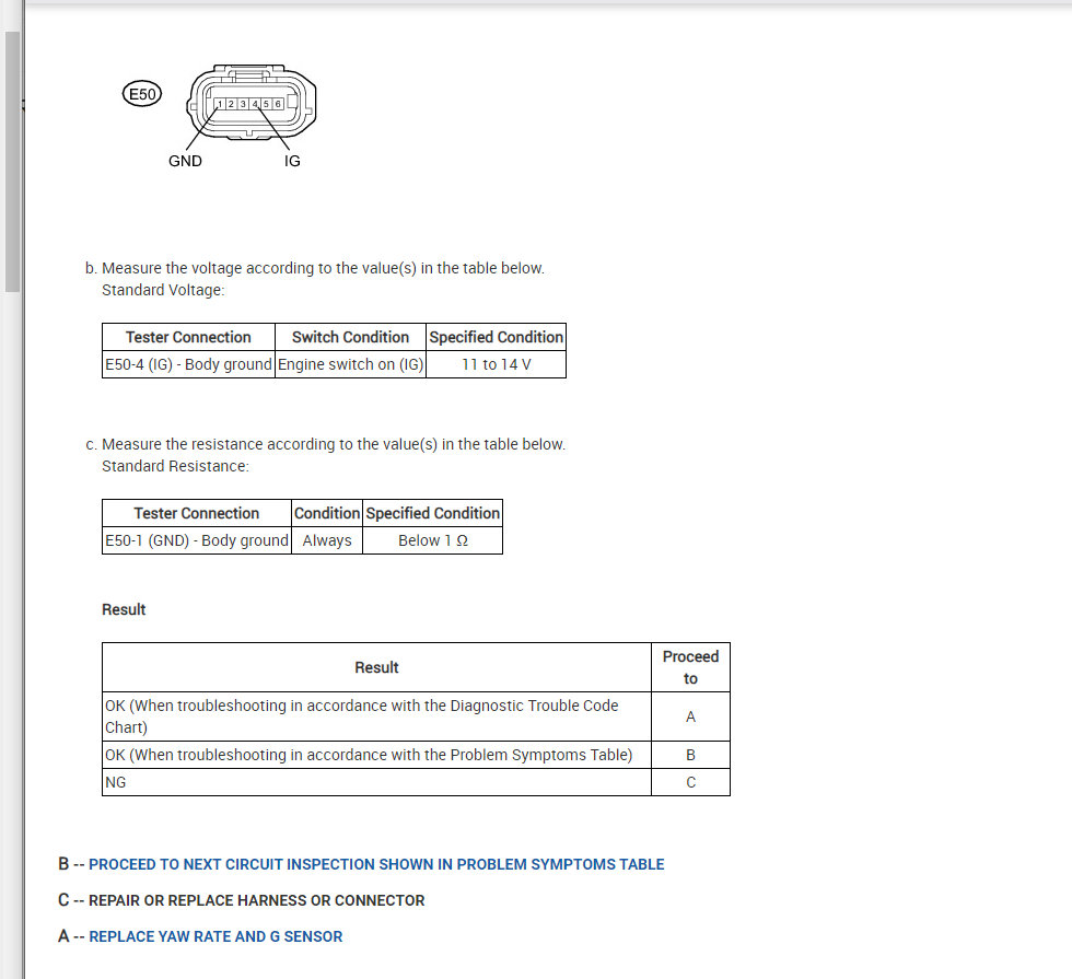

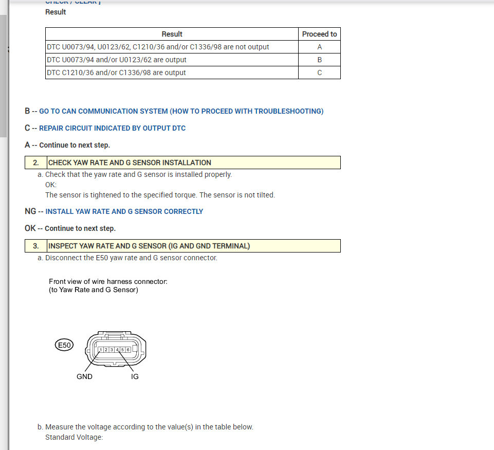

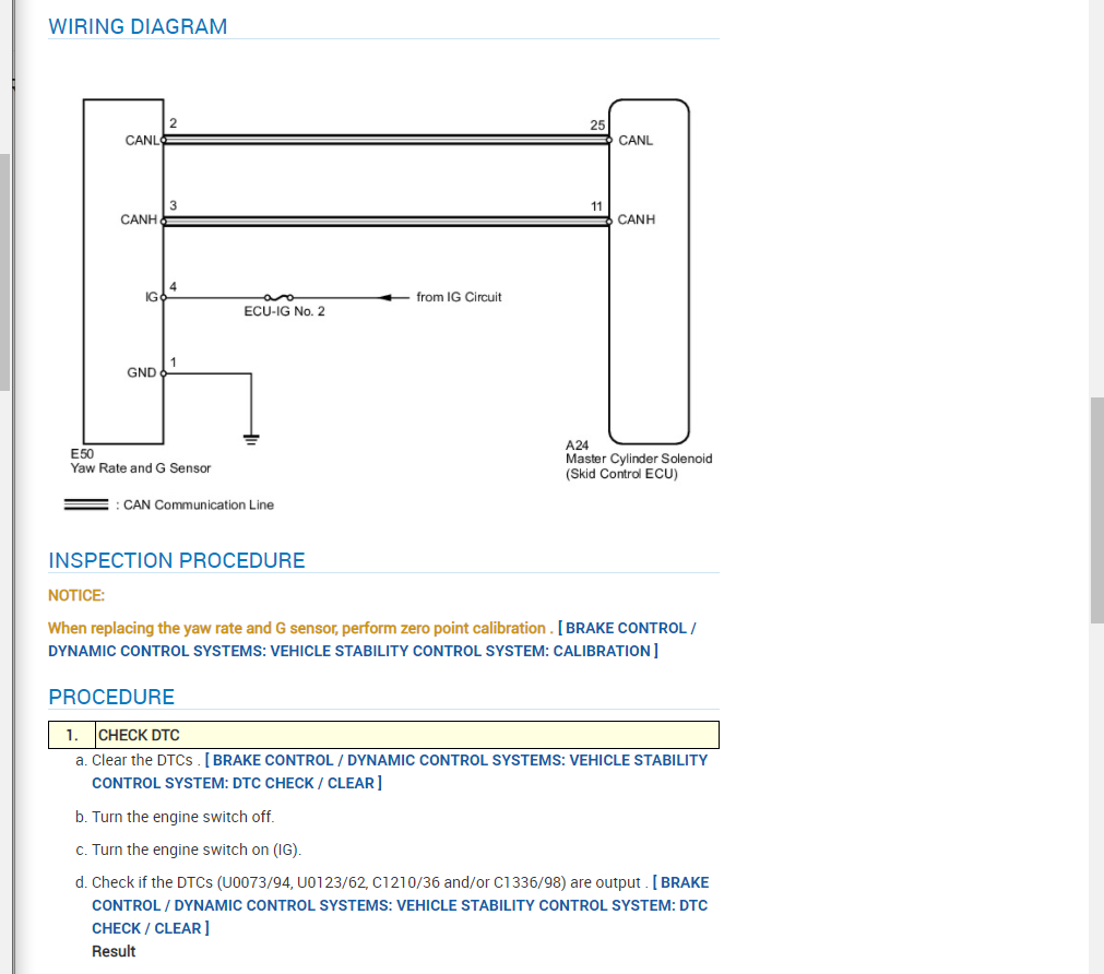

More than likely you have an issue with the yaw rate sensor or harness, but we need to run through this testing to find out what the issue is.
Here is a guide that will help with this testing:
Below you will find the process from the manual that will provide the testing needed to figure this out.
Please run through this and let us know what you find, and we can take next steps if needed or answer questions that you may have. Thanks
