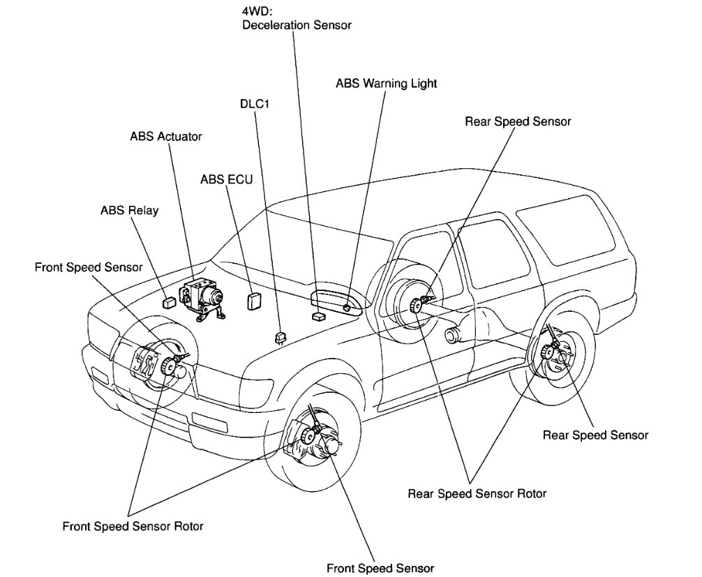

I noticed that when I turn the key to the on the ABS trac relay clicks three times. What’s the reason and I also noticed I don’t have a ECT switch as well could that be the problem with the clicking sound?

I would try replacing the relay first and if that does not work the ABS ECU could be shorting out, here is how to swap the relay and the ABS control unit. Also, I would scan the ABS system to see if there are any codes.
https://www.2carpros.com/articles/anti-lock-system-testing-and-repair-abs
Check out the images (below). Please let us know how it goes.
