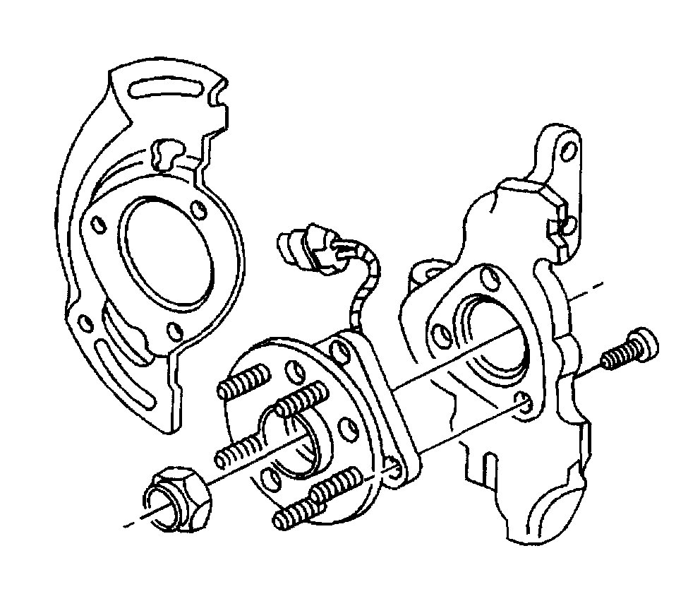

I attached a picture of the hub bearing / sensor so you can see the wiring from the hub.
Let me know what you find.

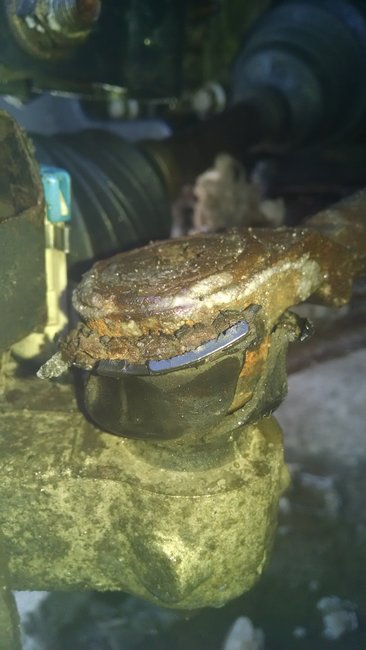

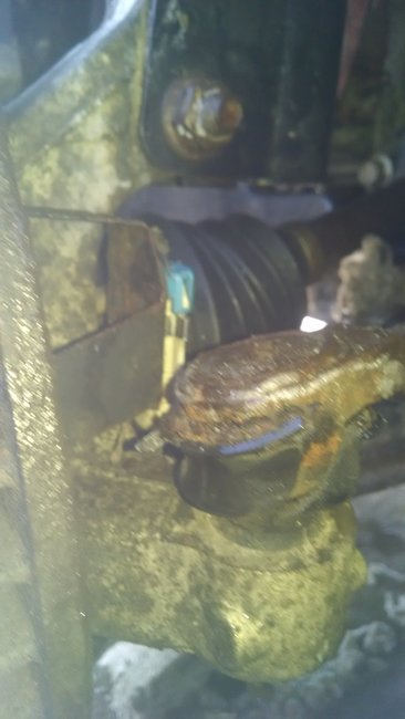

I was checking the speed sensor and saw this. I can think of what it is but it looks like it needs replaced.
Feb 2, 2019 at 9:14 AM
  • 110,244 POSTS
Hi, Lori, and welcome back.
That is an outer tie rod. If it has excessive play, it needs replaced. Additionally, when replacing, make sure to measure the overall length between the end of the joint and where is screws onto the inner tie rod. If you don't make it exactly the same length, the alignment (toe in/out) will need reset.

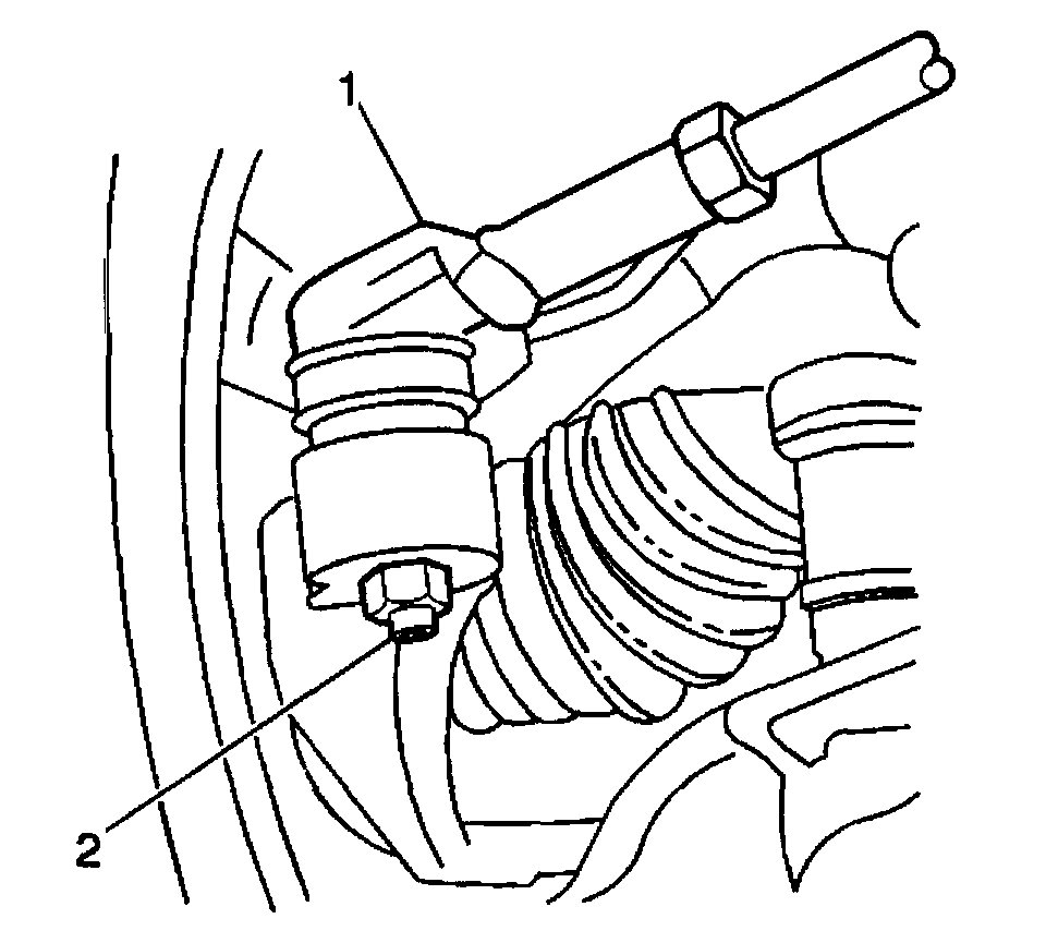

3. Remove the prevailing torque nut (2) from the outer tie rod assembly (1).

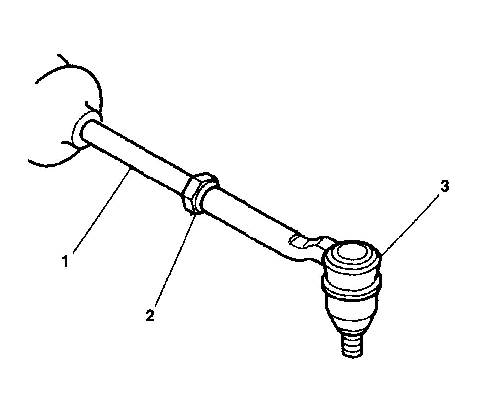

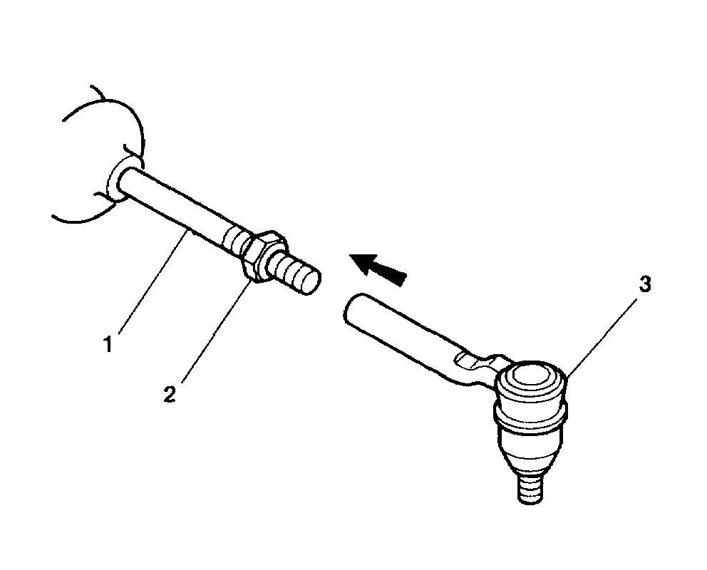

4. Loosen the jam nut (2) on the inner tie rod assembly (1).
Notice: Do not attempt to disconnect a steering linkage joint by driving a wedge between the joint and the attached part. Seal damage may result which will cause premature failure of the joint.

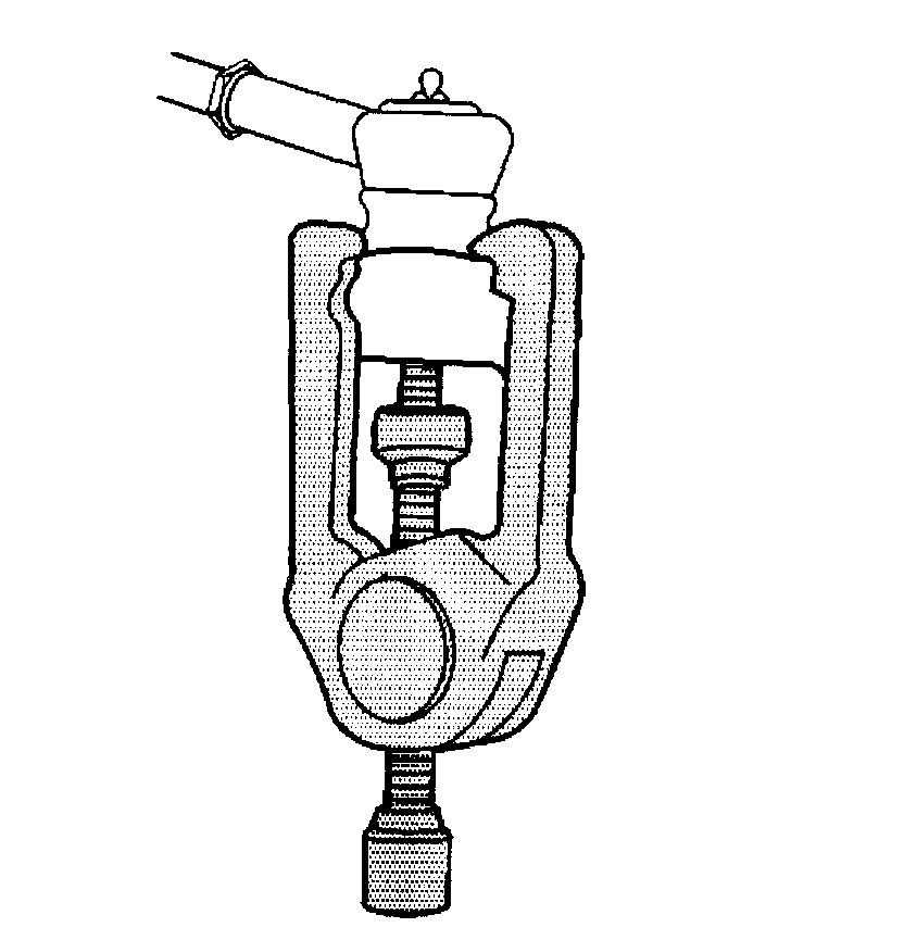

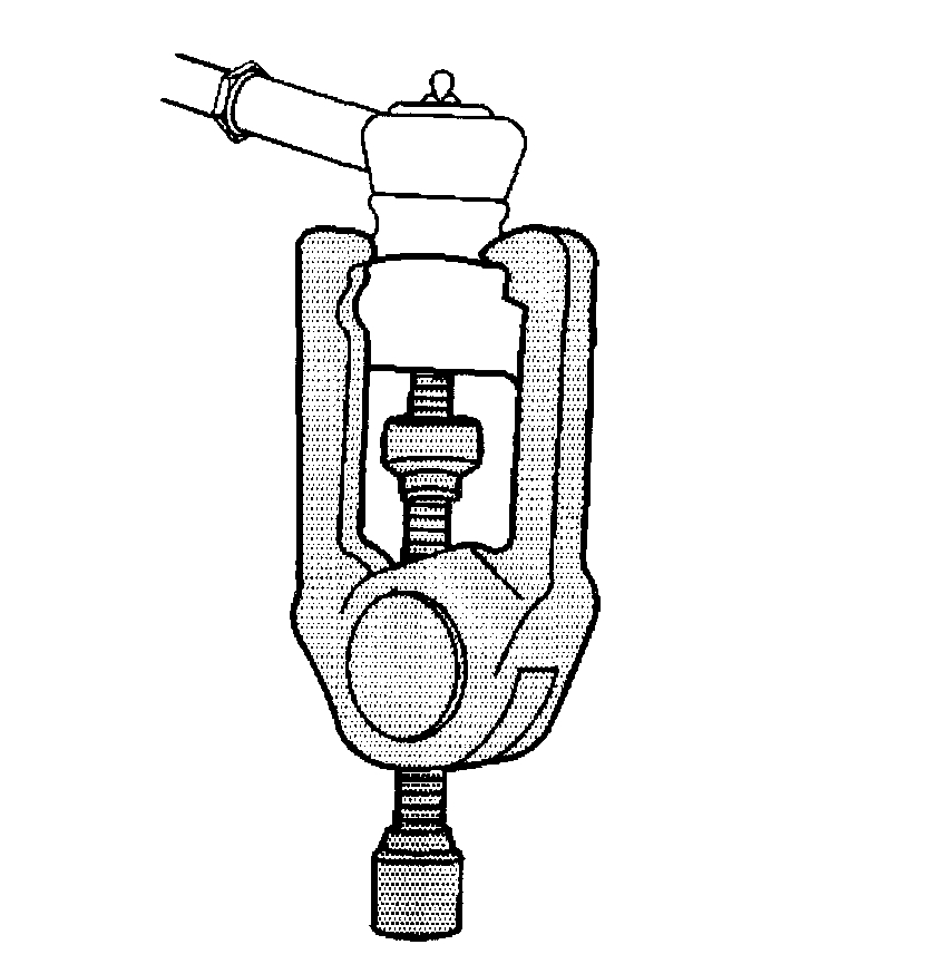

5. Remove the outer tie rod assembly from the steering knuckle using J24319-B.

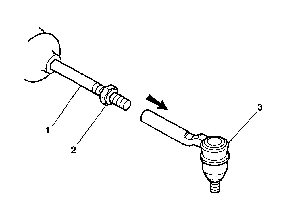

6. Remove the outer tie rod assembly (3) from the inner tie rod assembly (1).
Installation Procedure
Picture 5
1. Install the outer tie rod assembly (3) to the inner tie rod assembly (1). Do NOT tighten the jam nut (2).

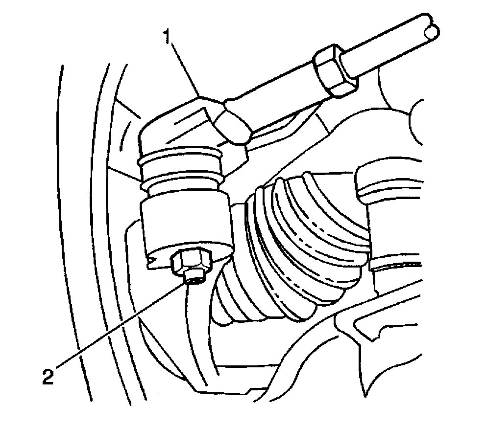

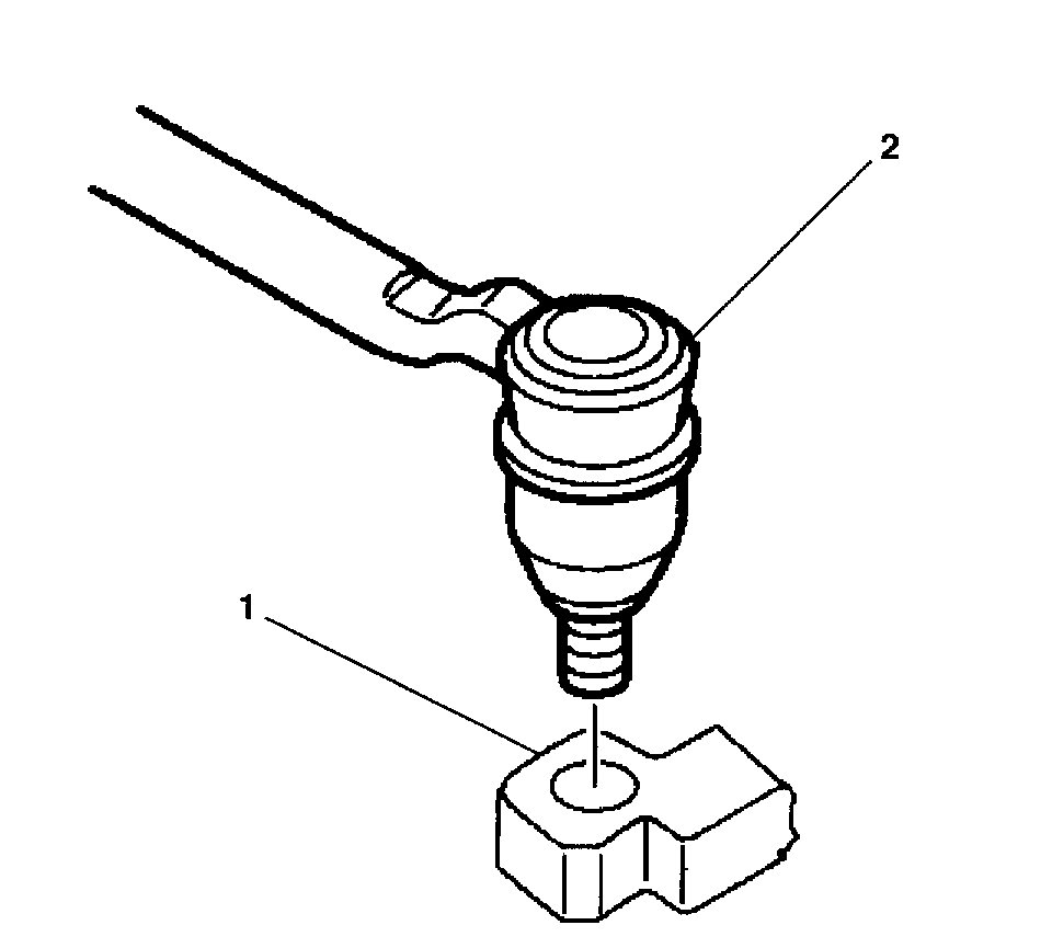

2. Install the outer tie rod assembly (2) to the steering knuckle (1).
Notice: Refer to Fastener Notice in Service Precautions.
Picture 7
3. Install the prevailing torque nut (2) to the outer tie rod assembly (1).
Tighten the nut to 30 Nm (22 ft. lbs.) plus an additional 120 degrees of rotation.
NOTE: Visually inspect to ensure that 2 1/2 - 4 1/2 threads are visible past the nylon washer.
Tighten the jam nut to 70 Nm (52 ft. lbs.).
