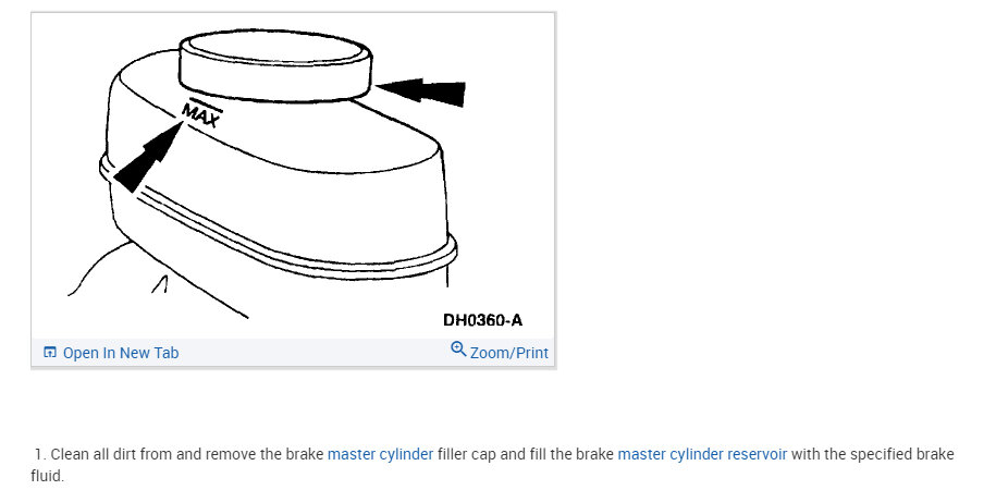

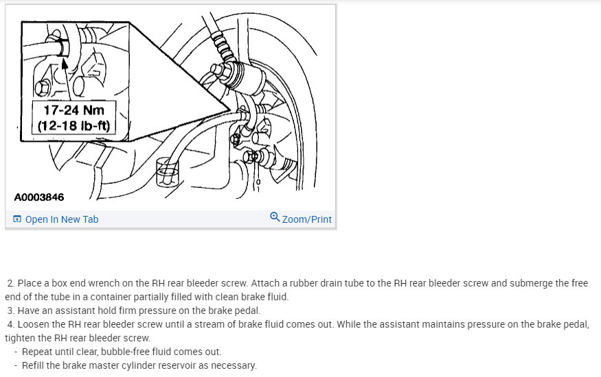

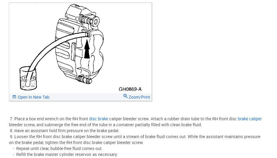

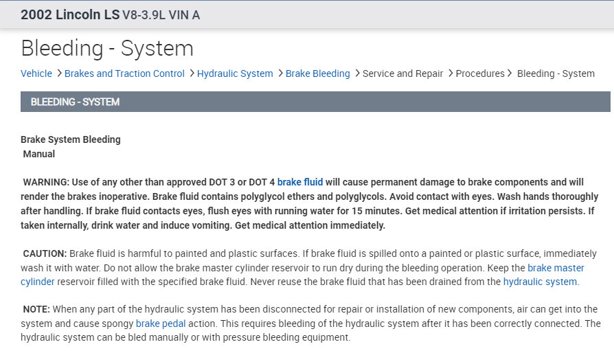

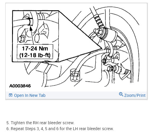

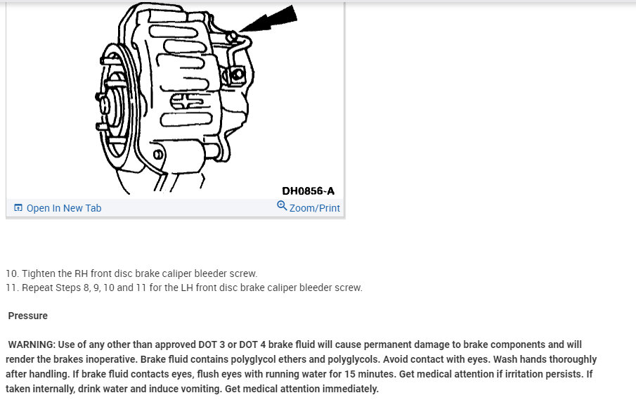

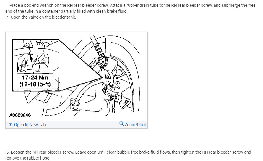

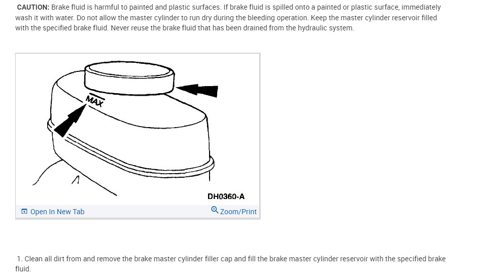

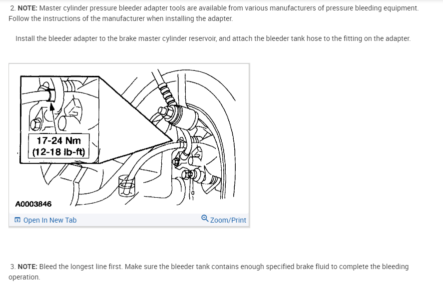

As far as a scanner, no. There is no automated bleed procedure for this vehicle, so it won't help. If you haven't bled the rear, you should do it. Start at the wheel furthest from the master cylinder (right rear) and work toward the closest.
I attached the directions from the manual for bleeding the system. They indicate traditional bleeding or using a vacuum bleeder. Both directions are included.
Let me know if this helps. Also, let me know if you are able to get a pedal if you pump the brake pedal.
