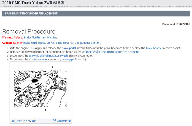

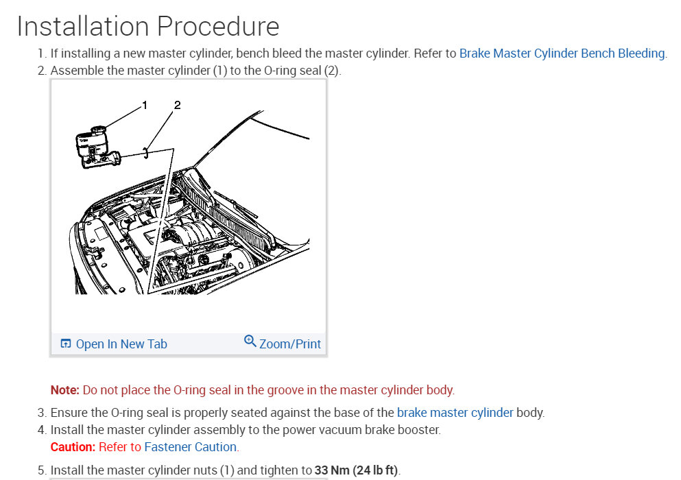

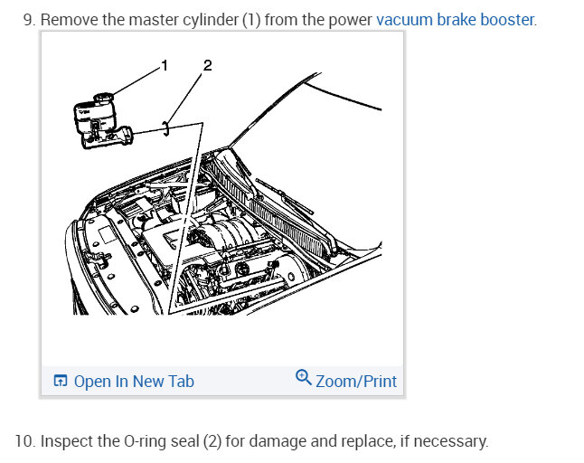

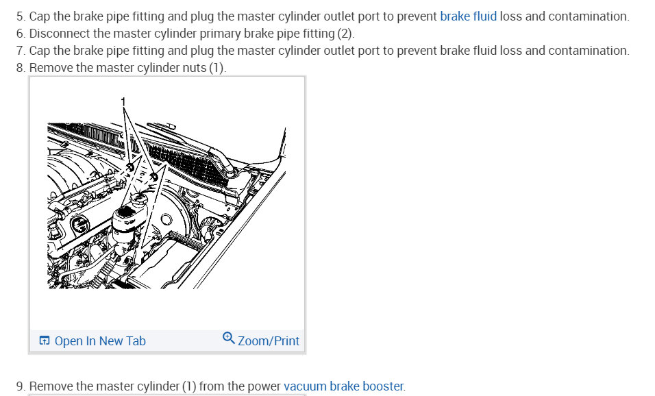

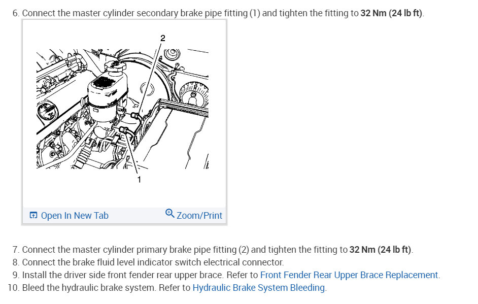

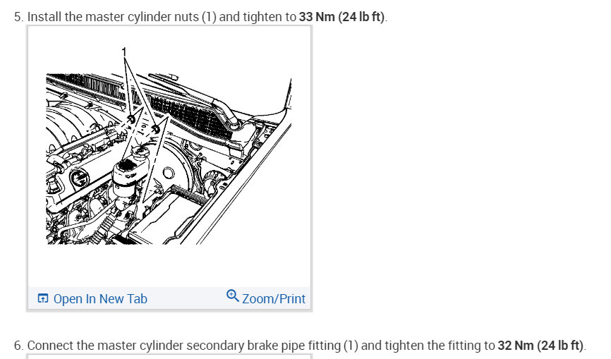

Nice work learning about brakes and cars in general, they play such a large role in our lives. Yep, that sounds like a classic brake master cylinder failure. Here is a generic guide to help you step by step with instructions in the diagrams below to show you how on your car:
https://www.2carpros.com/articles/how-to-replace-a-brake-master-cylinder
and this video will show how to bleed it before installation:
https://youtu.be/WDxvEQrMkBg?si=ePoyGIJ1NoJn2SOg
Check out the images below. Please upload pictures or videos of the problem so we can see what's going on.
