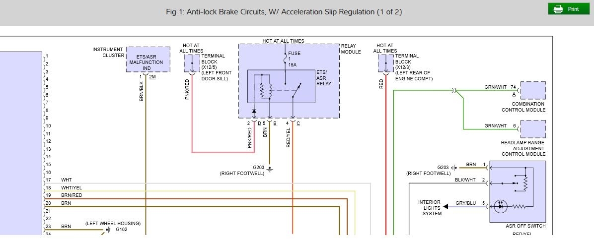

fuse location check this first.

When i open the image it is full page. did you just click on the image? anyway it is the ETS/ASR relay by the looks of things it is in the right front foot well. i cannot get a larger image sorry.

Red yellow from control module is power power to relay switch side, pink/red wire from terminal block left hand kick panel is relay constant power. did you find the relay and control module? sorry for the delay, we have had some serious bush fires around here over night and the weather has been such that fire duties come first just now, but things are settling down. i am in Australia so time difference comes into play as well.

Do you have power at the 15 amp fuse at the relay module? i am beginning to wonder if the module it self is faulty, did you find the ETS/ASR relay?

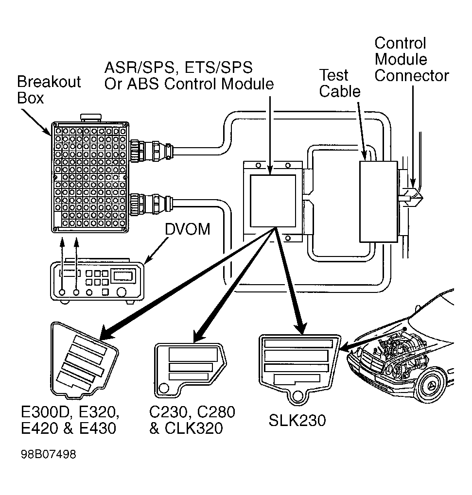

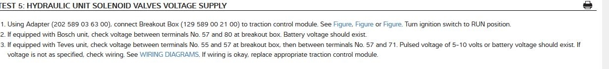

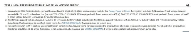

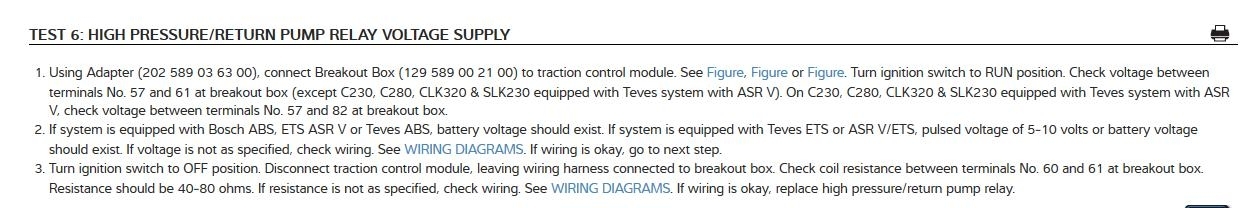

  • 31,937 POSTS
i found some more on the system, see pictures for details.
