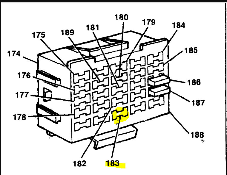

I cannot find the power distribution center which locates the ABS fuse under the hood of my SUV and it is not in the fuse panel that is the driver side Dash.

Looking through my manuals, it shows fuse 183 in the interior fuse box. I attached a pic below and highlighted the fuse location.
Check that and let me know if the fuse is there. If it is and checks good, confirm there is power to and from it.
See pic below.
