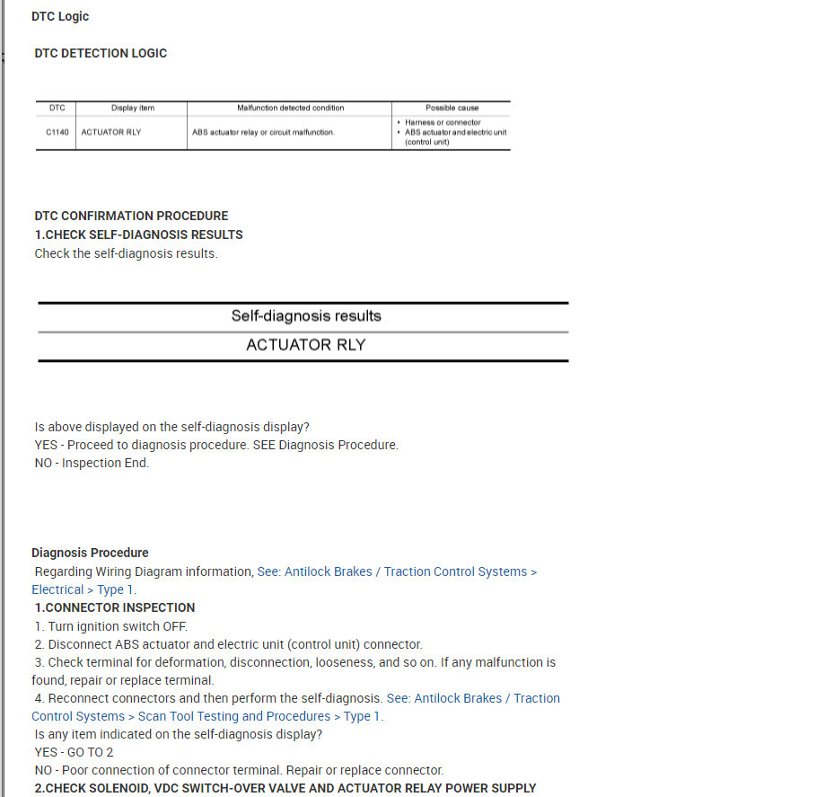

dtc c1140?
2011 NISSAN PATHFINDER
140,000 MILES • 4.0L • V6 • 2WD • AUTOMATIC
MEANGENE41
I don’t know if I can fix this dtc c1140 Please help!!!
Nov 8, 2019 at 8:11 AM

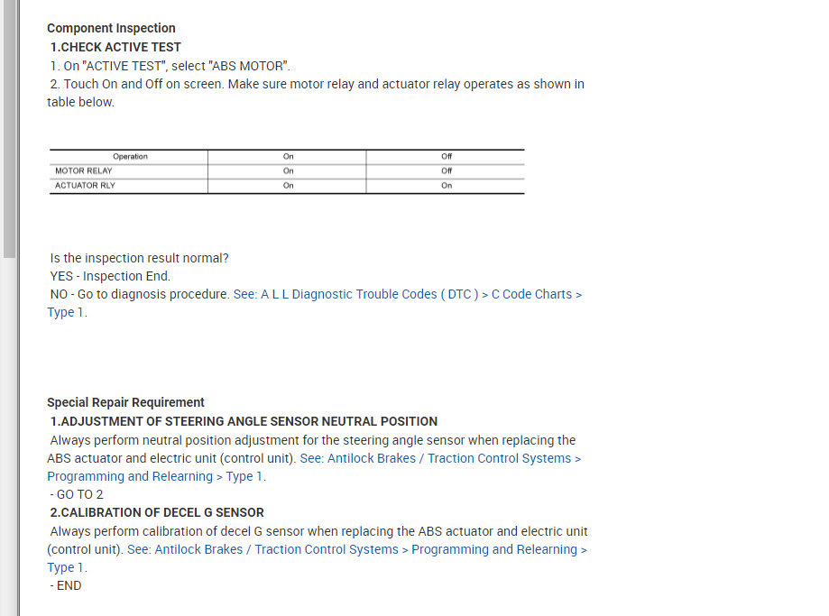

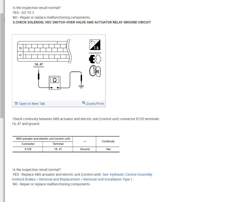

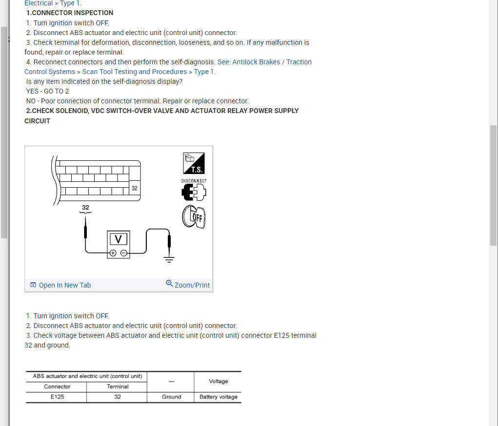

This is code is related to the ABS system and it is not that complicated to diagnose but we just need to test the wiring connections as shown in the documents below.
Here are a couple guides that will help with this as well:
Please run through this info and let us know what questions you have. Thanks
