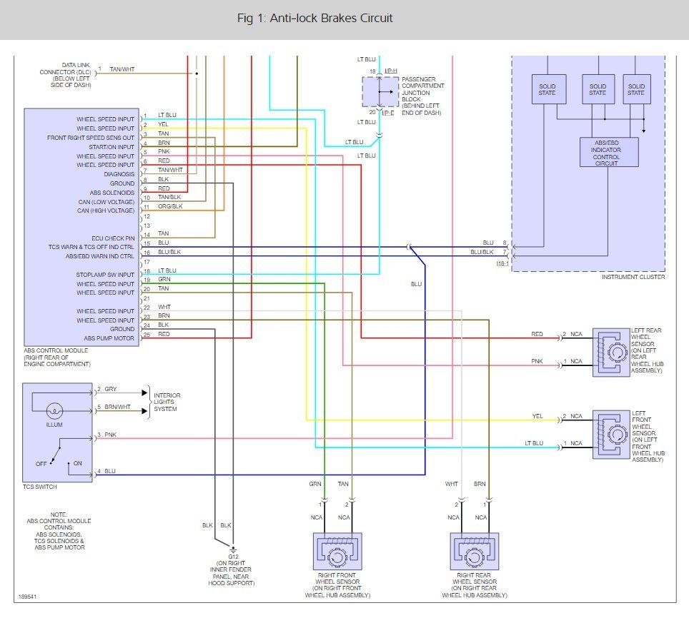

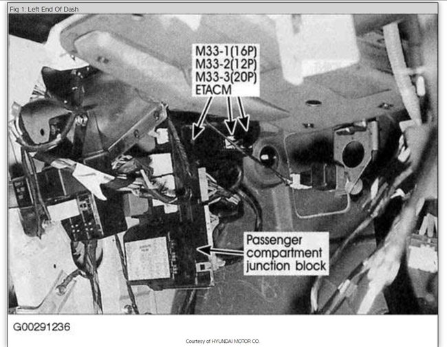

Both ABS and traction control lights came on. I Braked lost control and ran over the curb. Damage to front end parts have been replaced. Now I need to know how to troubleshoot and replace the ABS and traction control parts.

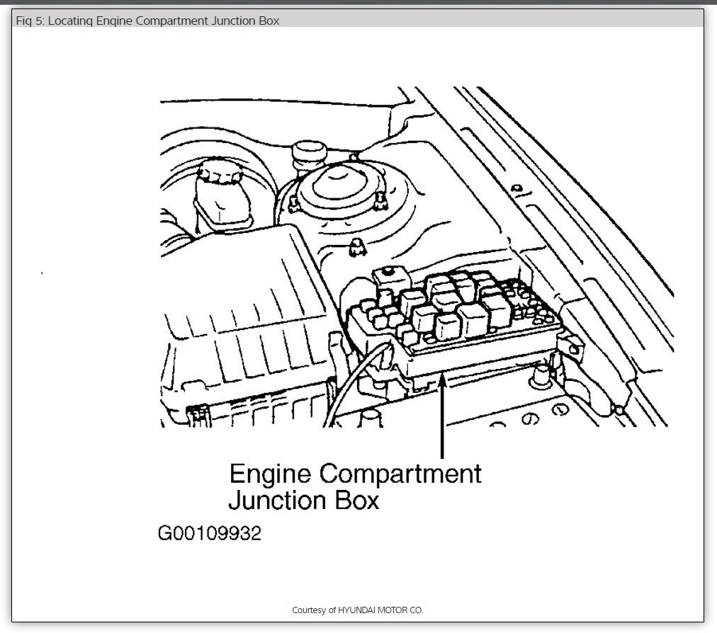

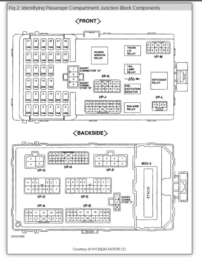

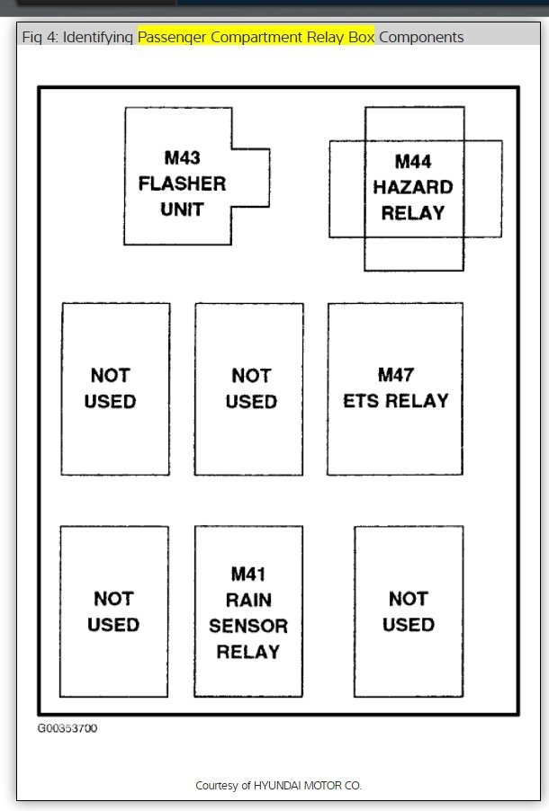

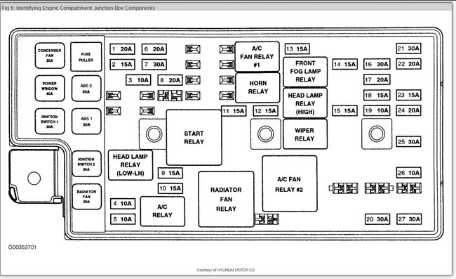

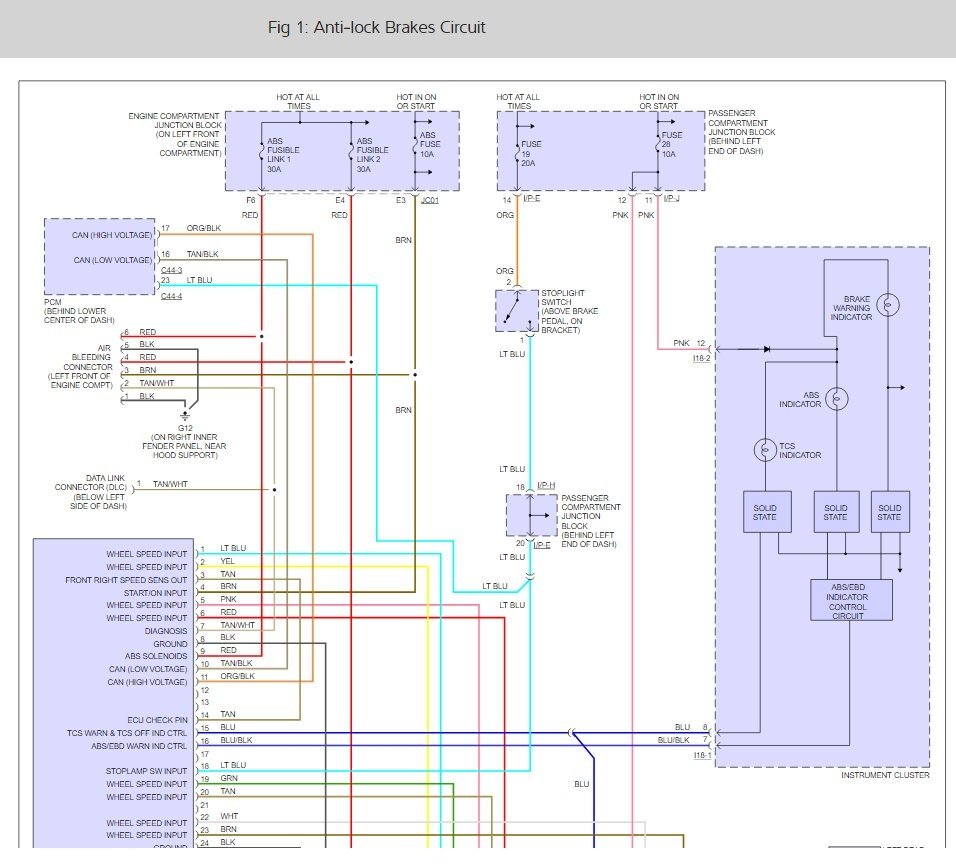

I would start by checking the fuses, here is a wiring diagram (below) and a couple of guides to help you get the problem fixed:
https://www.2carpros.com/articles/abs-warning-light-on-easy-repair-guide
and
Please run some tests and get back to us we are interested to see what it is.
