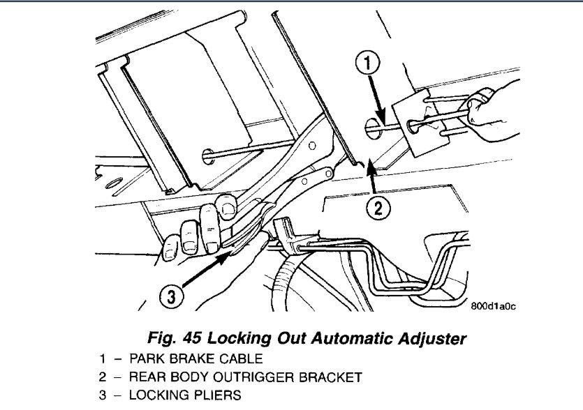

Drivers side rear wheel is locked up
170,000 MILES • 1.3L • 6 CYL • 2WD • AUTOMATIC
EDGARWINTERS
How do you reset the the ABS?
Where is the plug in for the ABS system?
Jan 19, 2020 at 11:45 PM

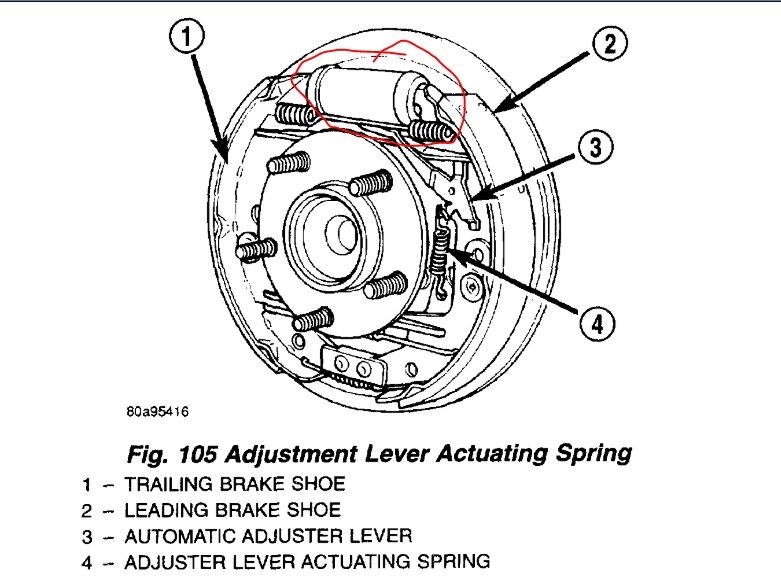

Good afternoon,
The ABS does not need to be reset. It resets itself every time you turn the key off and then back on.

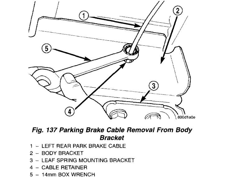

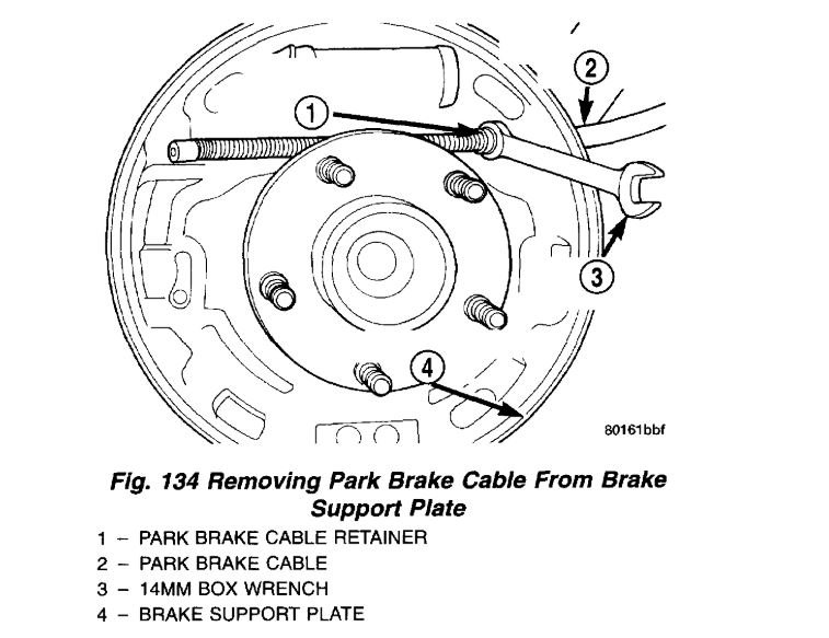

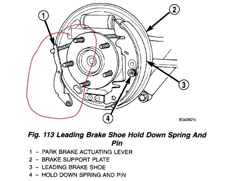

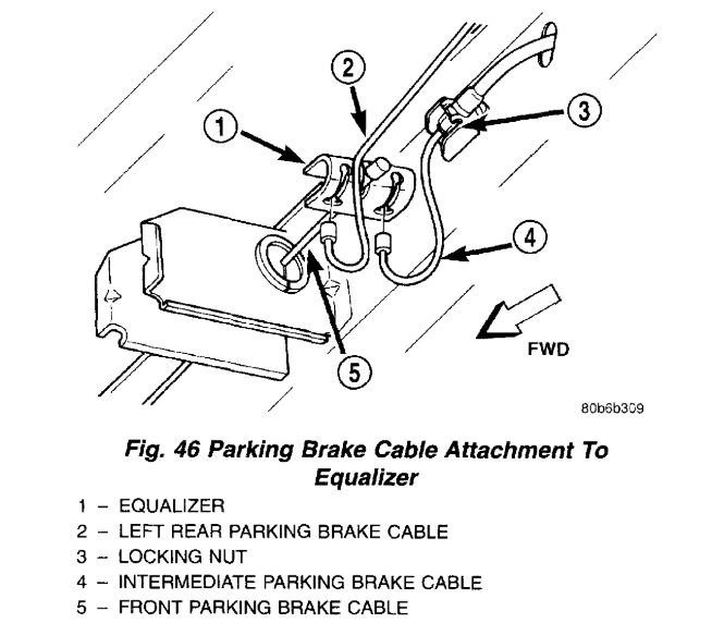

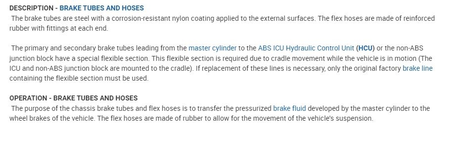

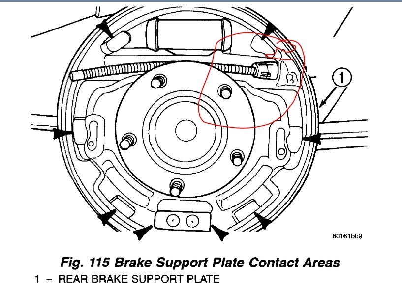

If you have a rear-wheel locked up, it is a mechanical issue with the brakes, not the ABS system.
https://www.2carpros.com/articles/how-to-replace-a-wheel-cylinder
It could be a frozen emergency brake cable or a wheel cylinder that is frozen and will not retract.

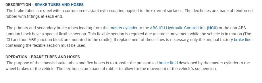

The brake hose could also be bad not allowing fluid to return to the master cylinder.
