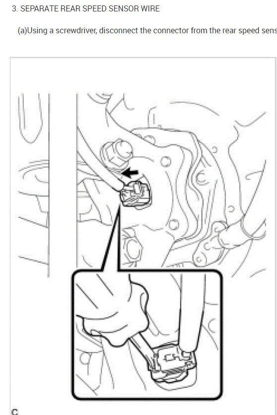

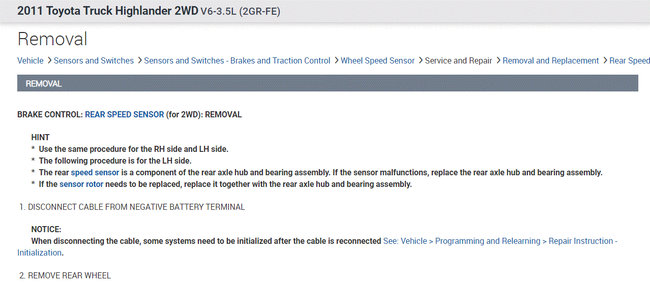

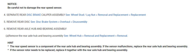

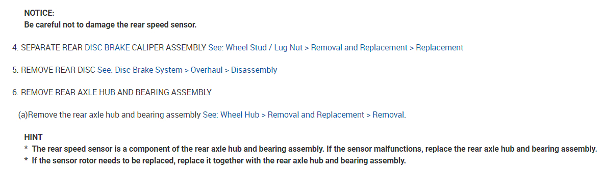

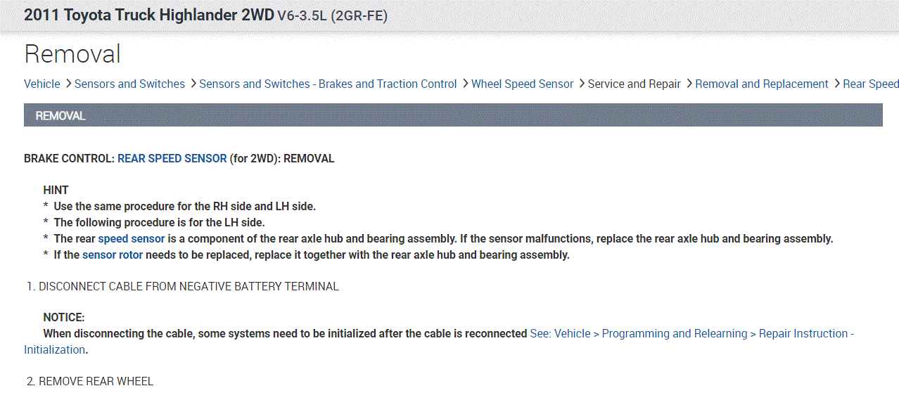

I have to replace the ABS wheel speed sensor for the rear. Thanks!
Mar 15, 2020 at 8:09 PM
  • 110,240 POSTS
I'm not sure if this is 4wd or 2wd. Since it isn't indicated, I went with a 2wd. If that is incorrect, let me know.
To get you started, here is a link that explains in general how it's done:
https://www.2carpros.com/articles/how-to-replace-an-abs-wheel-speed-sensor
If you look at the attachments below, they provide the directions specific to your vehicle.
