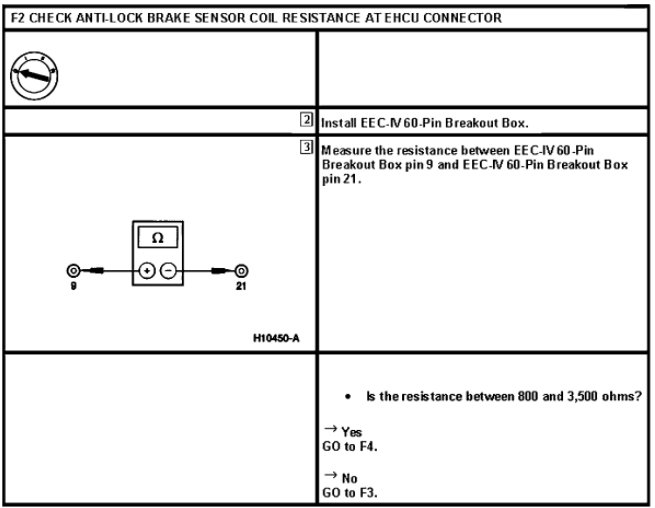

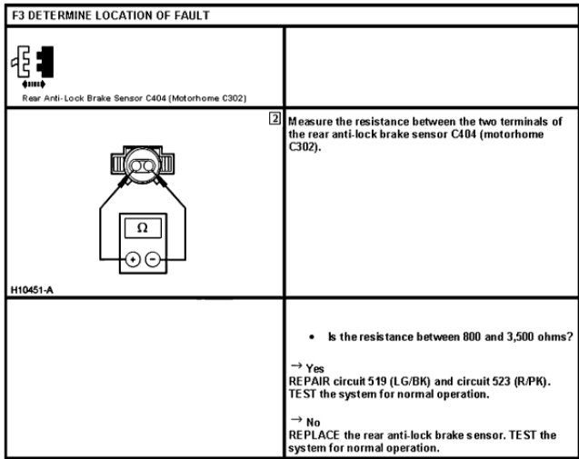

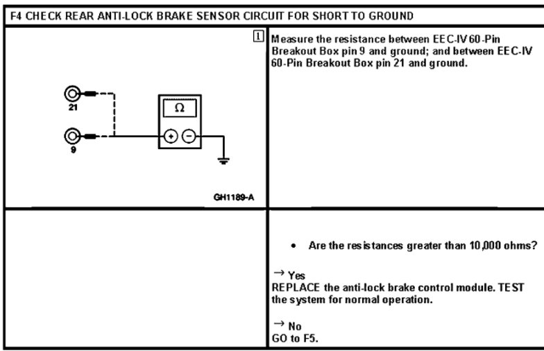

Light on dash stays on (brake-ABS ) code c1230.
Nov 3, 2020 at 6:18 AM

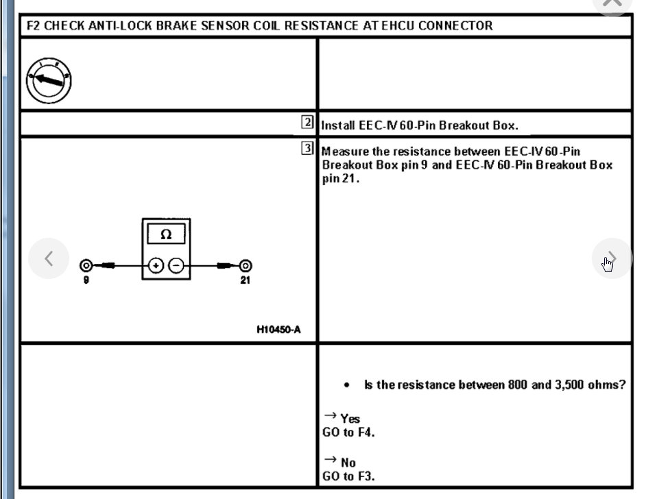

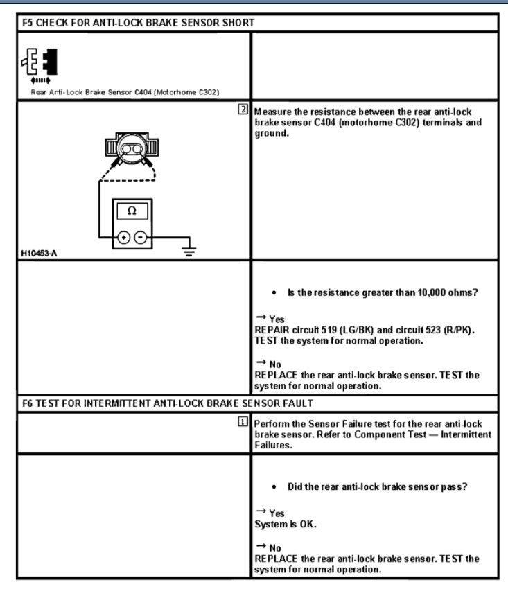

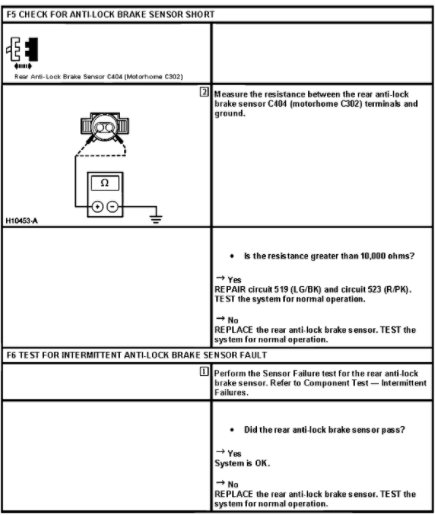

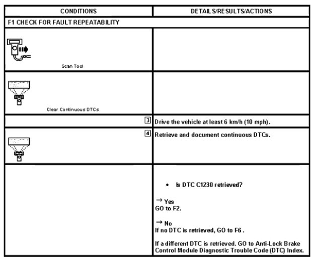

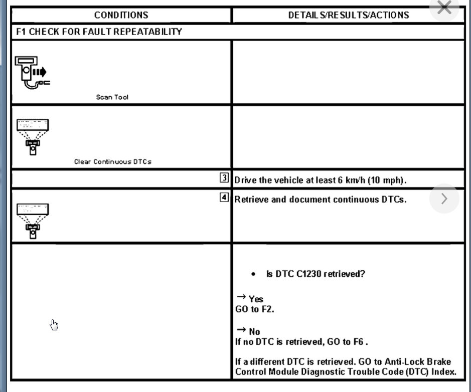

There could be a number of causes for this. I attached the testing that we need to run through in order to find the cause. Let me know what questions you have and we can go from there. Thanks
Nov 3, 2020 at 6:35 AM
DANNY L
  • 5,648 POSTS
Hello, I'm Danny.
I've attached picture diagnostic repair steps for you below. You didn't specify if it's 4 wheel rear anti-lock brakes but that is what I based it on. Let us know what you find and get back to us. Hope this this helps and thanks for using 2CarPros.

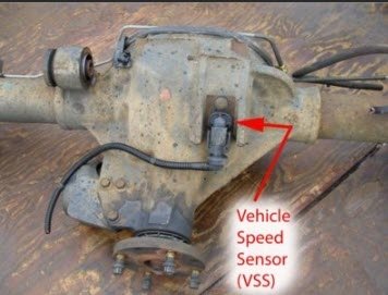

Replace the rear speed sensor. They are relatively cheap and go out pretty often. This is where I start if it were my vehicle and the sensor has never been replaced.
Nov 4, 2020 at 1:26 AM
RONNY ADEN
Yes! Thanks to all involved! Now I just need to see where it is? I’ve looked for it but it doesn’t seem to be visible! Not taken wheels off to inspect inside hub yet . Trying to find a repair manual on a e450 super duty v10 engine so I’ll be ready for repairers in the future? R
Nov 4, 2020 at 2:31 AM
BMDOUBLE
  • 1,139 POSTS
It's mounted above the center of the axle housing. held on with a 10mm bolt, once the bolt is out use a flat tip screw driver or a small pry bar and gently wiggle it up and out.
