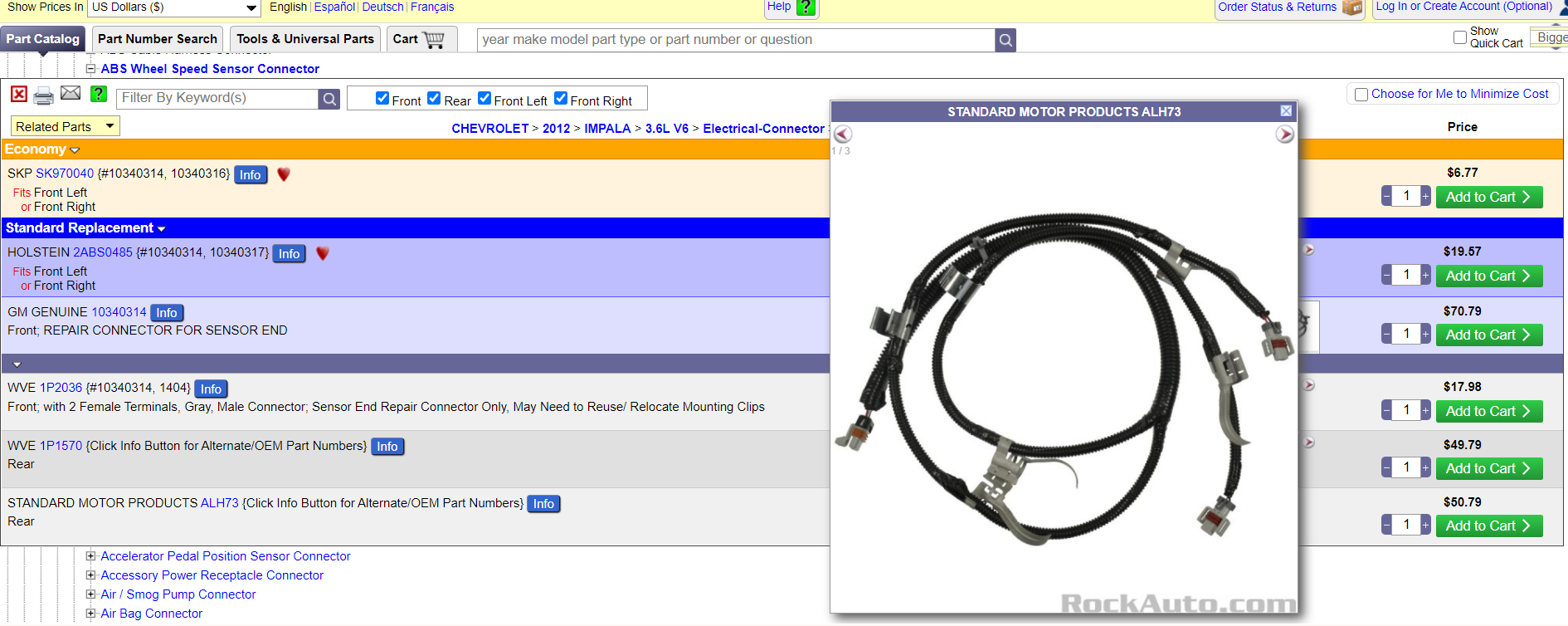

Is there a way to repair the accidental pulling the wire out of the wheel bearing hub assembly or did I just ruin a $120.00 part?
Oct 24, 2020 at 1:47 AM
Experienced Mechanic
52,796 POSTS
Good afternoon,
You can get just the harness form the sensor to the body connector.
I attached the harness for you from Rock Auto.
Just select front or rear when ordering the part. Some parts stores will carry them as well. Call around and see if they carry any of the harness.
