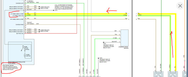

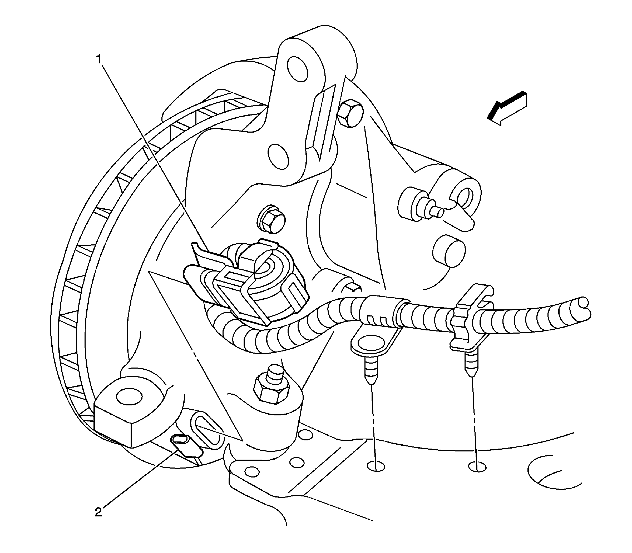

ABS light came on bought Innova scan tool that reads ABS codes gave me C0035-00. so I have been searching everywhere on the internet to find the location of the sensor not the connector and where the rest of the harness leads to. Please please any help would be super helpful.
Dec 24, 2019 at 8:18 AM
  • 110,246 POSTS

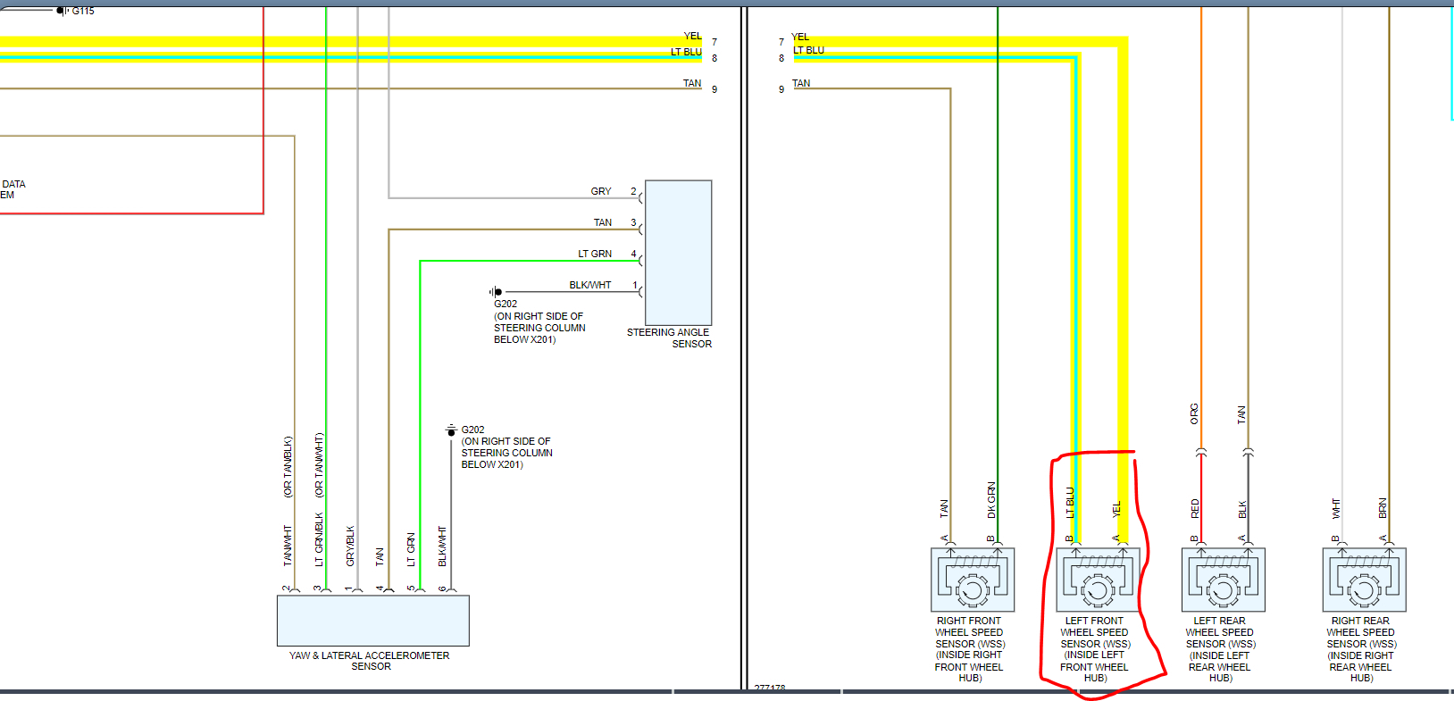

That is for the left front wheel speed sensor. See pic 1 for location. Pics 2 and 3 show the wiring from the sensor to the ABS module.
Let me know if this is what you needed.
