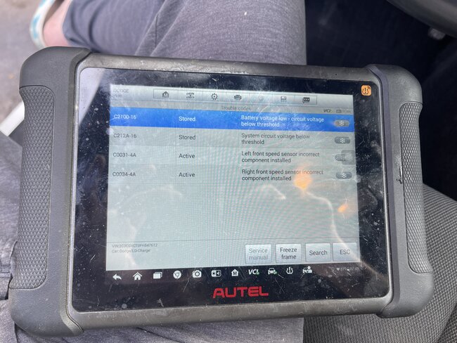

had these codes, then deleted them and still have the front 2 sensors without even driving the car. jacked up the car and i see front pads have been replaced but the abs sensors look old. is this something common on these cars? what are the odds that both are bad or were installed non oem or whatever the code means. i also see some loseness in the suspension maybe a control arm is bad

It looks like you have codes C212A, C0031 and code C0034.
C0031 - left front wheel speed sensor
C0034 - right front wheel speed sensor
C212A - implausible/missing wheel speed signal related to ABS/ESC seeing bad data
Yep, I would check the wiring and if it looks good replace the ABS control module. There is a chance both wheel speed sensors are bad, but it is slight. Let me know what you find.

ya turned out that both sensors were bad. all good. thanks

Wow, you don't see that to often, nice work. Thanks for letting us know, we are here to help. Ken
