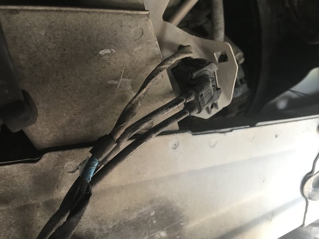

I have replaces 3 speed sensors when I got to the front passenger side the connector plug as 2 wires one is speed sensor the other is brake pad wear sensor. problem is, I can’t find the wire harness that has both wires connected to the same plug. Am I missing something?

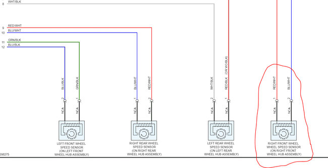

There isn't one plug for each. To the best of my knowledge, they are separate and the speed sensor connects at a small black box usually behind the strut assembly. I looked up the sensor wiring, and it shows it going to the control module.
Is that what you're asking?

I took a photo, one wire coming out of the black plug is the speed sensor wire the other is the brake pad wear wire, but I can’t find anything on the internet that looks like this.

What is on the opposite side of that plug? Is it the sensor?

One wire end hooks to the speed sensor the other wire end hooks to the brake ad wear sensor.

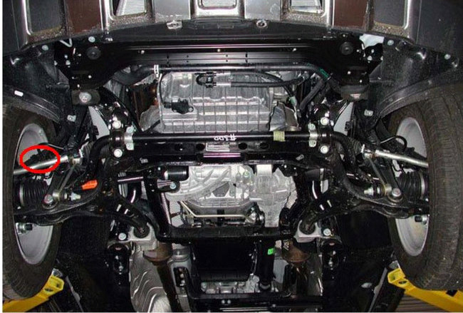

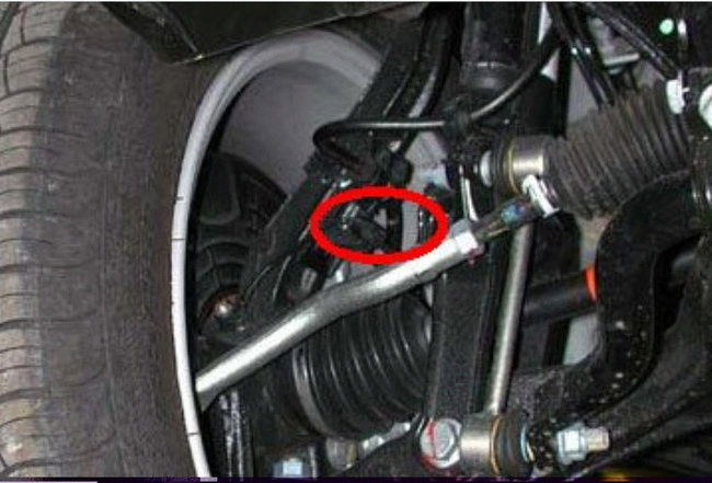

When you disconnected the original one, was it attached to the control arm assembly? Normally, they are attached and connected there. See the two pics I attached.
