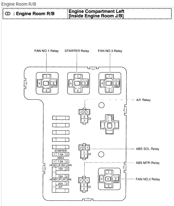

I was watching the video on cleaning the throttle body on my vehicle listed above and the technician was removing the ABS box off the cross bar. I noticed that mine was missing the box. Did all these vehicles have one placed there? Just wondering where mine was or how to find it, or if there was one at all. I really enjoy y'alls videos. I'm going to replace my valve covers soon.

It's very possible it never had one. 2002 ABS would have been an option. Does it show that is has ABS on the option list? Does it have the relays in the box under the hood on the left fender.

I did find it, mine is in a long fuse box on the driver's side, says fuse and relay. I have another question. I'm having a little rough idle at redlights now. It sounds like a low rumble, the exhaust is very erratic, and the idle rpm will drop to about 600 rpm. I noticed a puff of white smoke on start off only the other day. But it has not done it since. I hadn't cranked for several days, also. Do I need to completely remove the TB as in the video or can I get some TB cleaner and just clean the butterflies without removing the whole TB?
