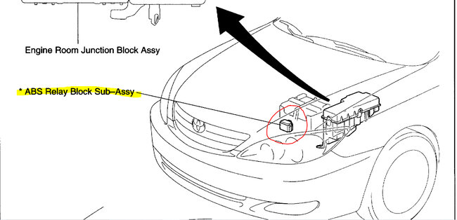

Ordered an ABS relay online but cannot find where it's located on my car. Googled thousand times they dance around every but either my vehicle or where fuses are located. I believe it may be in a separate small box around the battery. But it's not in the fuse box with the other fuses and relays. Keep in mind my mechanical knowledge of most of terminology used on a scale from 1-10 is about a 3.

You are correct. The ABS relay box is a sub-assembly in front of the battery. It is separate from the main relay box.
I attached a pic below showing its location. Take a look at it and let me know if you find it or if you have other questions.
See pic below.

Did you mean by front of battery between battery and headlight or other side either way I have battery out and don't see it.
Aug 6, 2023 at 1:33 AM

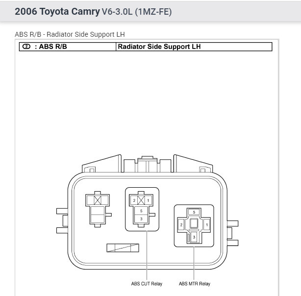

Joe, I've looked and looked I'm not sure that's the right diagram because I don't see anything that could possibly be it.
Aug 6, 2023 at 3:12 AM
  • 110,244 POSTS
Check along the radiator support on the driver's side. I was able to find a different picture that may help.
Also, this is for the 3.0L V6, correct?
See pic below.
