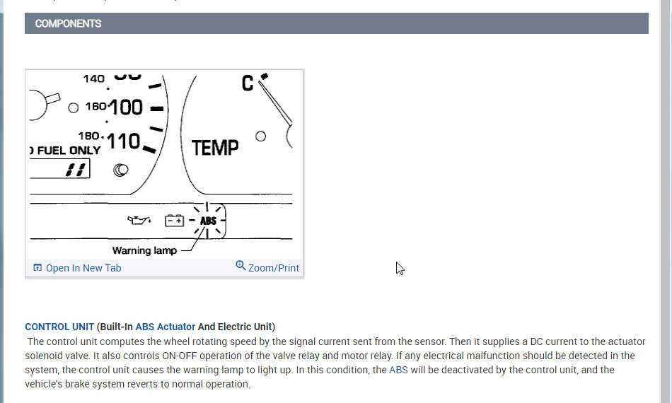

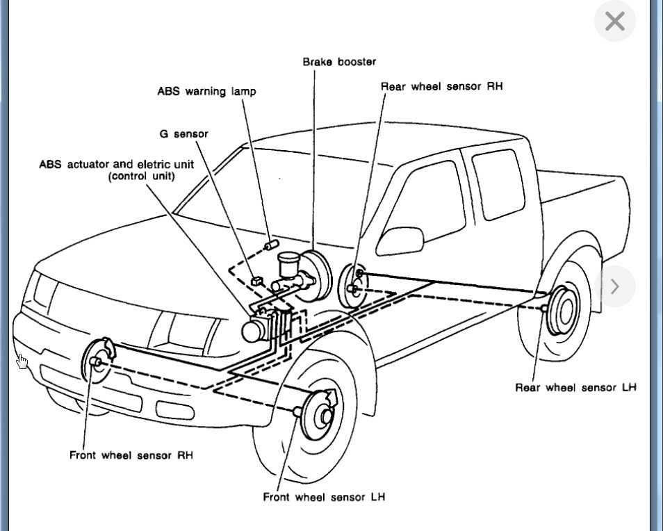

ABS light never goes off in dash cluster.A mechanic friend said the module is bad ,and does not kick on any more. If I can locate a "used unit in good working order" can this pump be replaced to get the ABS system to work as it should?As well as get that hideous light on the dash to go off. Thanks for your reply.
Apr 2, 2016 at 3:38 PM

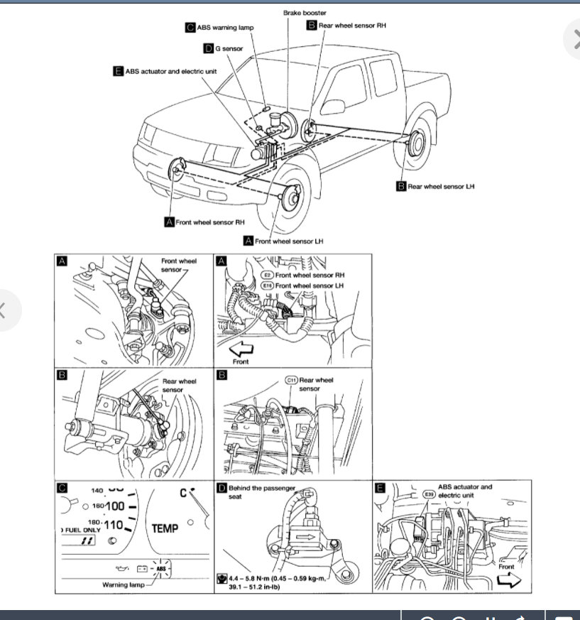

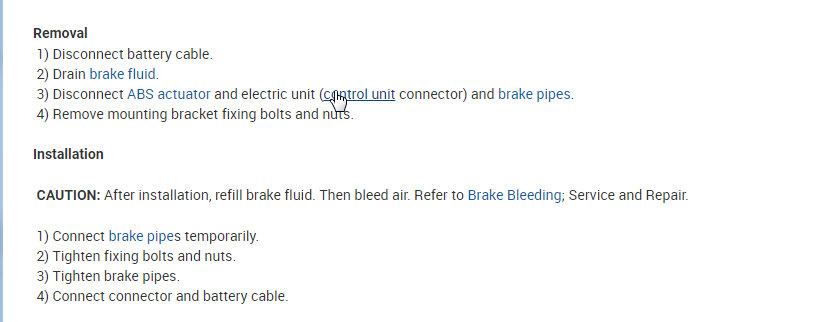

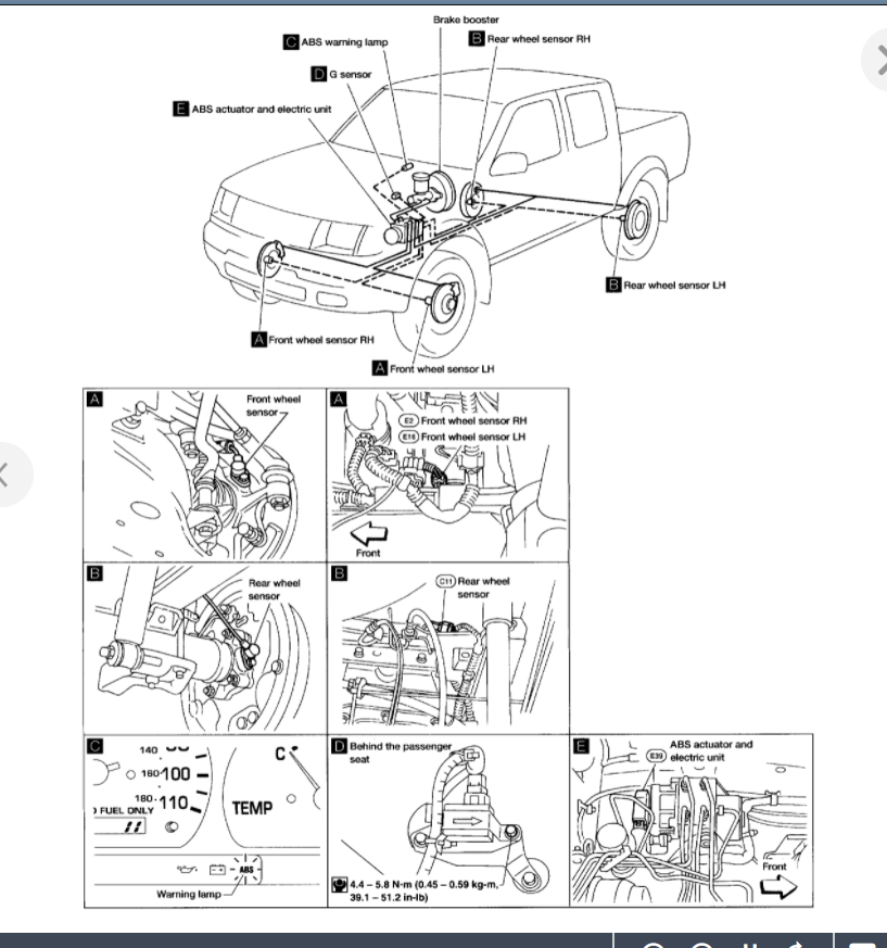

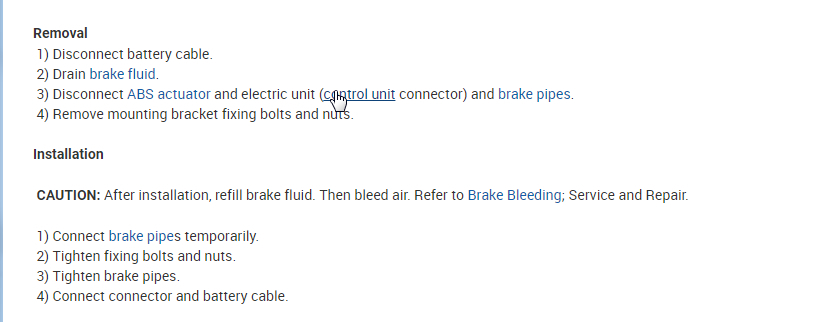

You can use a used pump for this so here is a guide that will help with this:
https://www.2carpros.com/articles/how-to-replace-a-abs-controller
Below is the process from the manual that will give more detail on how to replace this as well. Please run through this material and let us know if you have other questions. Thanks
