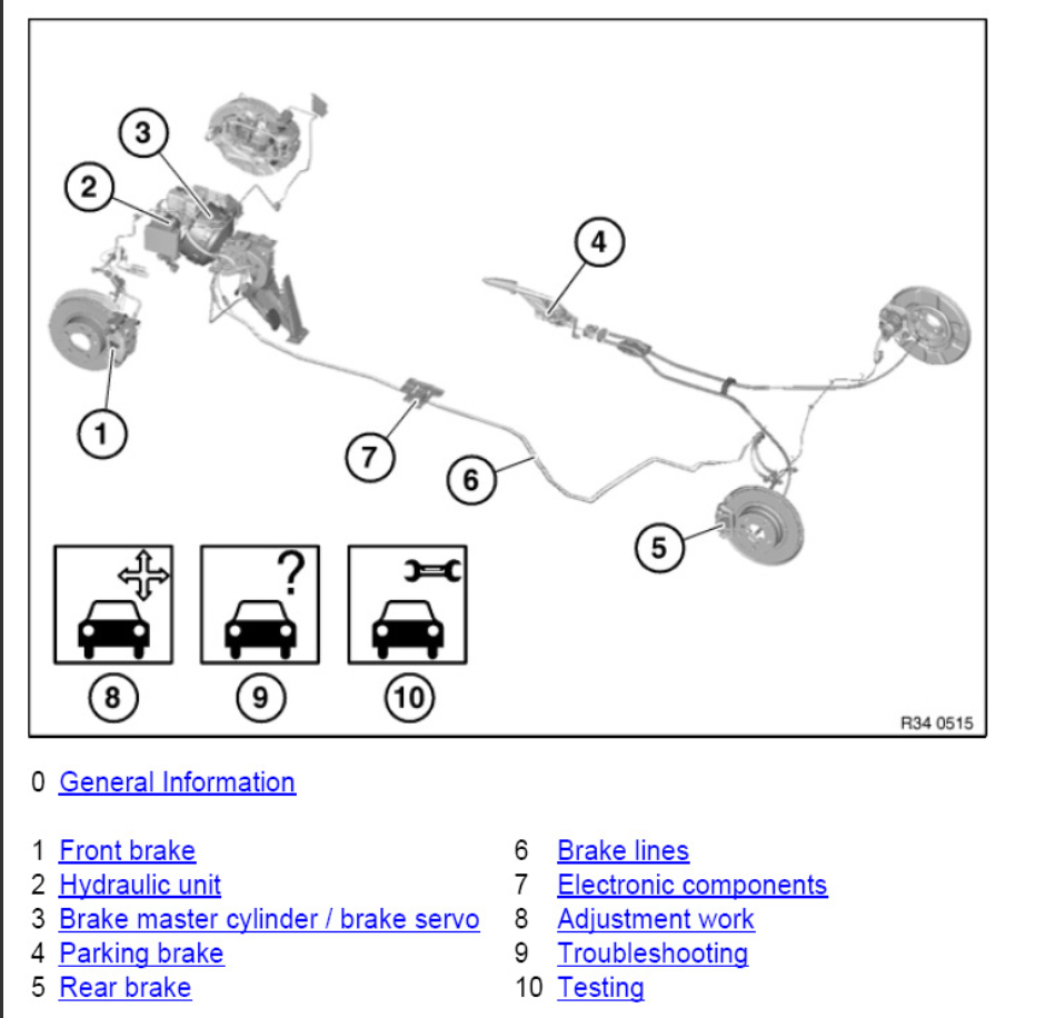

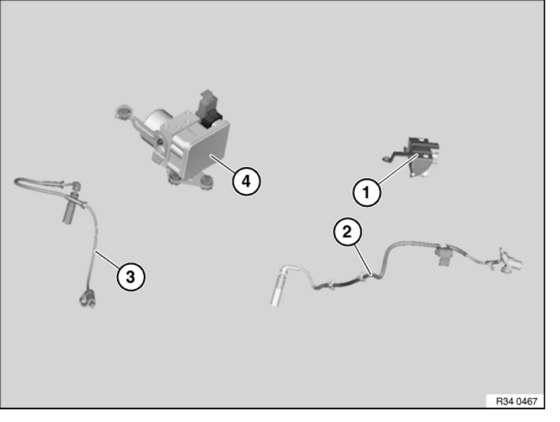

Getting DTC D370, D371,D372.
Nov 25, 2017 at 3:19 PM
  • 55,433 POSTS

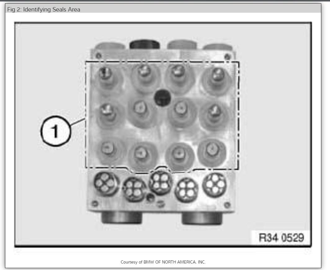

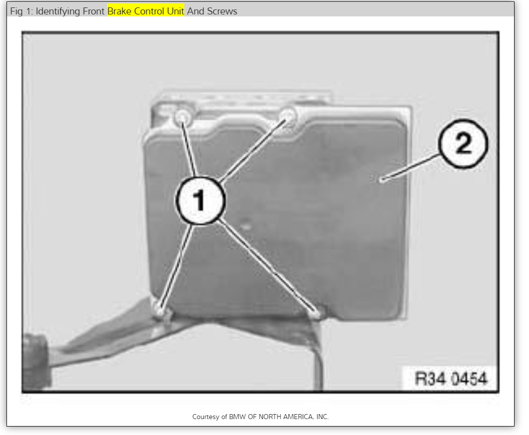

I have seen this problem before which means the ABS control module is probably bad. Here is a guide that will show you what you are in for when changing the unit out.
https://www.2carpros.com/articles/how-to-replace-a-abs-controller

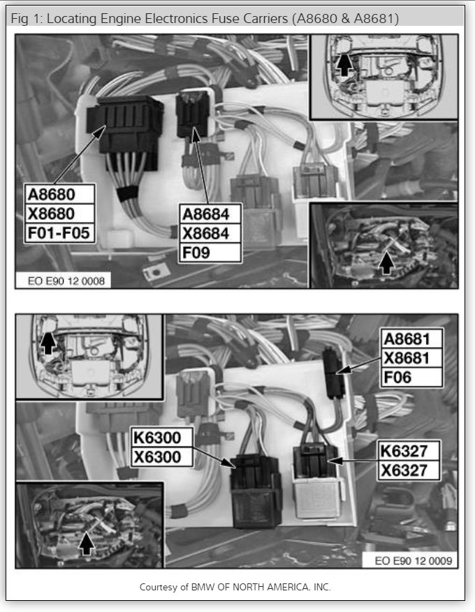

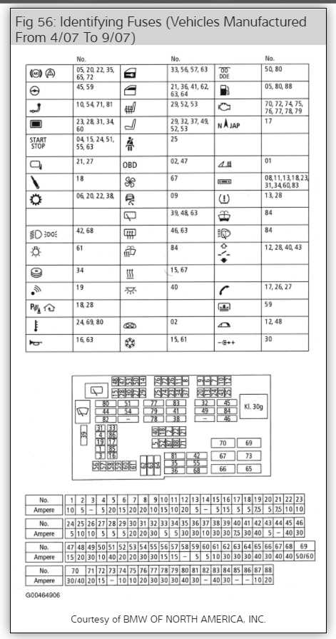

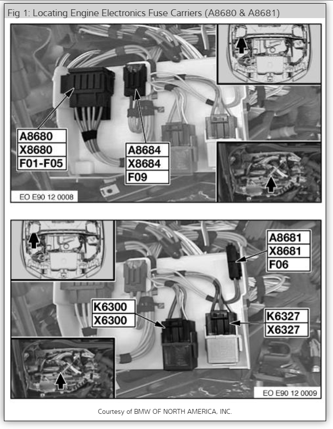

Check the fuses just to be safe
There is a fuse panel diagram (Below)
Replacement:
Carry out programming/encoding
