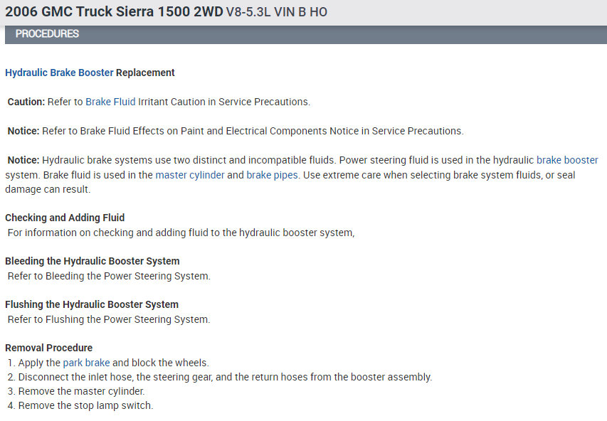

My brakes after couples of stops, the pedal gets stuck, first time i thought it was the calipers, but I replace it and still doing the same problem. i will like you to please help me change out the booster. thank you.

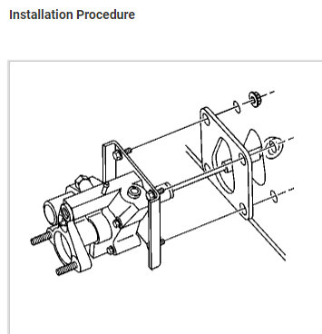

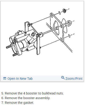

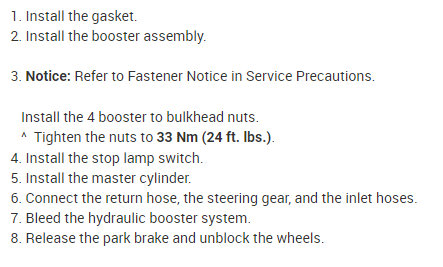

Here is the information you requested. Be sure to just move the brake master cylinder slightly out of the way so that you don't have to open a line and then have to bleed the brake system. I've attached picture steps below on how to change the power brake booster on your truck. Hope this helps and thanks for using 2CarPros.
