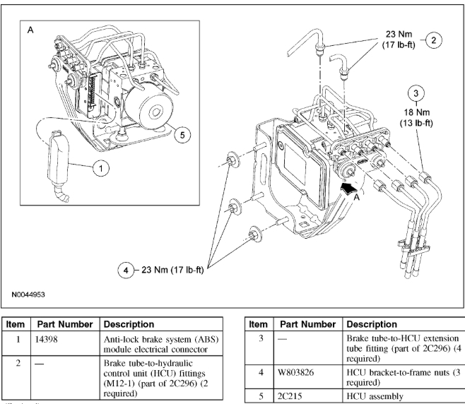

I recently purchased a used 2007 sport trac, upon trying to figure out the brakes I found the previous owner had cut all the brake lines off the abs, they are color coded but I cannot find anything to help me, there is a blue, red, white and green

There is no information telling us which line goes to what wheel sorry, all we have is this diagram. Check out the images (below). Let us know how it goes
