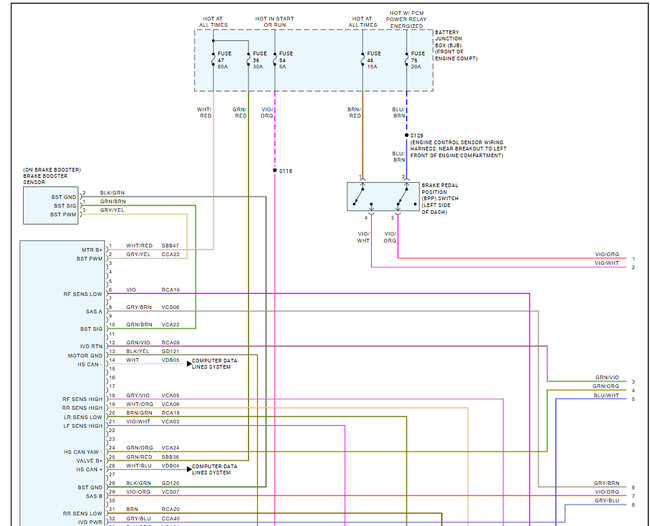

Getting a U0121 ABS no communication error code. I would like to check power and grounds at the ABS control module connector, and was looking for the connector pinout and wiring diagram.
Thanks!
Jun 28, 2026 at 5:54 AM
  • 55,721 POSTS

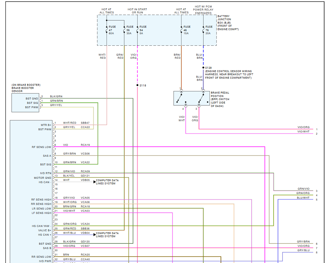

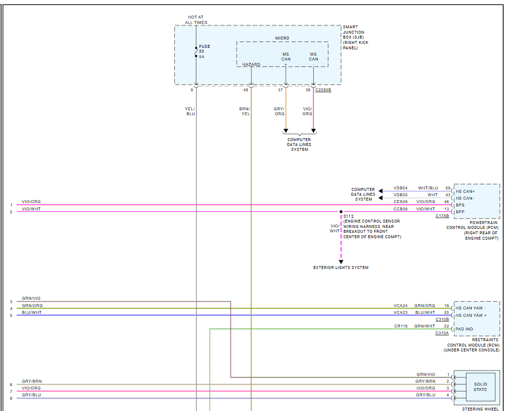

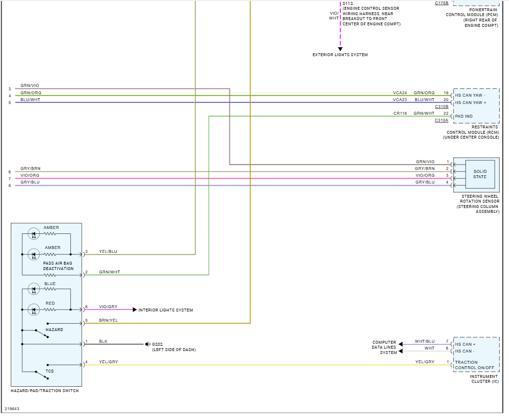

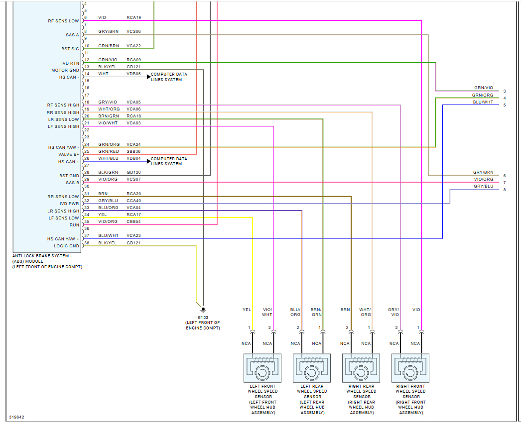

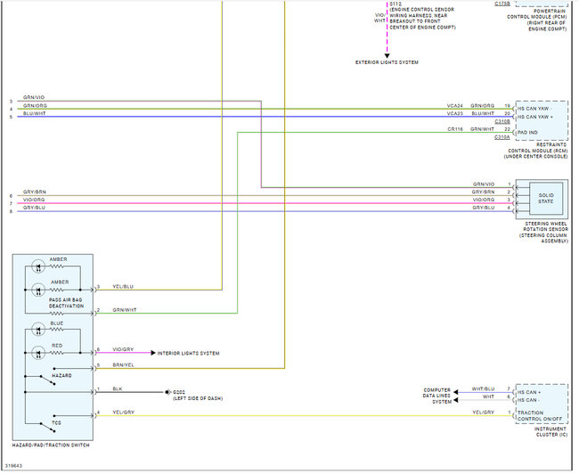

Hello, U0121 means the other modules are not able to communicate with the ABS module. This can be caused by a bad ABS module, but more commonly you want to check the basics first: power, ground, fuse feed, and CAN communication wiring. Here is the wiring diagrams and pin out so you can do the testing needed to see what is going on. Check out the images (below). Let me know what you find.
Jun 28, 2026 at 10:58 AM
ERICH PETERSON
  • 36 POSTS
Thanks so much. So, I checked all the powers and grounds and they all seemed fine. I reconnected the connector and the ABS lights went out! It appears to be the connector wasn't seating fully. Even when I insert it fully and press down on the lever, it still is able to come off. Not sure why this occuring.
Jun 28, 2026 at 4:35 PM
  • 55,721 POSTS
Yep, sounds like a bad connection, check the pins and wiring at the connector, if okay and the code comes back I would replace the ABS module.
