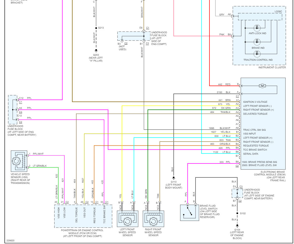

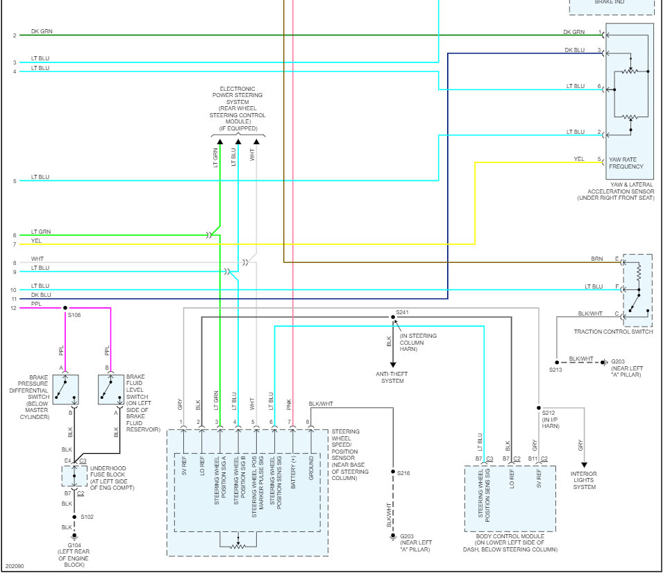

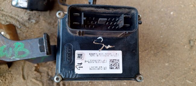

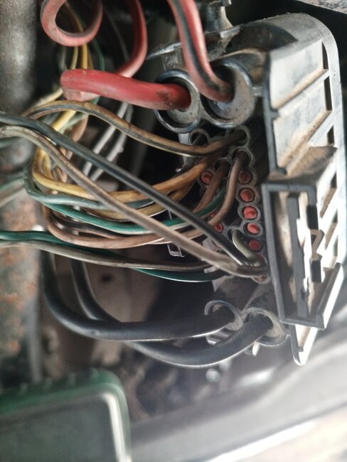

ABS has a lost communication with scanning tools. And the ABS malfunction light is on steady. And I think this is the reason why the transmission is not changing while driving.
May 28, 2023 at 10:25 PM
  • 55,721 POSTS

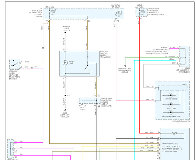

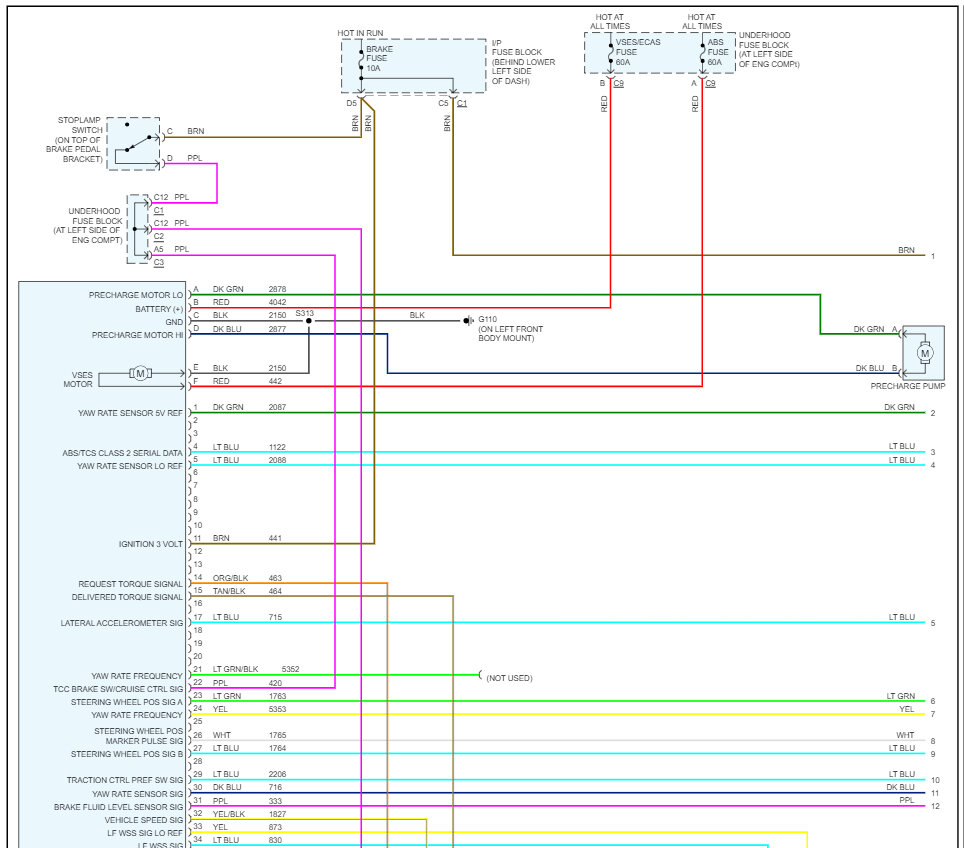

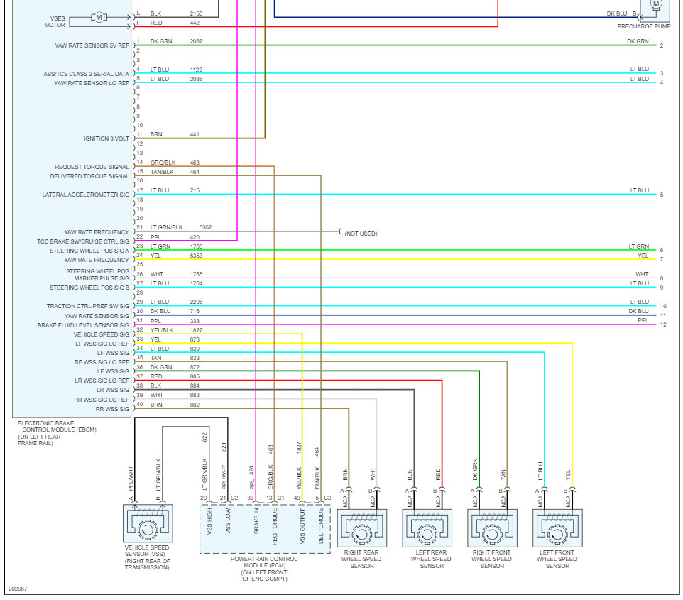

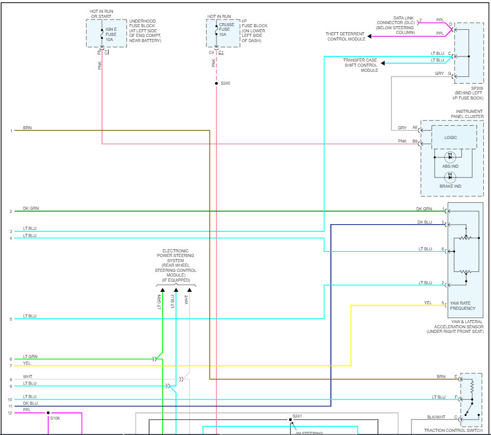

Here is a guide and the ABS wiring diagrams as requested with a guide to help you check the power and grounds before you replace the module:
May 30, 2023 at 4:41 AM
TBABST
Please check, this pinout socket for my ABS. The wires are differ in color in the diagram you sent.
Jul 10, 2023 at 11:31 PM
  • 55,721 POSTS
You say 4-liter engine but there is no engine of that size. Can you tell me if you have a 5.3? I found these ABS wiring diagrams I think they are the ones you need.
