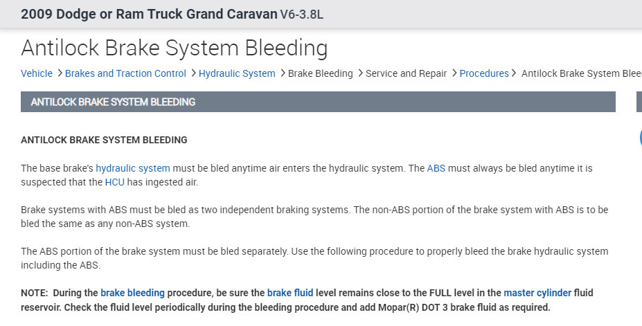

I have an ABS module that I tried to have rebuilt but was told it’s unrepairable because of software issues. I found a used one from the exact same car and wanted to know if swapping it out will still allow the breaks to function. 2009 dodge grand caravan. I understand there will be a VIN mismatch so the ABS will not be functional but if everything else is working it should be able to get me from point a to be until Dodge gets a new one or I arrange to purchase a new vehicle. Thanks in advance.

If the module isn't working, you should still have brakes. Could you explain what is happening?

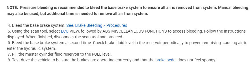

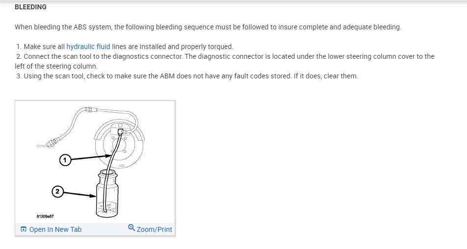

As far as a VIN mismatch is concerned, I'm not sure that is a concern. However, when the module is replaced, you need to do an automated bleed which requires communication with the module. However, it should work.
I attached pics below showing the procedure.
