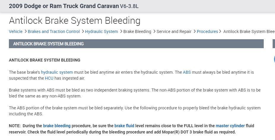

If the module isn't working, you should still have brakes. Could you explain what is happening?

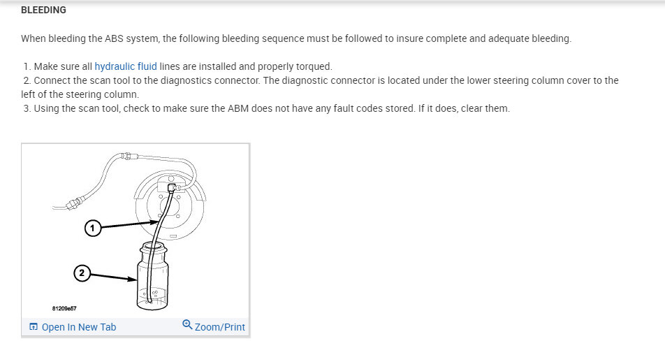

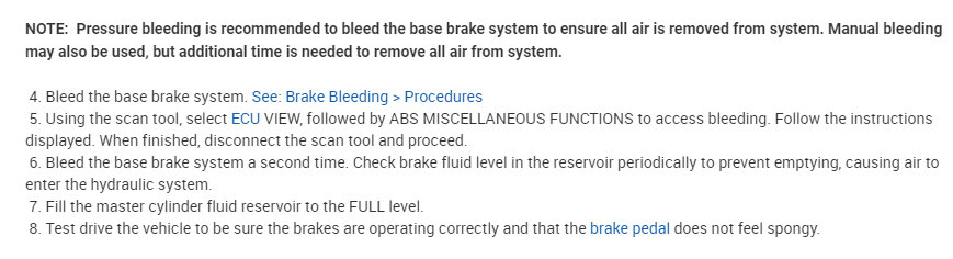

As far as a VIN mismatch is concerned, I'm not sure that is a concern. However, when the module is replaced, you need to do an automated bleed which requires communication with the module. However, it should work.
I attached pics below showing the procedure.

That is correct. Once installed and bled, if you can't program the module to function, you should still have non-ABS brakes.
Have you checked online for a remanufactured one? There are a lot of sites that sell them. They program them to your VIN and when you get them, they are plug-and-play.
