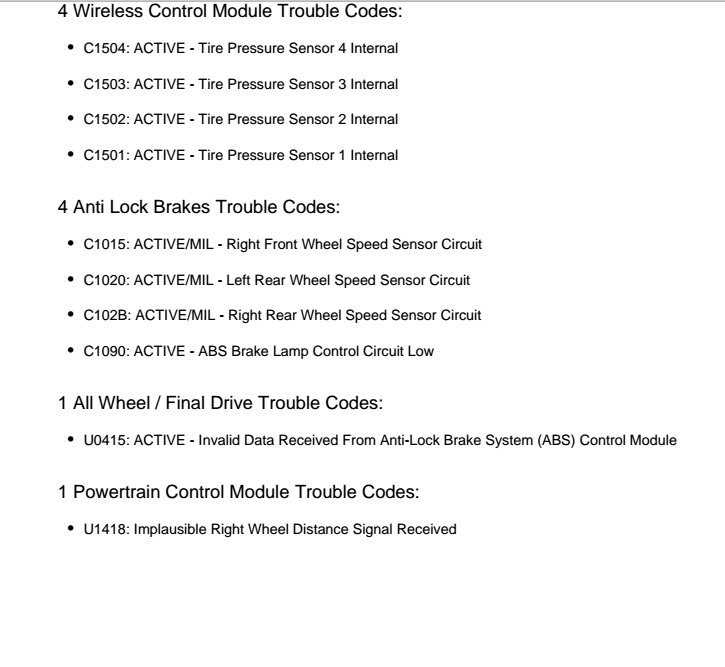

I need some advice here with an ongoing ABS issue. Quick background, ABS, ESP/BAS, brake lights on dash showed up randomly (vehicle gets driven once every few weeks and had been parked, no recent mods or anything). Checking codes, wheel speed sensors and a few other things were showing. Anyway, all four sensors changed and even a new ABS module, no change at all in codes.
I have Bluedriver to read codes, but whenever I try to clear them they will never go away, not even for a moment. Ignore the TPMS codes, I disabled those with my tuner. Sometimes all four wheels speed sensors show fault, sometimes three of four.

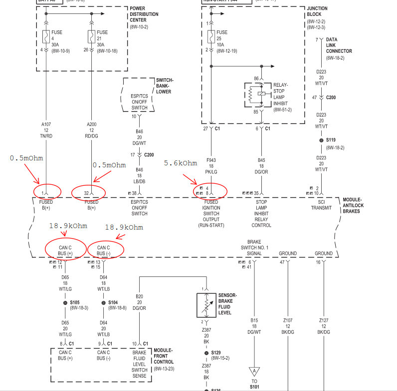

I have got the negative battery cable disconnected, and the main plug at the ABS module disconnected.
I put one lead on ground (body and negative cable showed same results) and checked the pins on the ABS module plug. Here is what I found.
Pins 1 and 32 are constant power, and showed 0.5mOhms to ground. Pin 8 is key on power, and showed 5.6kOhm to ground. Pins 12 & 13 are my canbus and showed 18.9kohm to ground. All other pins were OL which I expected.
Ground pins to actual ground are perfect at 0.2.
So, are those values too low to be concerned with, or is anything other than infinite a problem? I should know this as my full time job deals with similar stuff but I am having a brain fart.
Also, if those values appear good, then any other suggestions? I thought maybe a clock spring, but in this generation of jeep you would usually see steering angle codes and steering wheel centering codes as well.

tuner? a lot of times those are the trouble. if you have one that stays constantly in aldl then unplug it for a while and see if it clears. but what your codes have I think may be an can/bus problem with the U codes. Or maybe a tpim module. looks like the PCM and ABS are not talking to each other like they should.

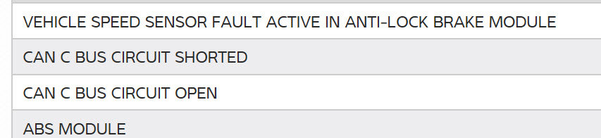

I looked up the codes to see if was what I suspected and it is the one deals with abs and final drive module and other deals with what I have posted in pic which relates to abs or a bad abs/pcm. If you can track down bus problems that may fix it. but for bus problems it 's better to have a pro look at it for a short/open
