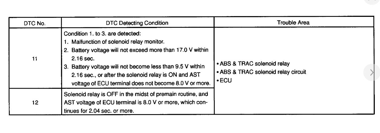

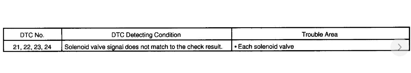

Okay, I attached possibilities for the 2 codes. 12 is the one I am concerned about. It s for the ABS relay which provides power to the solenoids inside the ABS unit.
It looks like they shot from the hip with this one. I think more diagnostics need to be done to be sure the module is actually bad.

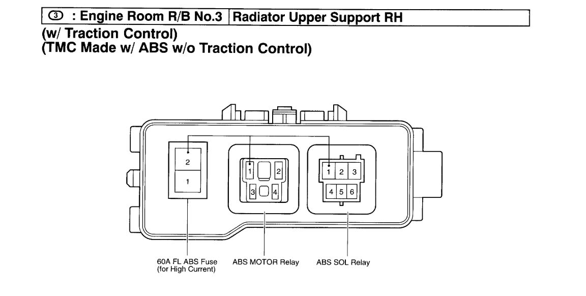

I should have mentioned this before: I don't have the traction control type of ABS system. It is strictly the anti-lock braking type without trac control. Sorry. But I agree that more diagnostics should be done before changing the module. In fact, given the need to program any new/used module (flash) I am dependent on a garage with the equipment and the skill.
