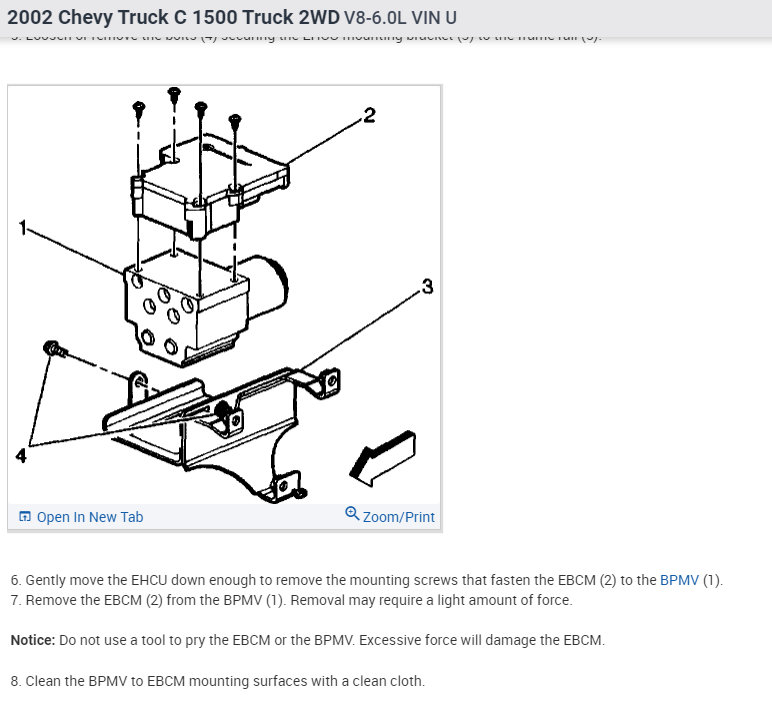

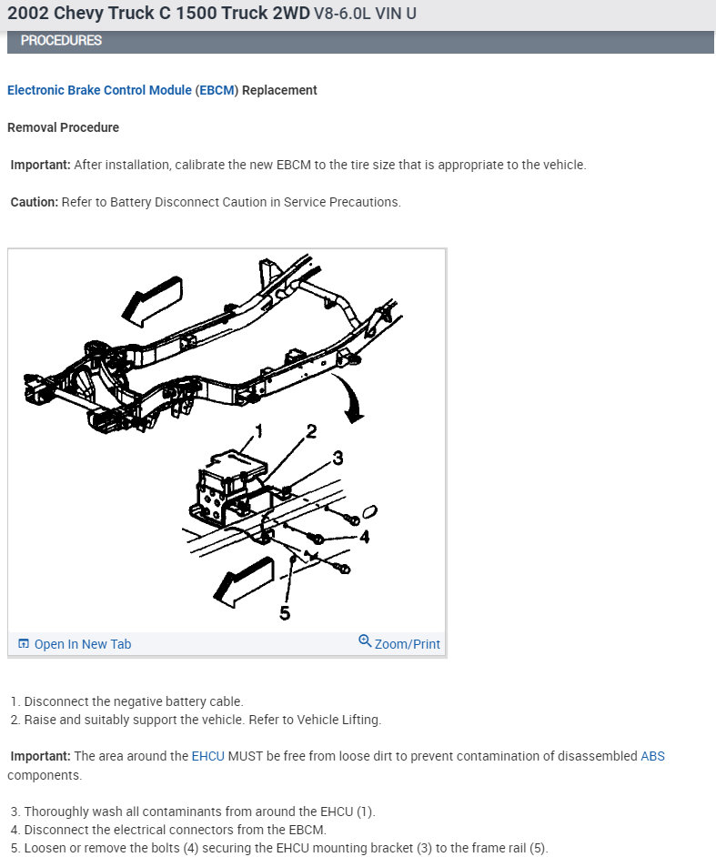

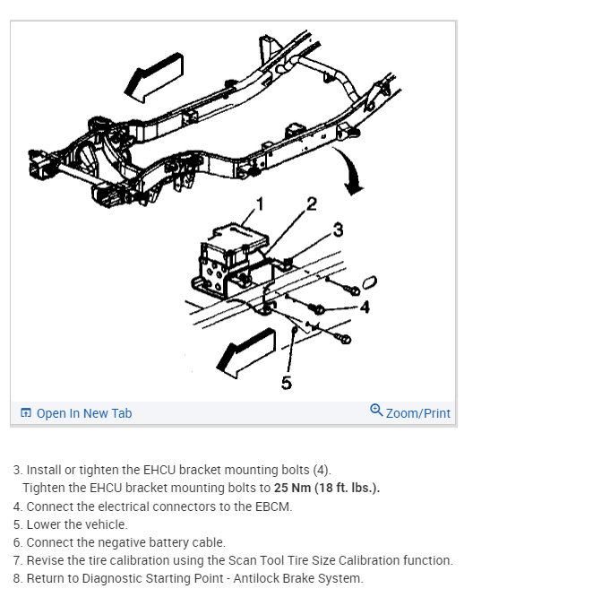

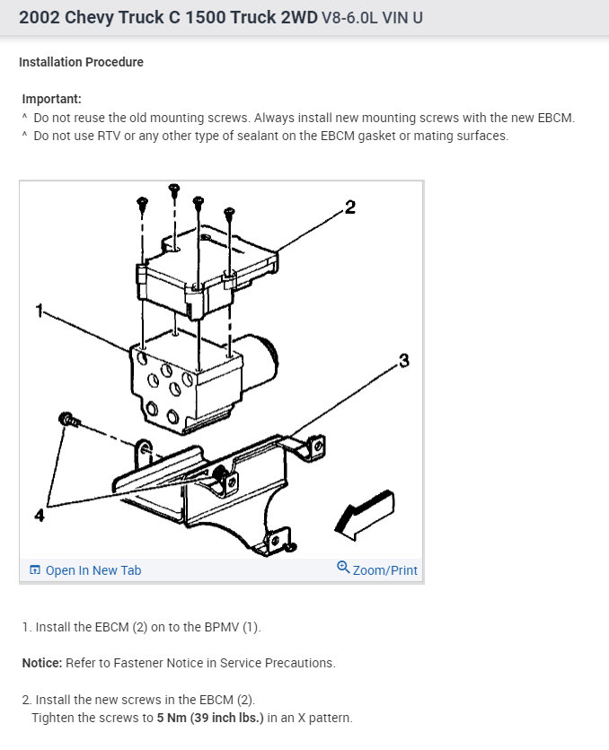

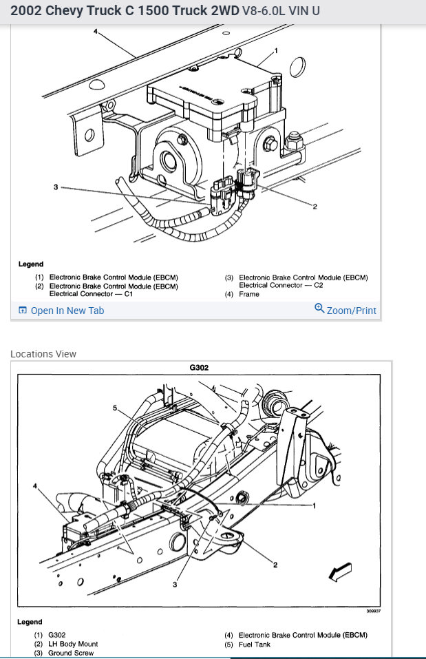

Yes, the module needs to be calibrated after the installation using an appropriate scan tool.
Here is a helpful guide:
https://www.2carpros.com/articles/how-to-replace-a-abs-controller
I have attached the replacement procedure below.
Let me know of any questions.
