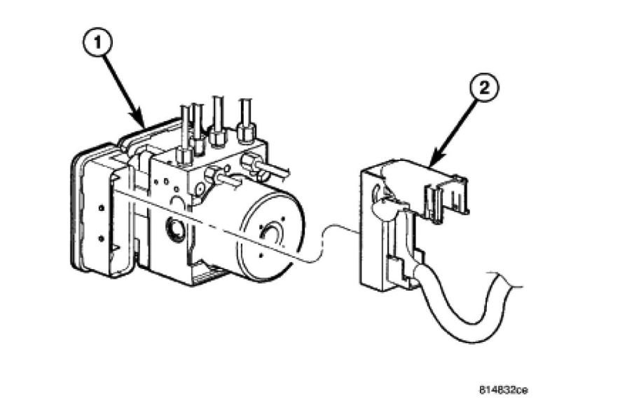

If I change out the ABS control module myself does it need to be programmed or will it work okay by me just changing the module? The computer code read out said “ control module inner failure”. I can change out the module myself if that is all that is needed.
Aug 15, 2018 at 12:15 AM
Good afternoon.
Below is the procedure for removing.
Yes, you can do it yourself. It does not have to be flashed.

NOTE: Use this figure in the following step to release the ABM harness connector cover. It shows the location of the release tabs.
imageZoom/Print
3. Disconnect the ABM harness connector from the Antilock Brake Module (ABM). To do so:
a. Depress the tabs on each side of the connector cover, then
b. Pull outward and upward on the lower half of the cover until it locks into position pointing straight outward (2). The connector can then be pulled straight outward off the ABM (1).

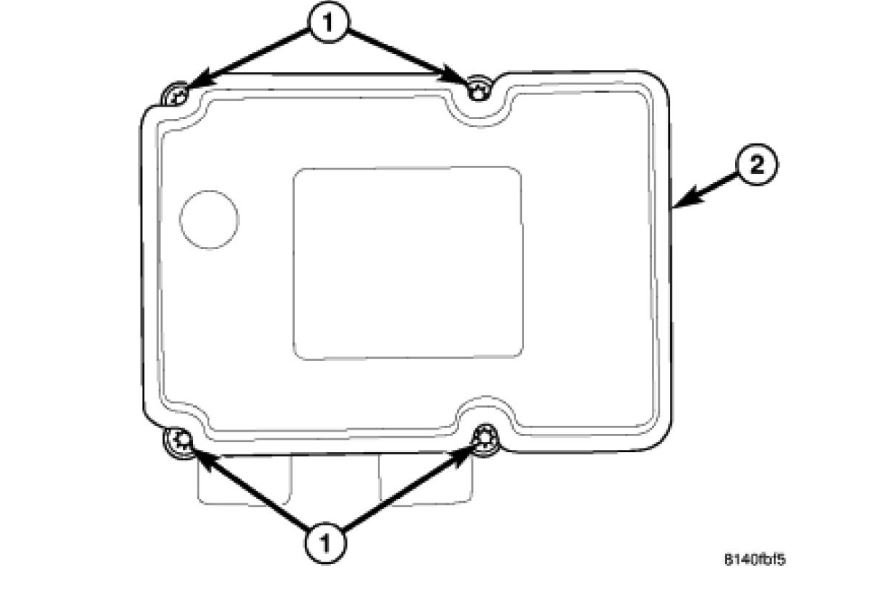

4. Remove the four screws (1) attaching the ABM (2) to the HCU.

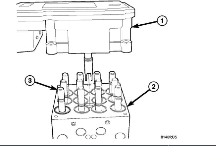

5. Separate the ABM (1) from the HCU (2).
8. Hook up the scan tool to initialize the ABM and perform the following:
a. Clear any faults.
b. Perform the ABS Verification Test and road test the vehicle.See: A L L Diagnostic Trouble Codes ( DTC ) > Verification Tests > ABS Verification Test

I do not have a scan tool. Does the control module have to be initialized?
Mar 15, 2021 at 5:56 AM
No, it just says to clear any codes.
Worse case scenario is you may have to take it to a shop and have them clear out any codes after you replace it.
