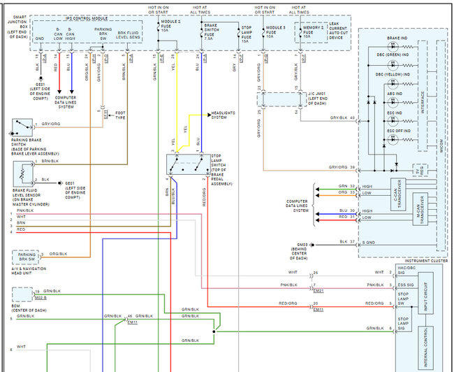

Please can you provide me with the ABS pinout signals and Diagram?
The wiring Diagram for the ABM unit module pump below I have attached the model for the exact ABS module.
Thank you!
Aug 29, 2025 at 10:17 PM
  • 55,859 POSTS

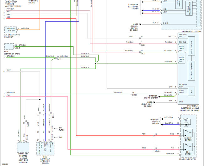

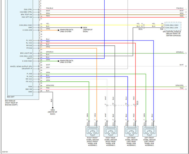

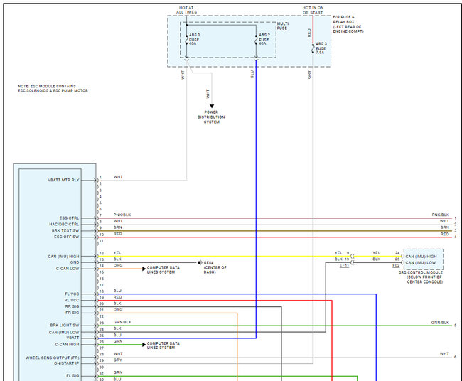

We dont have the pin outs but do have the ABS wiring daigrams so you can see how it works and which wires to test. Check out the images (below). Let us know how it goes.
