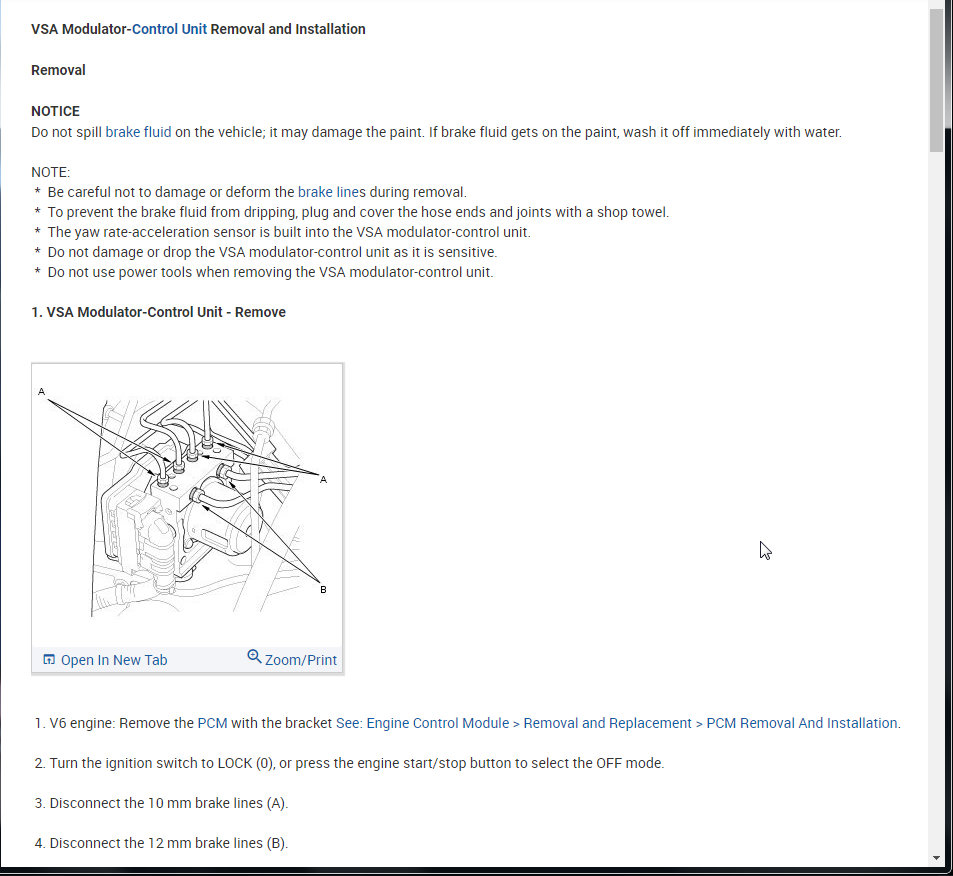

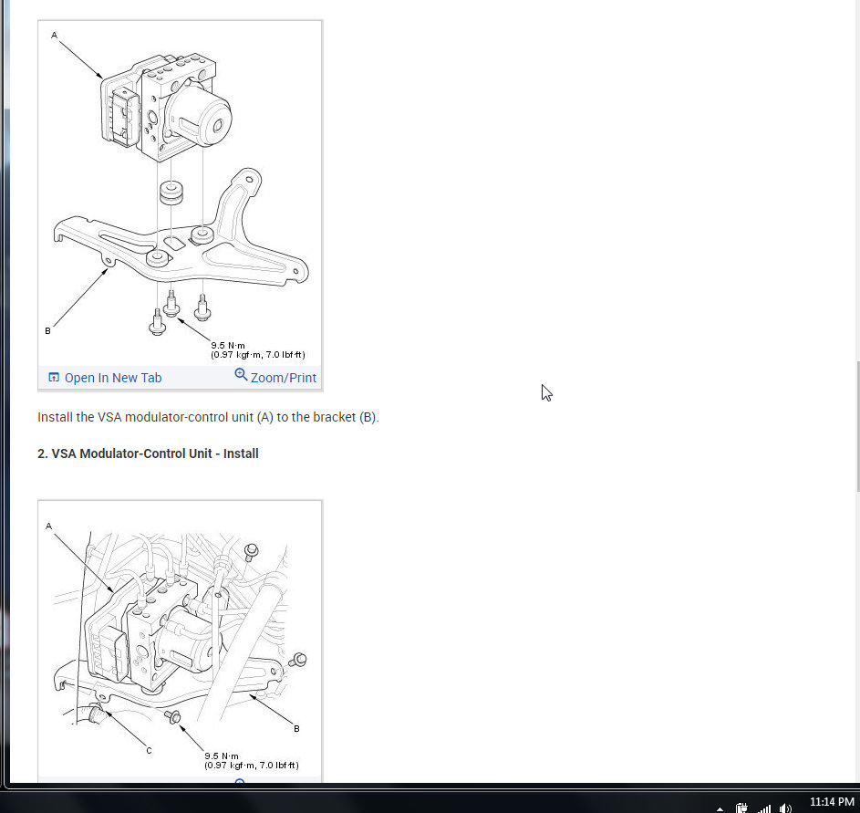

One week ago changed the ball joints then one week later four warning lights came on; ABS, tire pressure and two more lights stayed on. So we need to replaced the ABS module.
Friday, August 14th, 2020 AT 12:47 PM

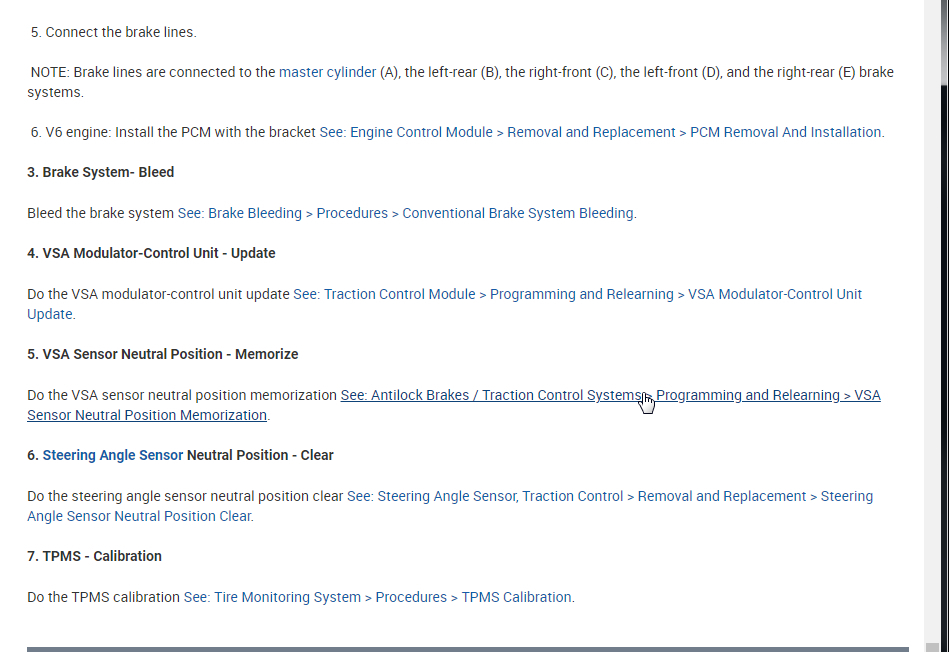

Here is a guide that will help with this:
https://www.2carpros.com/articles/how-to-replace-a-abs-controller

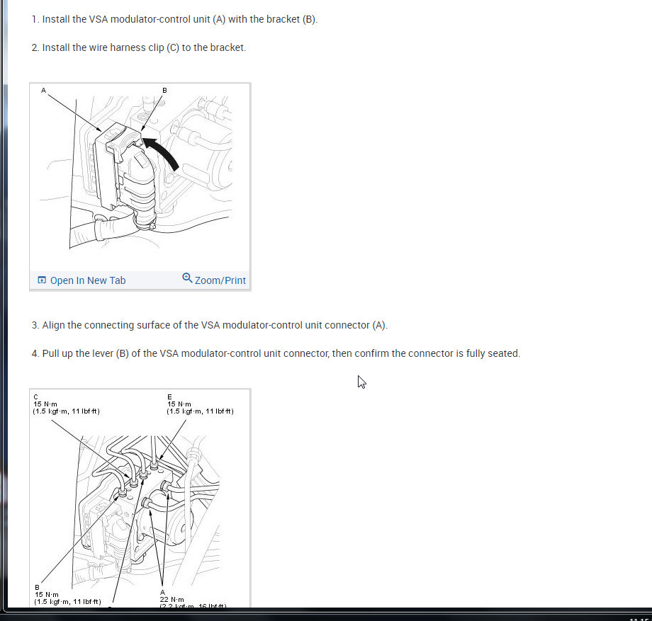

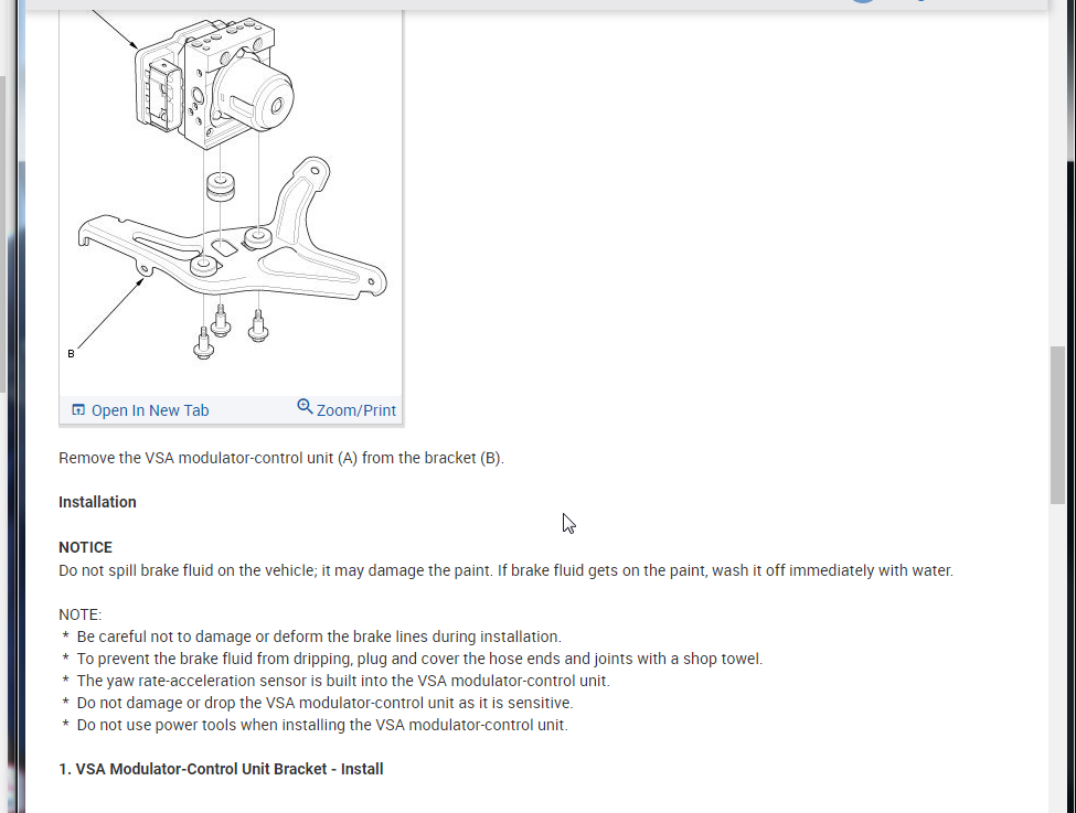

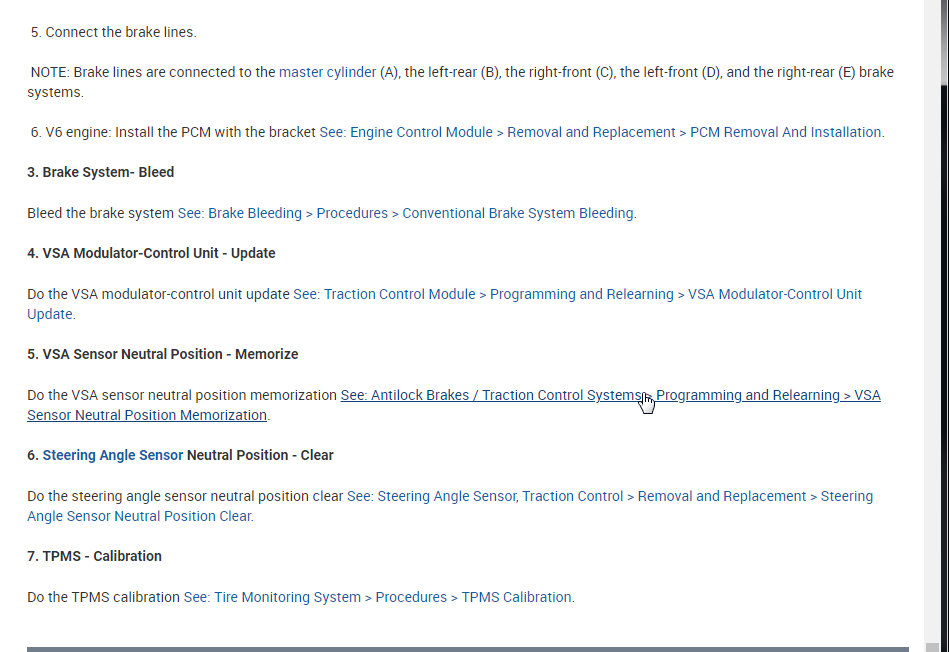

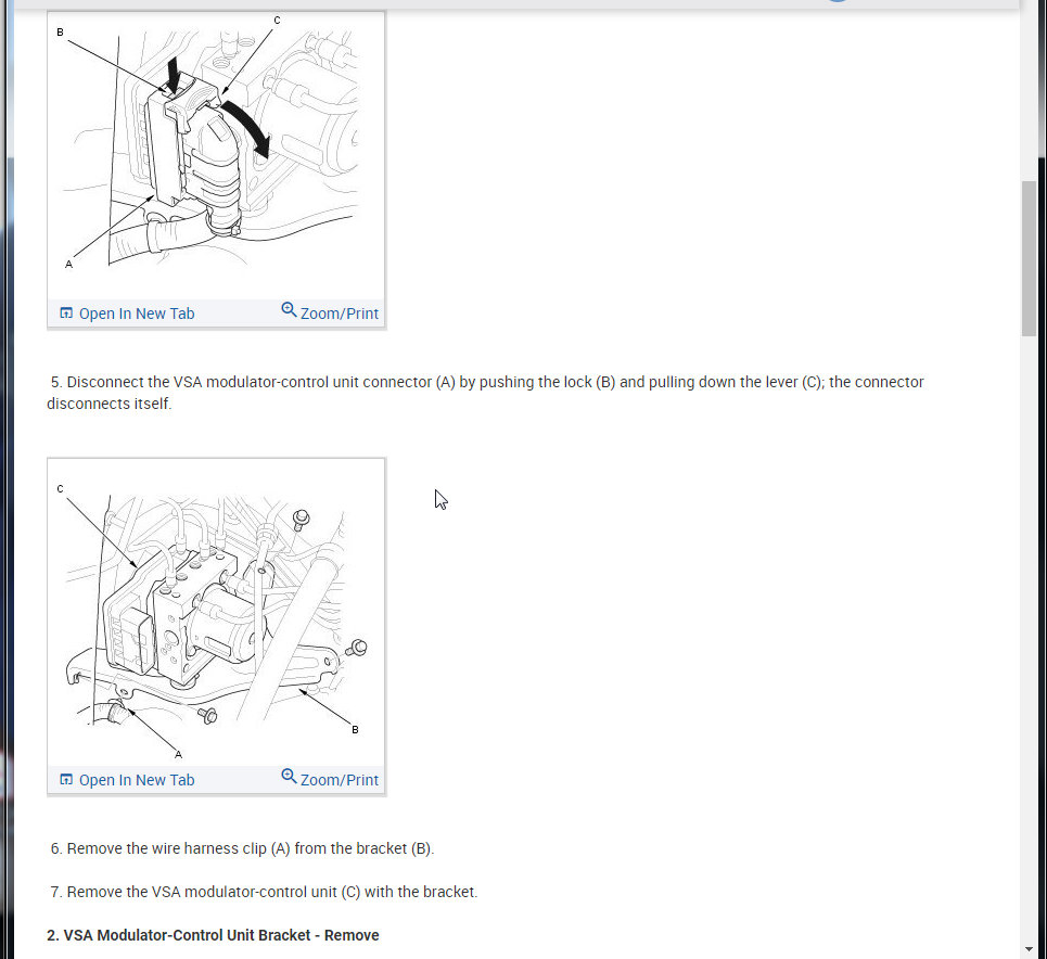

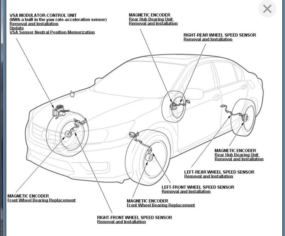

Below is the process from the manual on how to replace the VSA module. Please run through this material and let us know if you have other questions. Thanks
