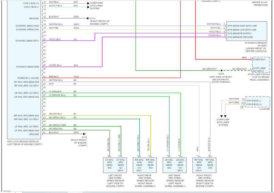

Hello! I have many lights illuminated on the dash such as ABS, ESP BAS, traction, hand brake.
I would like to start diagnosing the problem by checking inputs and outputs on the ABS module but i don’t have a wiring diagram. I could only find ECM diagram.
Let me know how you would tackle such a problem.
Thank you

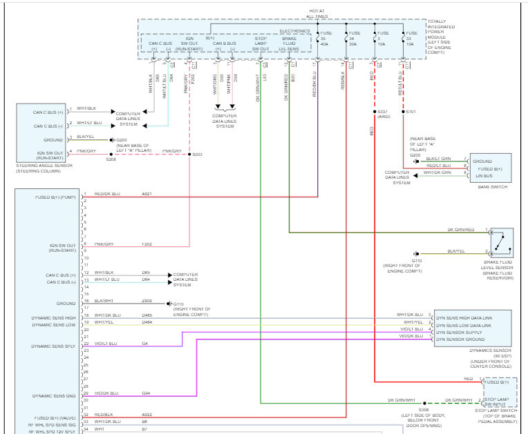

Chances are the problem is related to a faulty wheel speed sensor and not the module. Even low brake fluid can set all these codes.
Before we dive into a control module, check for a signal at each wheel speed sensor. Here is a link that explains how it's done. All you will need is a voltmeter or multimeter.
https://www.2carpros.com/articles/abs-wheel-speed-sensor-test
I have attached the wiring schematic below for the ABS circuits. I hope they help.
Let me know what you find.
