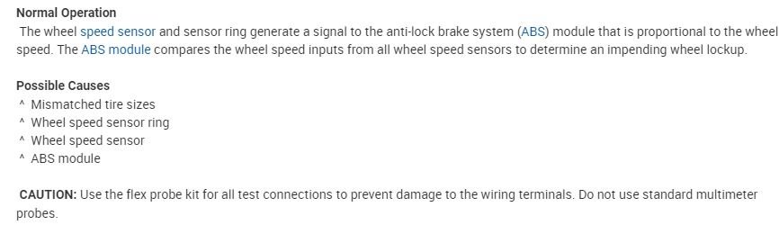

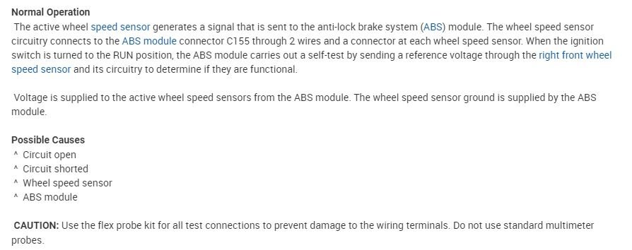

The brakes locking up is different. You need to check all the wheels for pads, rotors and calipers. Make sure no wheel is sticking from worn or bad parts.

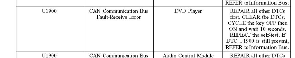

The 1900 code is for the DVD player.

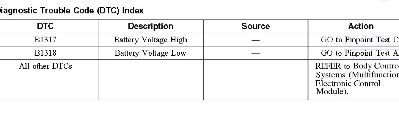

The 1318 is for the charging system. This could be a bad alternator, wiring or a failed PCM.

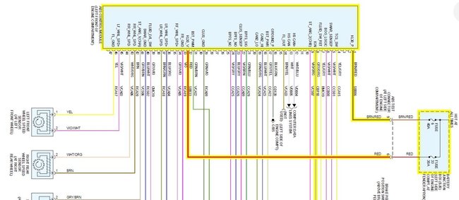

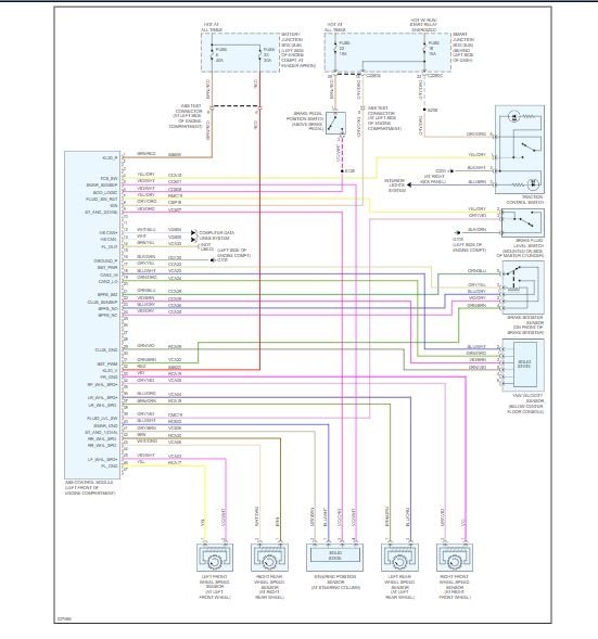

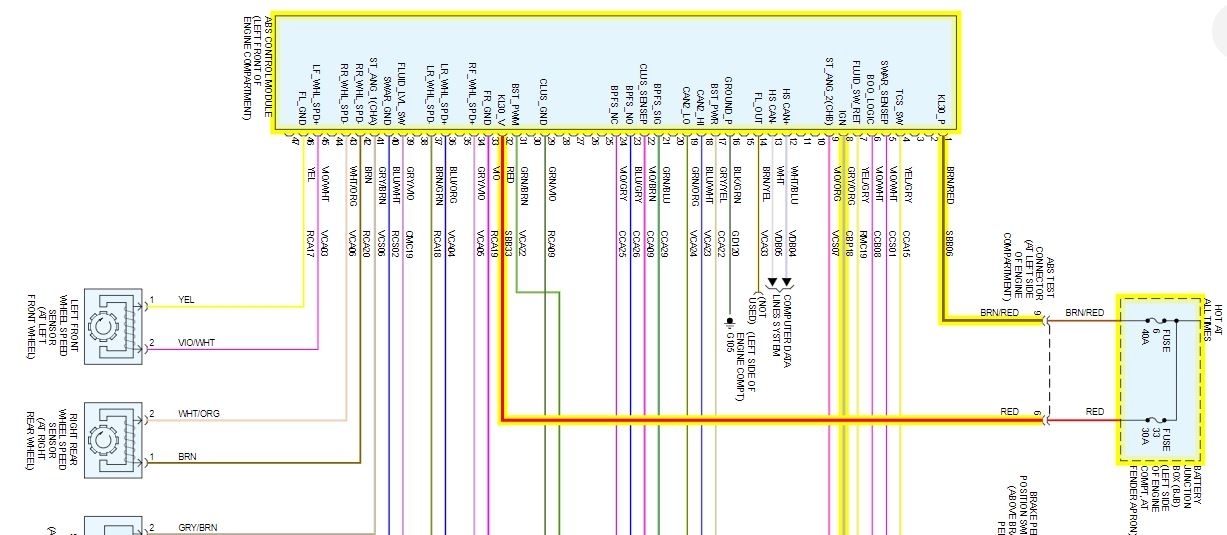

1676 is for low battery voltage to the ABS. Check all the fuses with a test light with the key on and verify voltage on both sides of the fuse. This is not a visual test, it is a voltage test.
